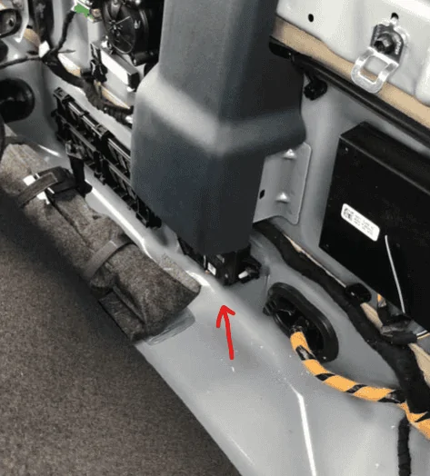

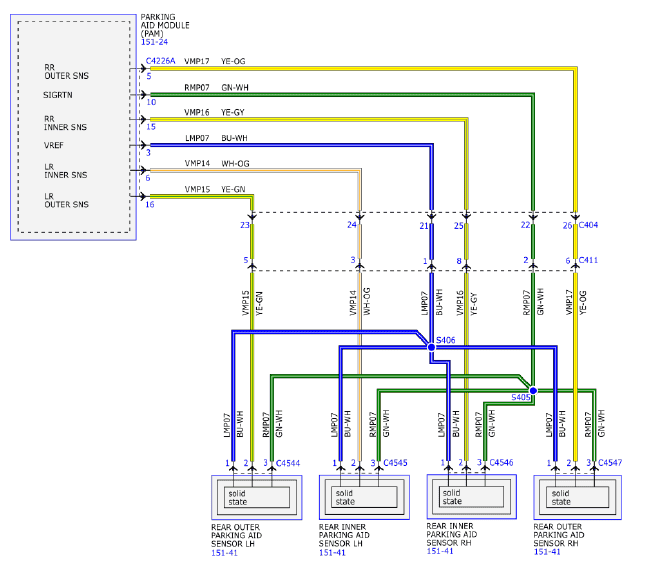

The 4 reverse sensors have 6 wires going to the Parking Assist Module (PAM) which is mounted on the rear wall looks like near the center seatbelt retractor. This fella, I think?

That has 4 wires of its own: power from the BCM, ground, and HS2 Can +/-
Uses connector WPT-1447 (same style as the forward camera).
