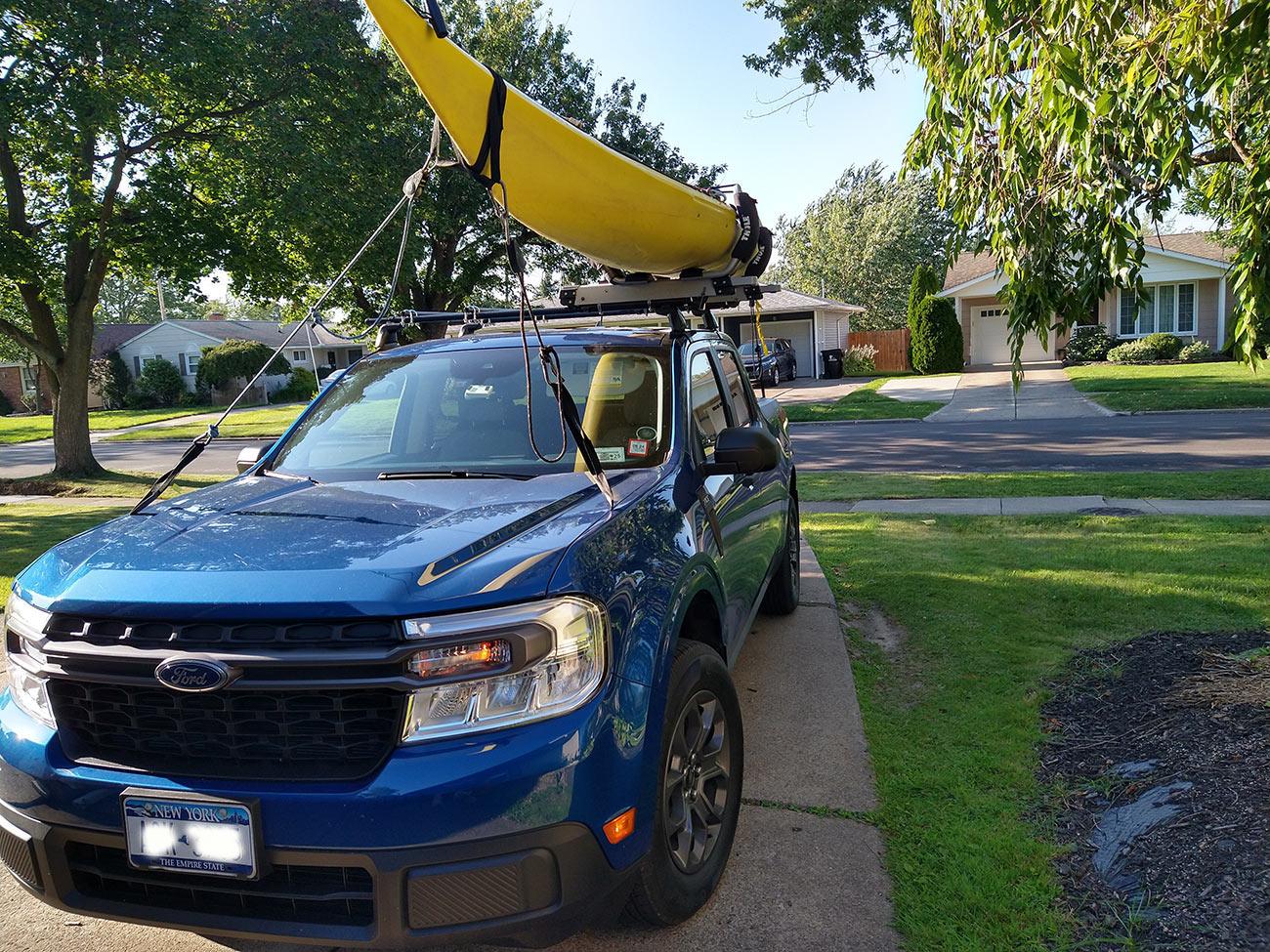

I am only on third tank but its been pretty close to right for me. Maybe its because I have a big kayak on the roof its more accurate?

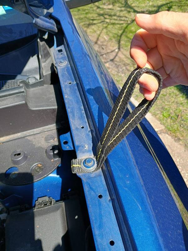

Re. Those straps under the hood. Did you just put them on that existing fender screw? I have some ready to install but I was wondering about the strength. No issues? I have a hitch mounted
'T' bar setup so I can leave the bed cover on.
Yes just used a bolt under the hood but added a large washer to it.

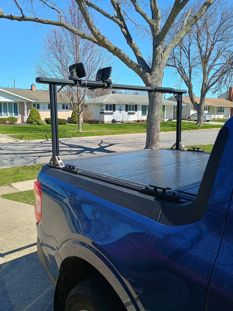

Ford Maverick Calibrated MPG display xstra
BUT that was a while ago Now also added a read cross bar.
Ford Maverick Calibrated MPG display xbar
Thanks, that's exactly what I was going to do with a fender washer. That anodized 80/20 looks nice.
