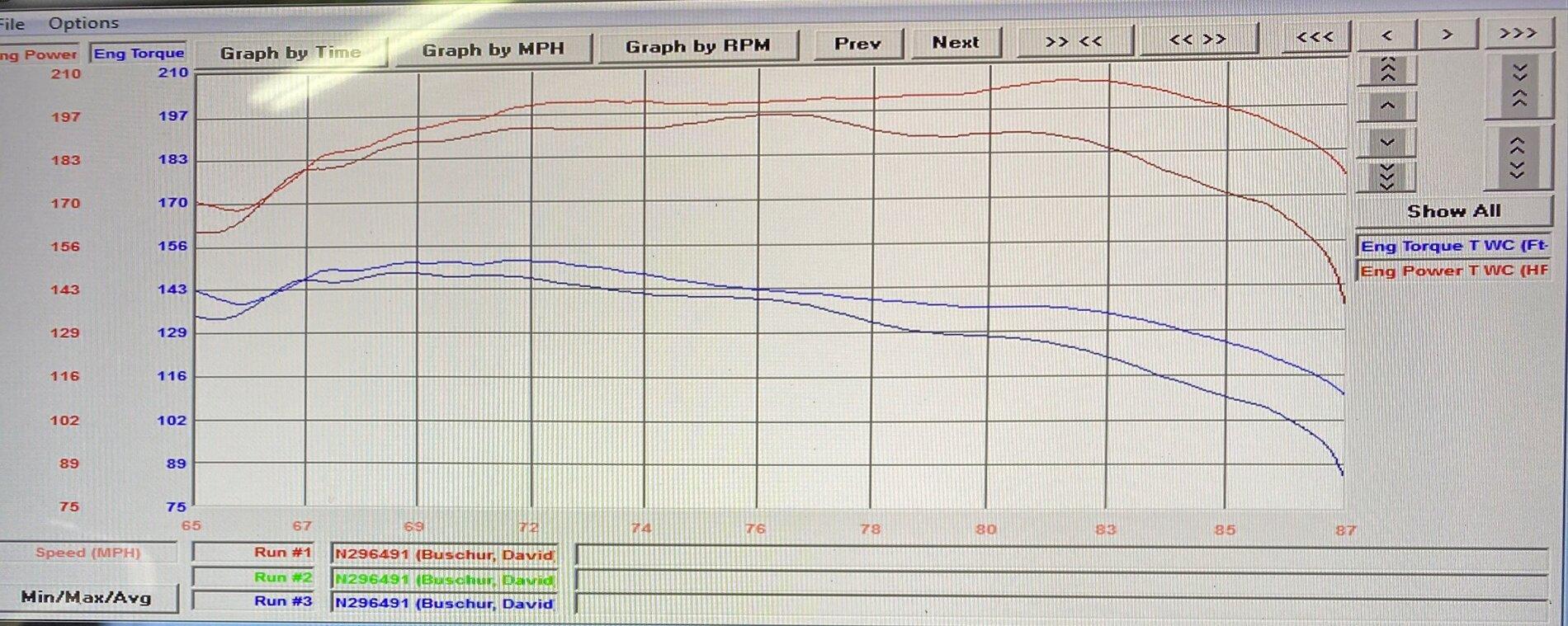

I'm trying to figure the engine RPM for the dyno runs provided above. My best guess is the traces were taken in 5th gear on a Maverick with the 4k tow package (i.e., 3.81 final drive ratio). In this scenario the peak power for the base run occurs at about 5100 RPM and the peak with your CAI occurred at about 5500 RPM. Ford specs indicate peak power for the 2.0 EB occurs at 5500 RPM. Can someone explain why power starts falling off early in the base run which then leads to significsnt gains with the CIA at the expected 5500 RPM peak?

The graphs from the original testing were done running the truck 1st-4th gear from a dead stop to about 90 mph in 4th.
The power falls off, mostly from an extremely rich AFR.

My truck has too few miles to be thrashed, so i have to rely on my calcylator. With stock tires my Lariat (3.81 rear end) is calculated to hit about 74 mph in 4th gear at the 6500 RPM readline. With the standard 3.63 gears in a non-4k rear end one would almost make it to 78 mph. Did you run over-sized tires or some how go far beyond redline (not to mention the advertized peak power RPM) to get to 90 in 4th?

ShowING The run vs RPM rather than speed would go a long way in clarifying things.

When we built this we were way ahead of the game and no tuning was out, so there was no way to dyno the truck in one gear or by RPM. Now we can lock the truck in any gear and dyno a full sweep in that gear. The product is out, tested, proven, has had outstanding reviews from every single person who has bought and installed it, I'd guess there are close to 100 out there at this point.
