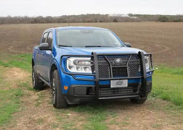

looks exactly like what I have on my F150. Perhaps a little overkill with the maverick but considering that deer season is starting and two truck on the farm have already hit bucks this year, maybe overkill is not the worst idea to keeping the maverick safe.

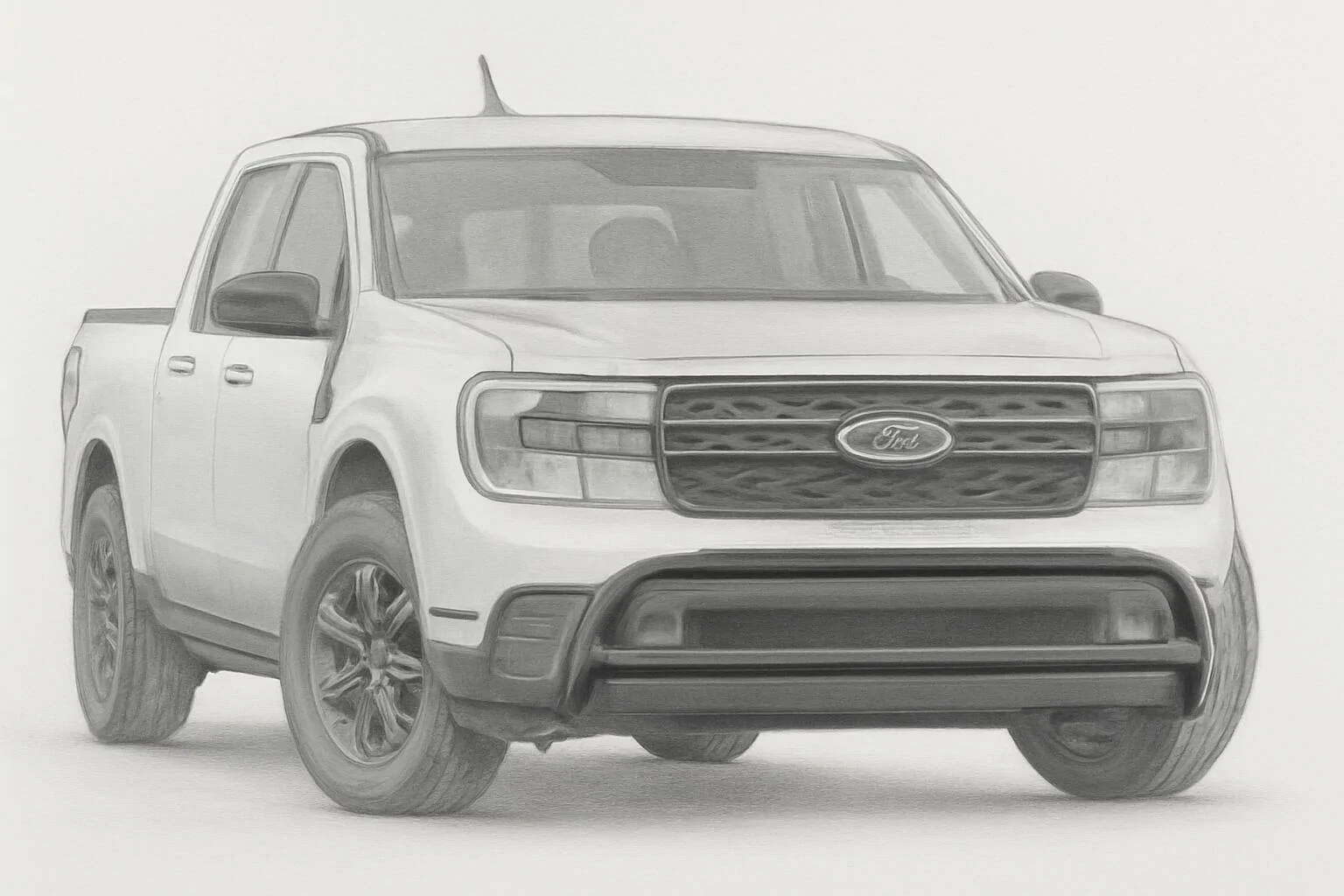

I agree does not look good.
I was looking for a low-profile, wide bull bar that serves the purpose and is almost invisible. I did a lot of online research but could not find any. My husband came up with a custom one and hope some manufacturer can make it.
I've had better luck with full replacement steel bumpers (like a Ranch Hand or ARB) than grill guards or bull bars.
Grill guards have a ton of leverage on the mounting points and can cause the frame horns to buckle upward and then the grill guard smashes into the headlights and the hood.
I'm not a fan of bull bars either. They hang further forward and at the same level as the front bumper, which reduces overall approach angle. I'd rather just scrape the bottom of the bumper (it's unpainted plastic anyway) than scrape a metal skid plate that might bend the frame horns.
