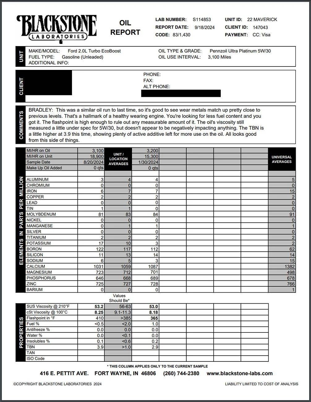

Hate to be a naysayer in this conversation, but I would suggest you find a different oil. The low viscosity combined with an apparent low fuel dilution tells me the oil has sheared enough to bring the value down to around a 20 weight. Your iron is still around 2ppm/1000 miles, not enough to have heartburn, but indicative the oil isn't up to the demands of the EB.

Surprised viscosity low.
Did sample on my truck at 1500 miles since new. Also did sample on wife’s 2017 Escape, and it’s viscosity low too. The oil is Motorcraft.
So viscosity is out of range, yet Blackstone says should be ok.
i pull my sample with oil barely warm, not hot. Blackstone says no matter, they heat up oil when doing viscosity sample.
Low viscosity is an engine killer. All the timing components shear the oil molecules that kill the oil.
You need to find an oil that won't shear..
Watch "themotoroilgeek" and "fordmakeyouloco" on YouTube for more info on oils and extended oil change intervals.
What worked for you in 1990 won't work today.

Looks good. I've been changing at 3k just for the samples to be consistent and to make better judgement of how long the oil lasts in my driving conditions/location. For me, it ends up being once a year and I'm happy with doing it once a year. I'd do it once a year regardless of how often/little I drive just to have something to do and keep the engine peppy. I just don't drive as much as I used to and I'm happy about it. The EB seems happy to. Here are the results so far:
I'm happy between 3-5k as the manual states for my driving conditions and I'm happy with the Pennzoil Ultra Platinum, but I also just got some Rotella T6 Multi-vehicle that I'm going to use eventually too. It was only $25 on sale and is also great oil for the EB's, just not as many additives. That is probably why the TBN came back so high on this one in comparison to the initial change where I'm pretty sure a good 1/4th quart of old oil was left in and I have no idea what type of oil it was as I bought used with 11k on it (but the oil was definitely changed by CarMax before I bought it). As long as the antifreeze number doesn't start climbing I think the EB will be okay for a while longer 🤣
So, have at it. Tell me I should go for 10k like a Hybrid or tell me I should change at 1k. I don't care much. Just sharing my results for my use and my preferences on maintenance.
To anyone seeing this information for the first time, if you are interested, contact Blackstone to get some sample containers sent out.
Sorry...look at the "properties" section on that report.
The BOLD letters say the the SUS viscosity ans cSt viscosity have both sheared out of spec... your oil is not lasting long enough to give your engine the protection it needs.
Change your oil brand or shorten your oil change interval.
