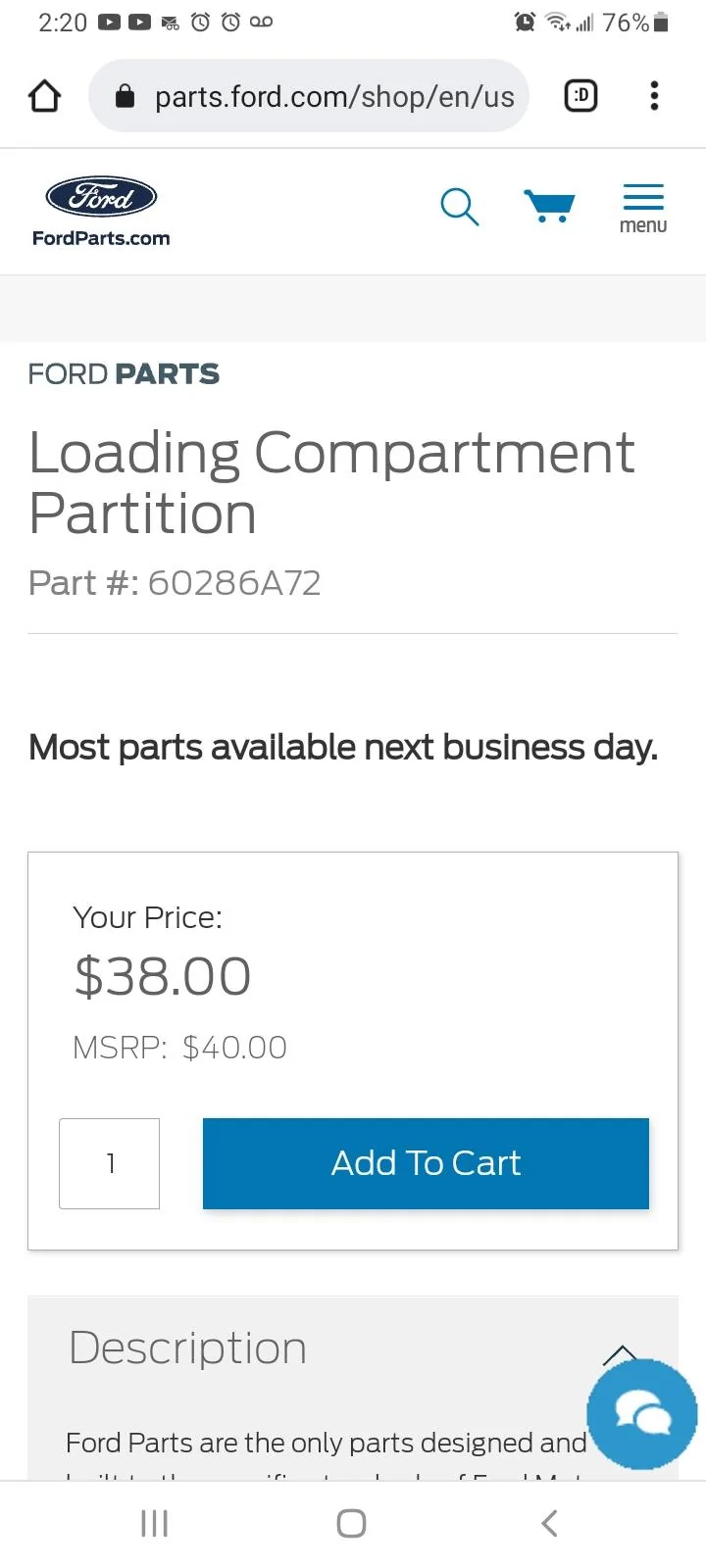

Has been on back order, for anyone who has been looking to get it, currently available, see pics
Ford Maverick Bed cubby now available Screenshot_20220427-142036_Chrom

already out of stock:
Item is currently on back order. Contact Your Dealer to check on part availability.

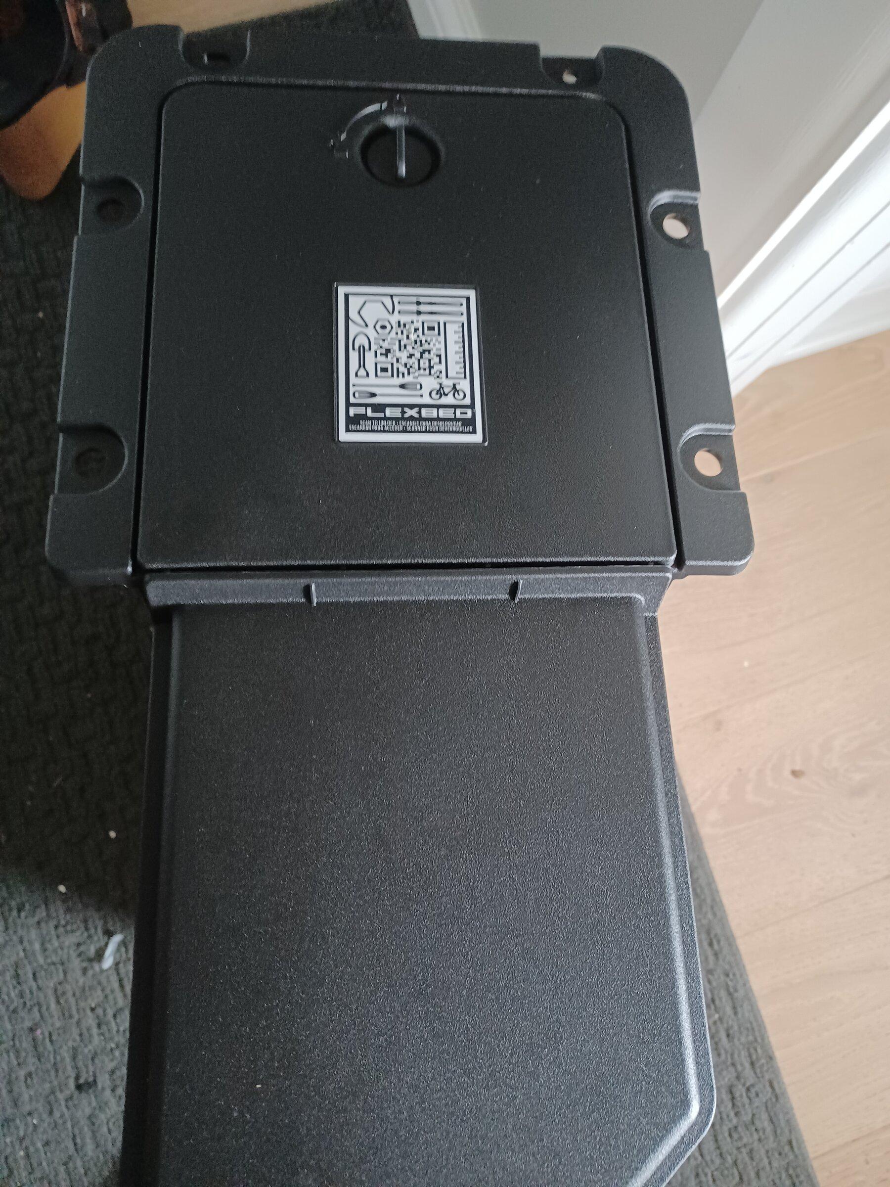

Just installed these on my XL today. It took under 15 mins.
I ordered from FordParts.com. Some dealerships charge different prices. I paid 9.95 for overnight express shipping from the dealer I used.
You need two of these are they are the actual parts being installed. They come with doors and the slide in dividers but no extra bolts. They are 34 dollars each(msrp is 40 dollars)
Loading Compartment Partition
Part #: NZ6Z60286A72A
You need 4 more bolts. These came as a 4 pack for $11.90 sometimes they are per bolt and around 3 dollars each depends on the dealer.
Hex Head Bolt And Washer
Part #: W505424S450B
Tools required
T30 torx bit
10mm socket
Remove both rear tie down points with the T30 torx bit
Remove the 4 bolts on holding each blank panel on
Remove the blank panels
Install the cubbies they just drop in place
Install 6 bolts per side on each cubby. Dont over tighten them its plastic.
Install the tie downs
You are done
A few things I noticed while doing this. The bed holes where the D rings go into the floor in the front are not threaded and need to be tapped if plan to install them. Same applies to the rear upper tie down holes they are also not threaded. The bed rail holes the run along the bed are tapped and accessories can be installed there without any issue.
