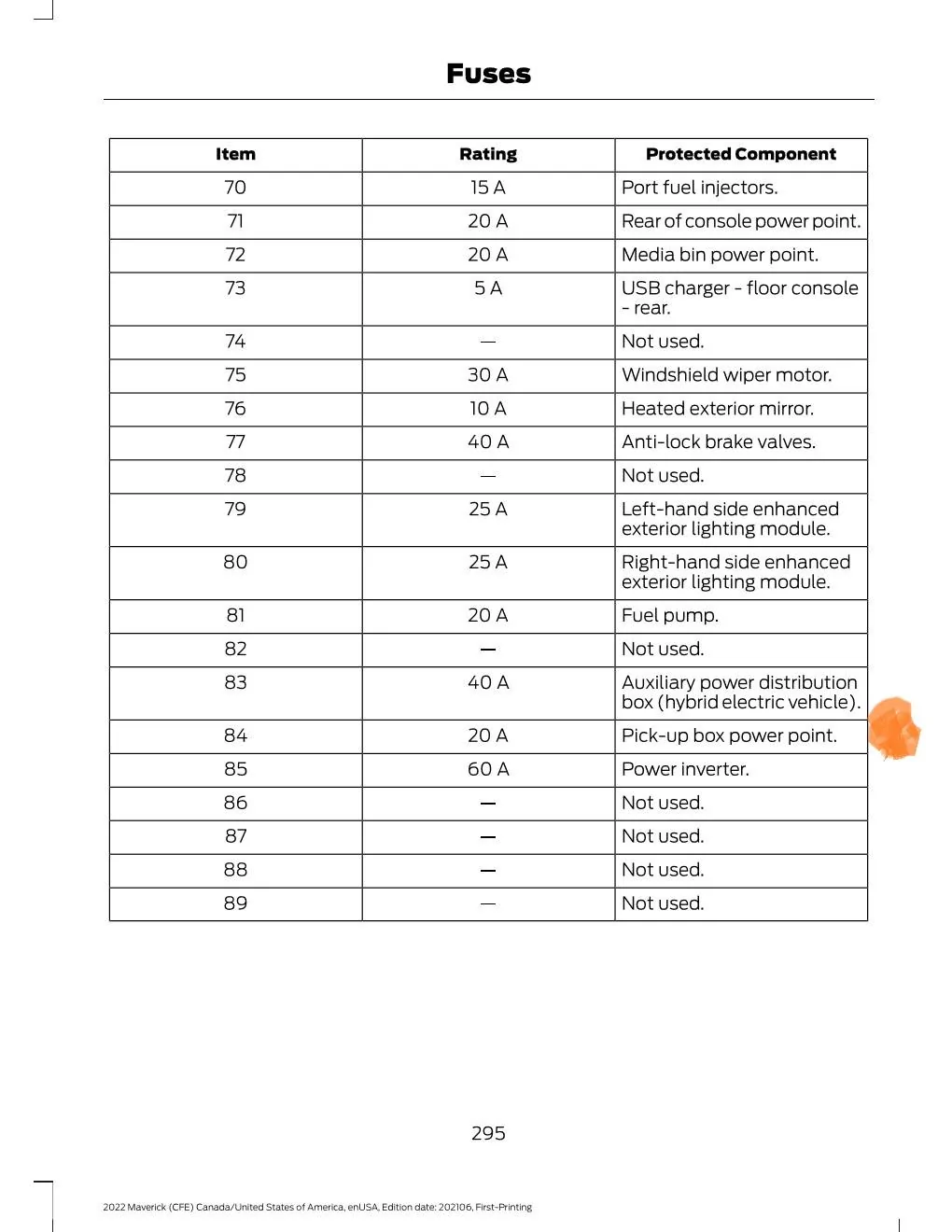

Anyone know if they are fused together or separately? I'd guess together but it would be nice to know for sure.

Both are on a single 20 amp fuse.

Thanks, item 84 on that list?

20 amps should be plenty.

anyone know if the leads are constant 12v or switched 12v?

Pretty sure they are switched.

Ok, I am way late on this but as I read the fuze chart i believe the two power points are on separate fuzes. Is not #71 the in cab power point and #84 the in bed power point?

the original question was about the 12 accessory wires in the bed. IIRC there is one on either side of the bed. These are different than whatever power point is present on the rear console. That one could be 12vdc or 120vac depending on whether or not you got the inverter.
