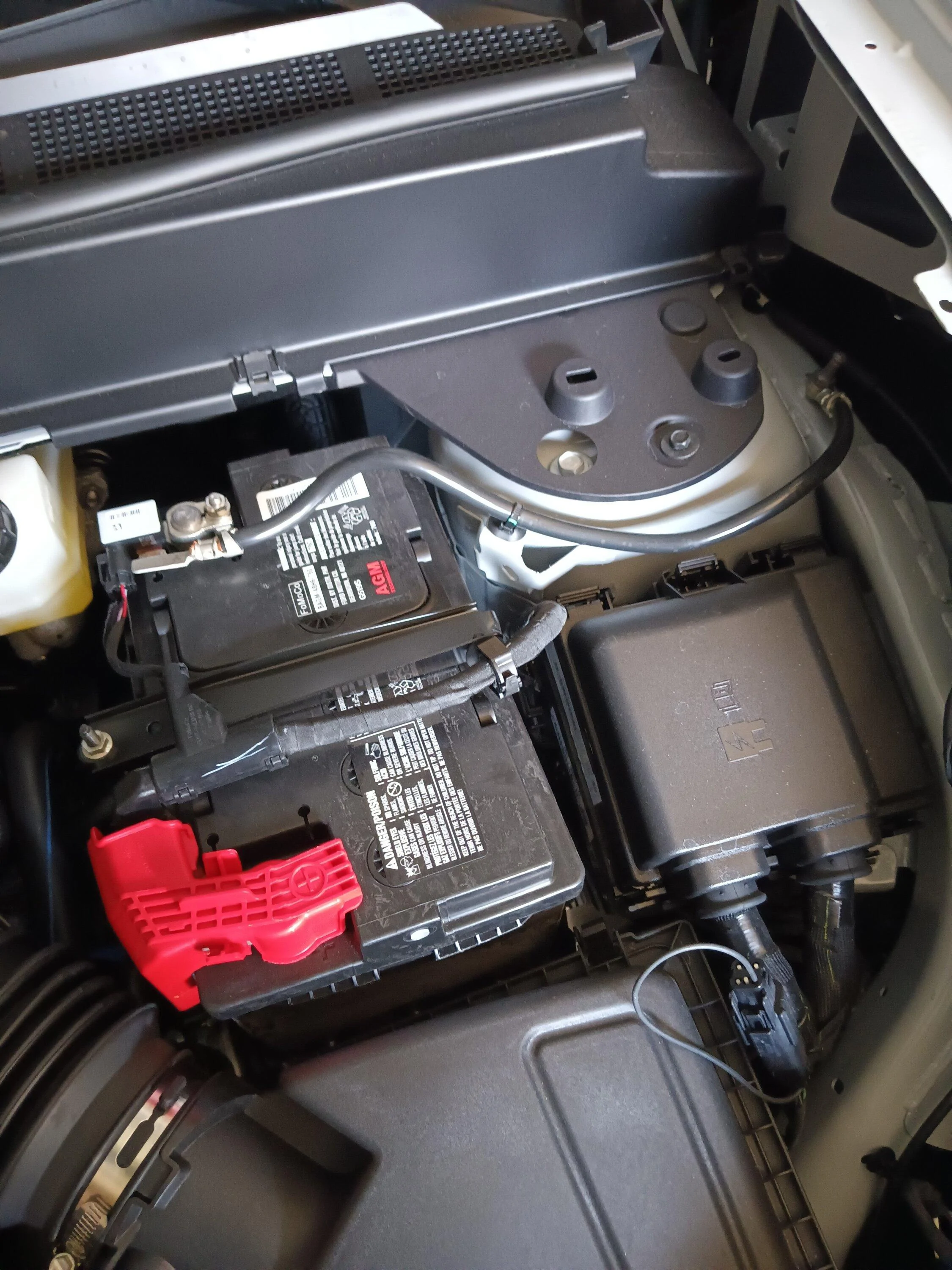

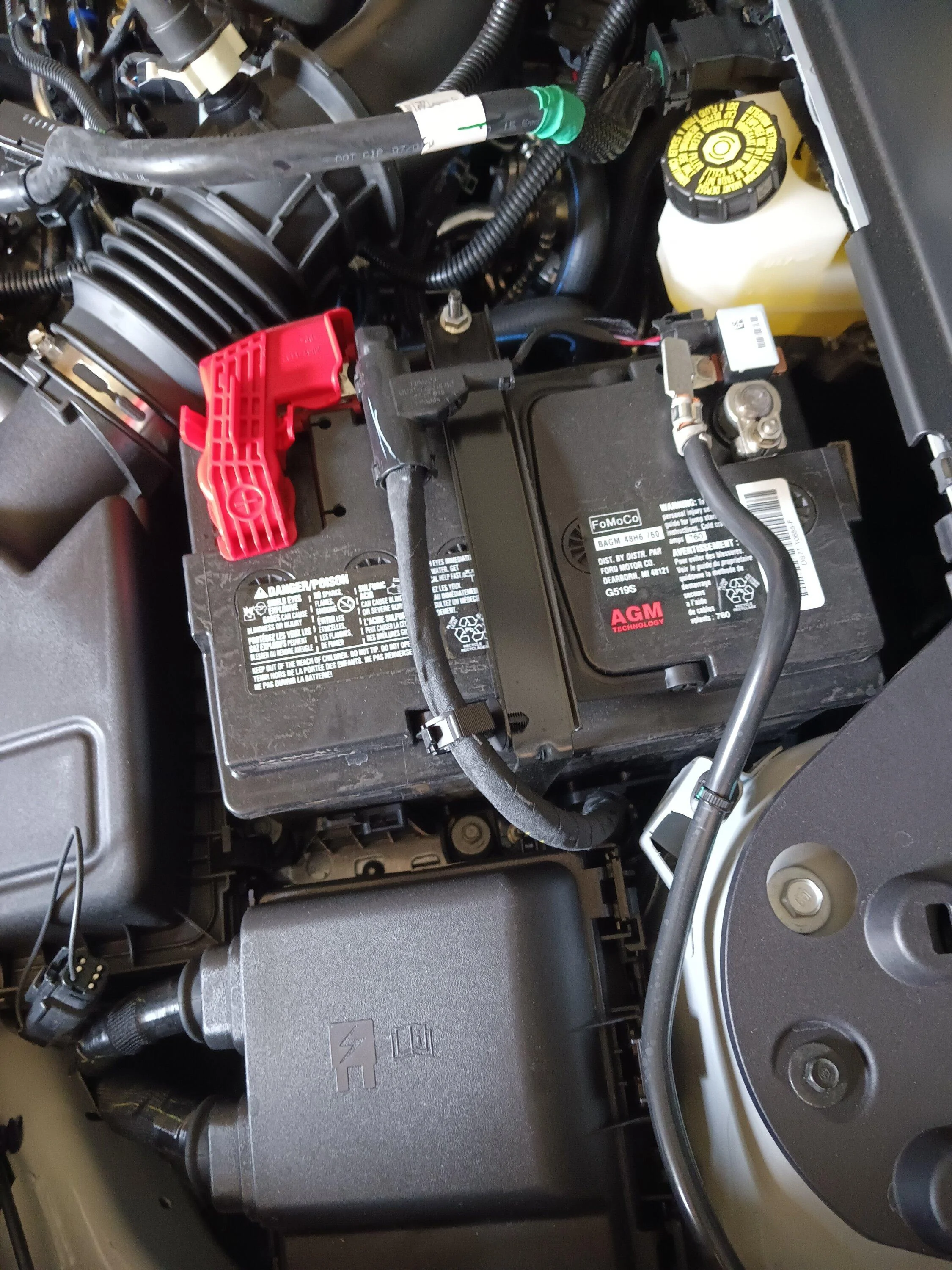

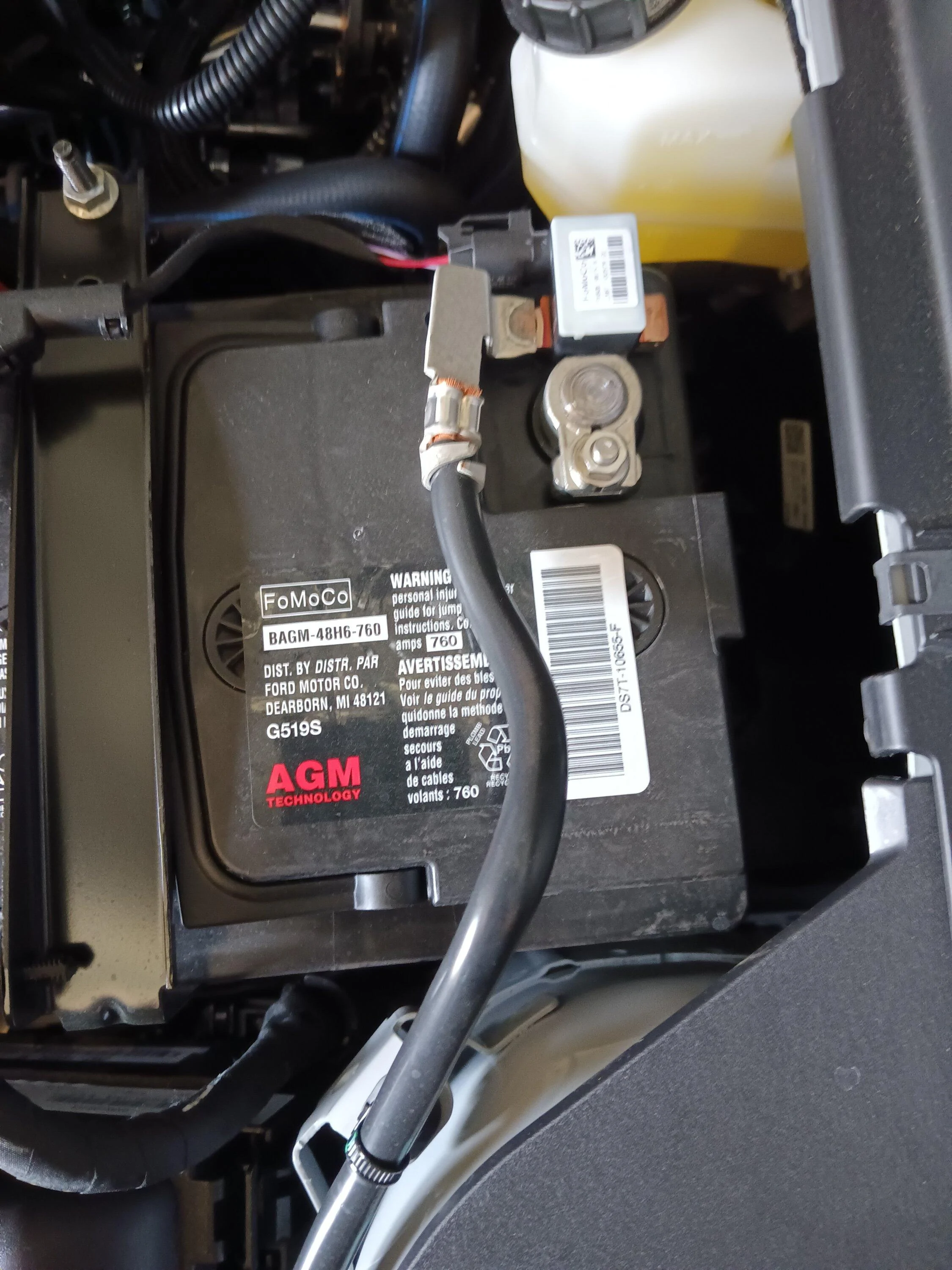

I just looked at battery in my 2.0 Tremor I picked up Thursday 8/24/23 and it has a nice AGM 12v battery if I remember correctly I think it said 760CCA so exceeds capacity of my 5amp noco genius so will have to get a 10amp upgrade noco.EDIT TO ADD. CHECKED BATTERY IS 70AmpHours SO 5AMP NOCO IS ADEQUATE!! NOTE the negative wire from the battery post over to the negative jump post. The white tag nearest to neg battery post is on the BMS for the 12v battery. Properly charged periodically this battery should last many years.
