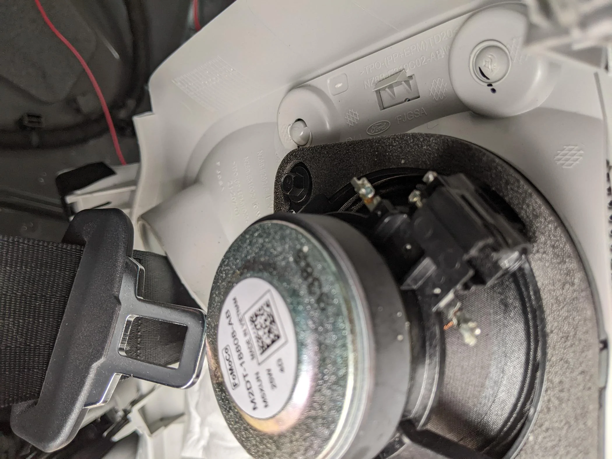

Ford Maverick Base speaker wire schematic PXL_20240511_224241432
ive got a 2024 Ford maverick, and I'm installing some subs. Also going with a line output converter, but I'm having second thoughts on which is the positive wire on the factory rear speakers. I've pulled out the panel and all. There is a GREEN/PURPLE wire and a solid GREY wire. Any help would be nice.

I have a Hybrid, so my wiring is different. Are the connectors that connect to the speaker different sizes? Usually they are. Manufacturers do this intentionally so it easier to connect positive and negative terminals correctly. If this is the case for you, this will tell you which wire is positive and which is negative. Hopefully this is helpful.
