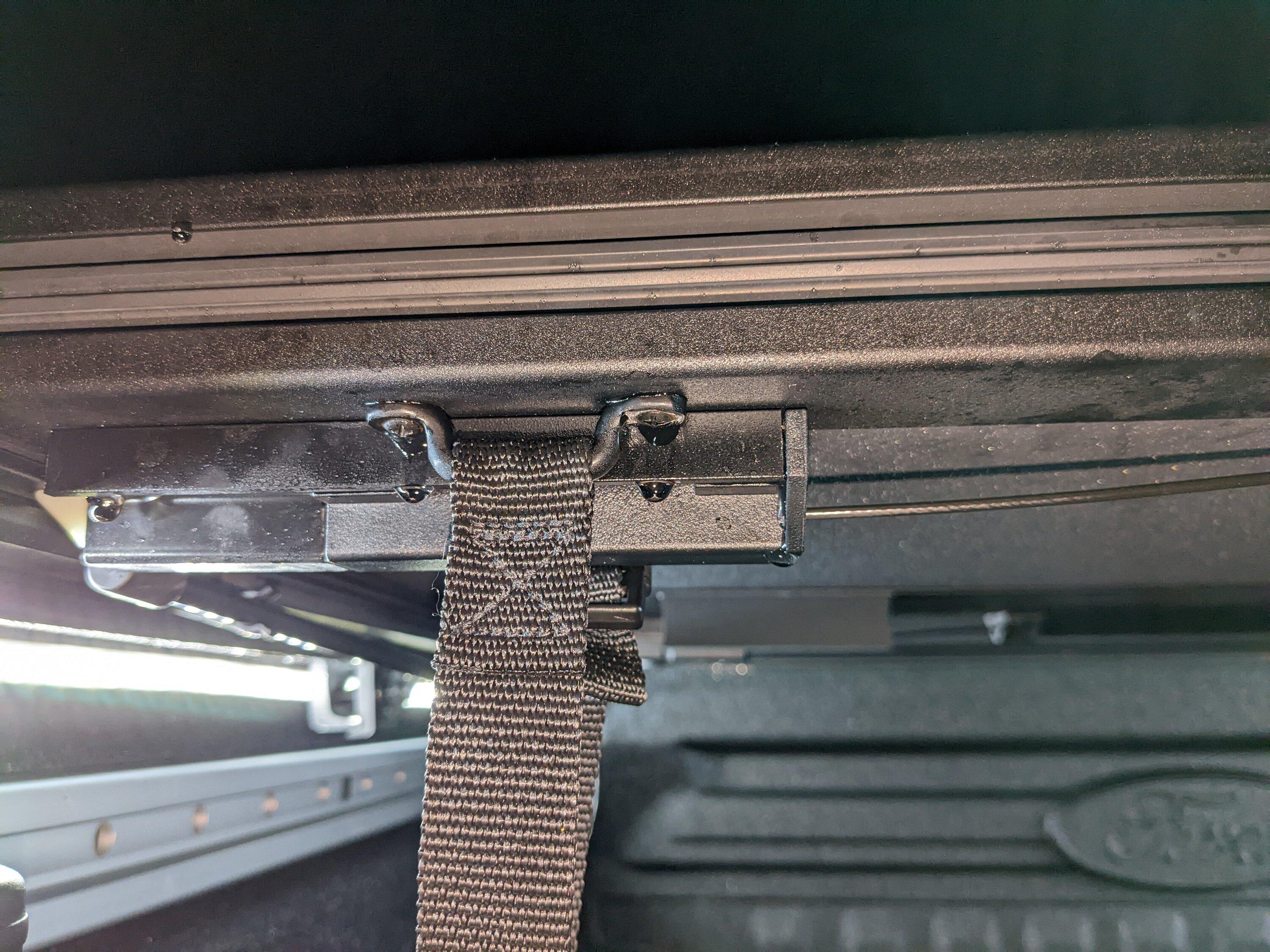

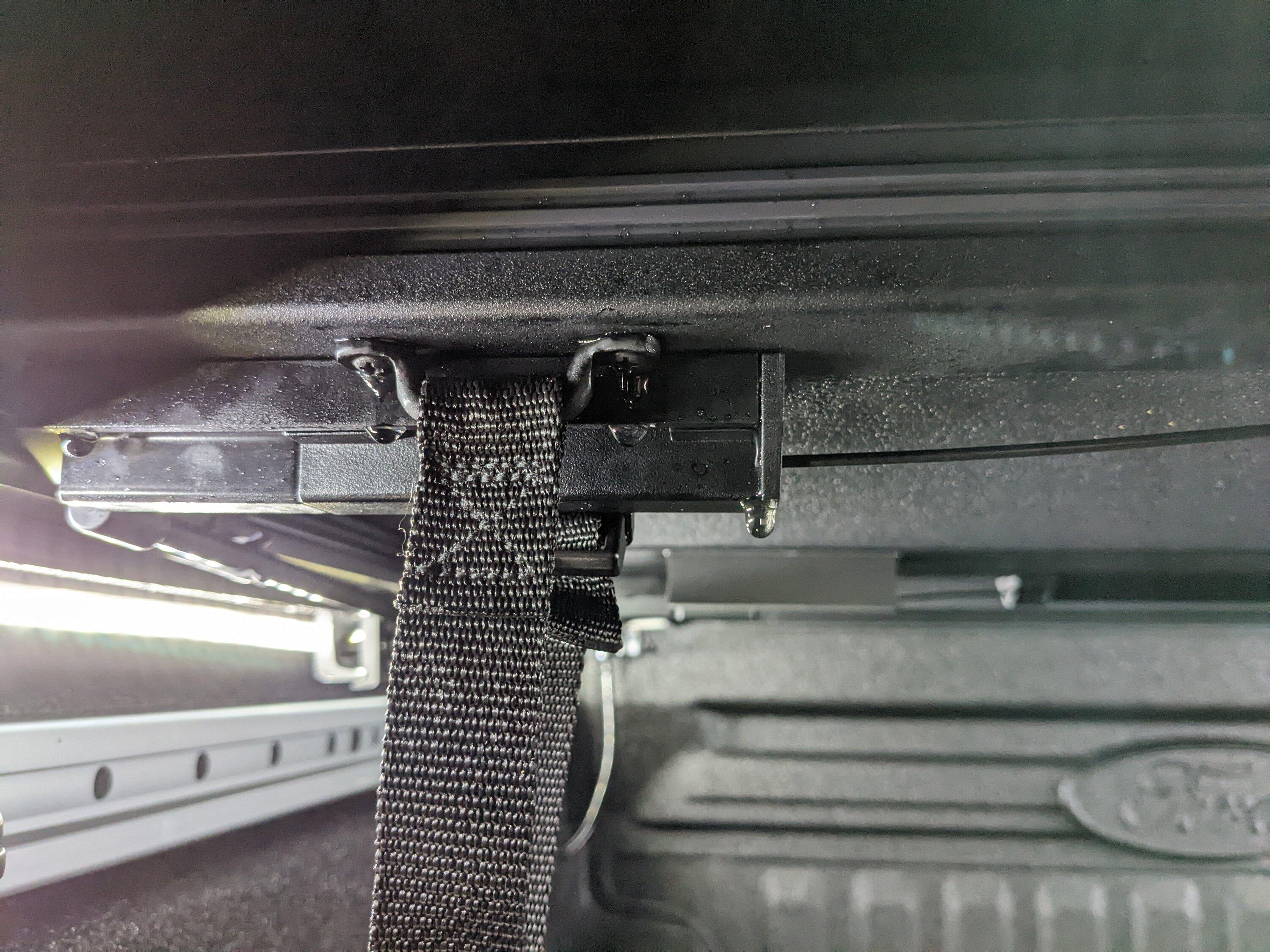

Anyone else have this issue? My new Bakflip mx4 seems to be leaking somehow from the locking mechanisms. Or at least that's where water is ending up and then dripping into the bed. It's not a ton of water, but enough to leave little pools in the bed. Kinda frustrating. I'll be reaching out to Bak, but was just wondering if anyone here has the same issue.
Could be running down from the gap in the plastic bed seam. Real Truck posted a YouTube video on weatherproofing.
I sealed those gaps up pretty good with peelable silicone caulk. I'm wondering if it's condensation since it was a really chilly day. I'll try get out there with a bucket soon and see if I can investigate and figure out how/if the water is getting in

Update time. After a few more rainstorms and investigation, water was definitely leaking into/through the aluminum panels/seams and then dripping through the screw holes where the locking mechanism/hardware are mounted to the underside of the panel.
I sent Bak photos and an explanation, and they're sending me a replacement cover under warranty
