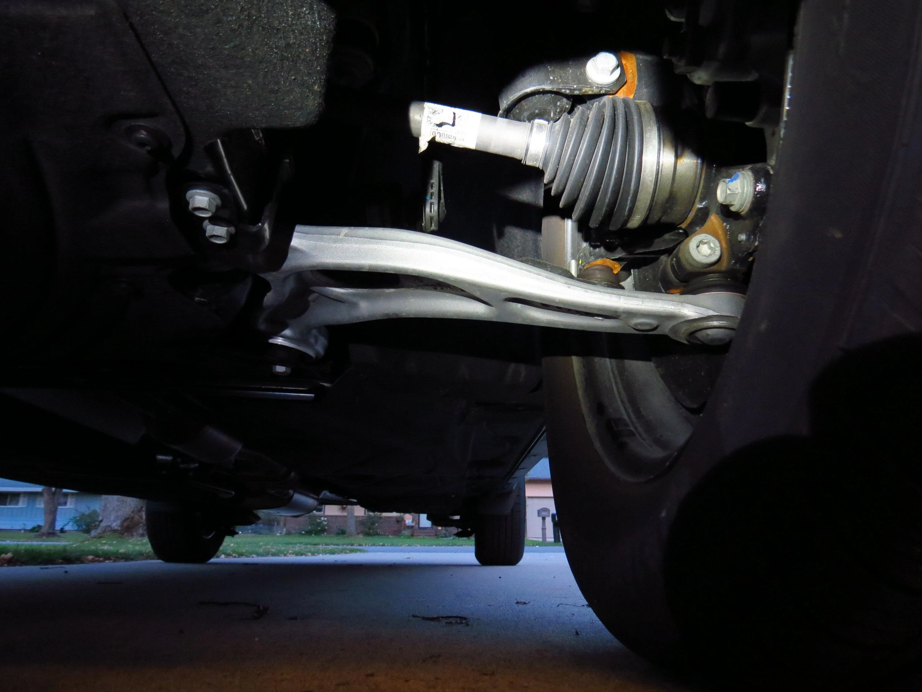

  • On my 2023 XL hybrid w/ stock ride height and stock wheels/tires, a digital angle gauge tells me that the axle angle is 12 degrees.
  • I did a Google search of 'optimum CV axle angle' and took a look at a sampling of the sources returned. Consensus seems to be 22 to 30 degrees is the max. I only found one reference to "optimum" on a racing forum where the poster suggested zero degrees which seems logical, but I'm not putting a lot of faith in that. One data point is not enough.
+ or - 12deg? Wheel down compared to the trans would be -.
if - it wouldn't take a lot of lift to get to 22deg or much slam to get to optimum.
I'm with you and the racing forum that 0deg would be ideal, less friction loss.
On the stock truck at rest, the wheel hub is lower than output of trans. So the axle angles downward. Bad pic of mine using a flashlight:
Again, these are fronts on my FWD.
that would be -. thanks for the photo.
