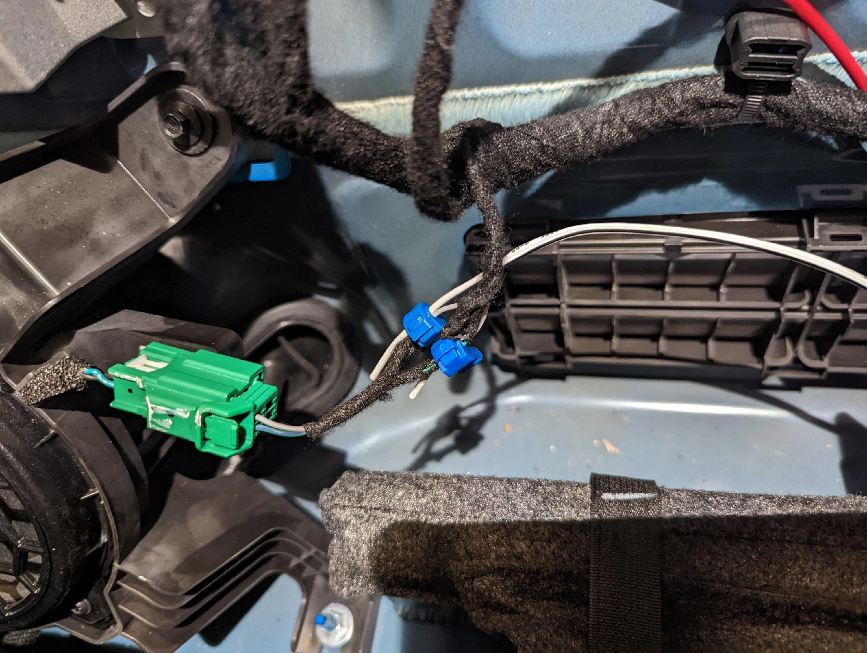

OK so what size is the center speaker? And did you have to rewire it or is it a plug and play. The sound deadening in the doors looks easy enough just time of pulling all the door components and then reinstalling.
3 1/2". I don't know offhand if there's a readily compatible pigtail. If one is handy with a soldering iron it's not particularly involved to surreptitiously steal the one off the stock speaker or just cut the thing off to be repurposed.
