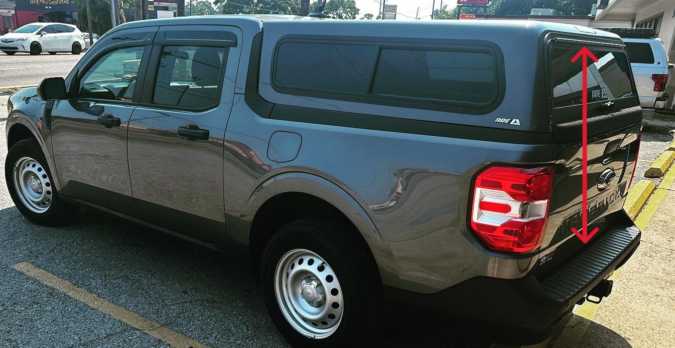

Does anyone have the height of the opening between the bottom of the glass when open to the floor of the bed? I would like to get the A.R.E. V Series Cap but need to make sure that I would be to stack two specific bins inside. Thanks in advance!
Ford Maverick ARE V bed cap shell installed on Maverick XLT Maverick Cap Height
