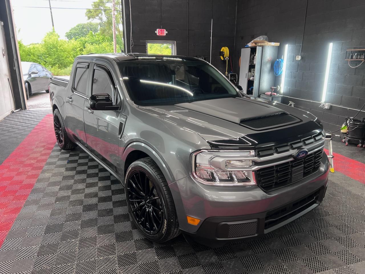

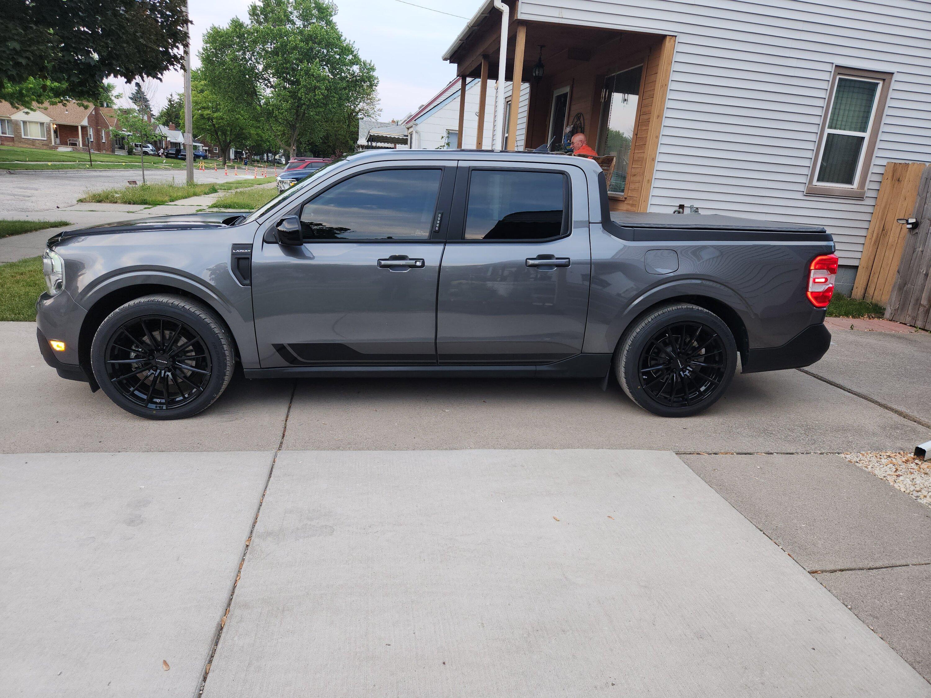

I have the steeda and love them. I did get a alignment but didn't purchase the adjustable link. It's fine. 2022 hybrid
Thanks for the pics they look amazing. I have the same color as you, very excited for the lowering springs to come in.
