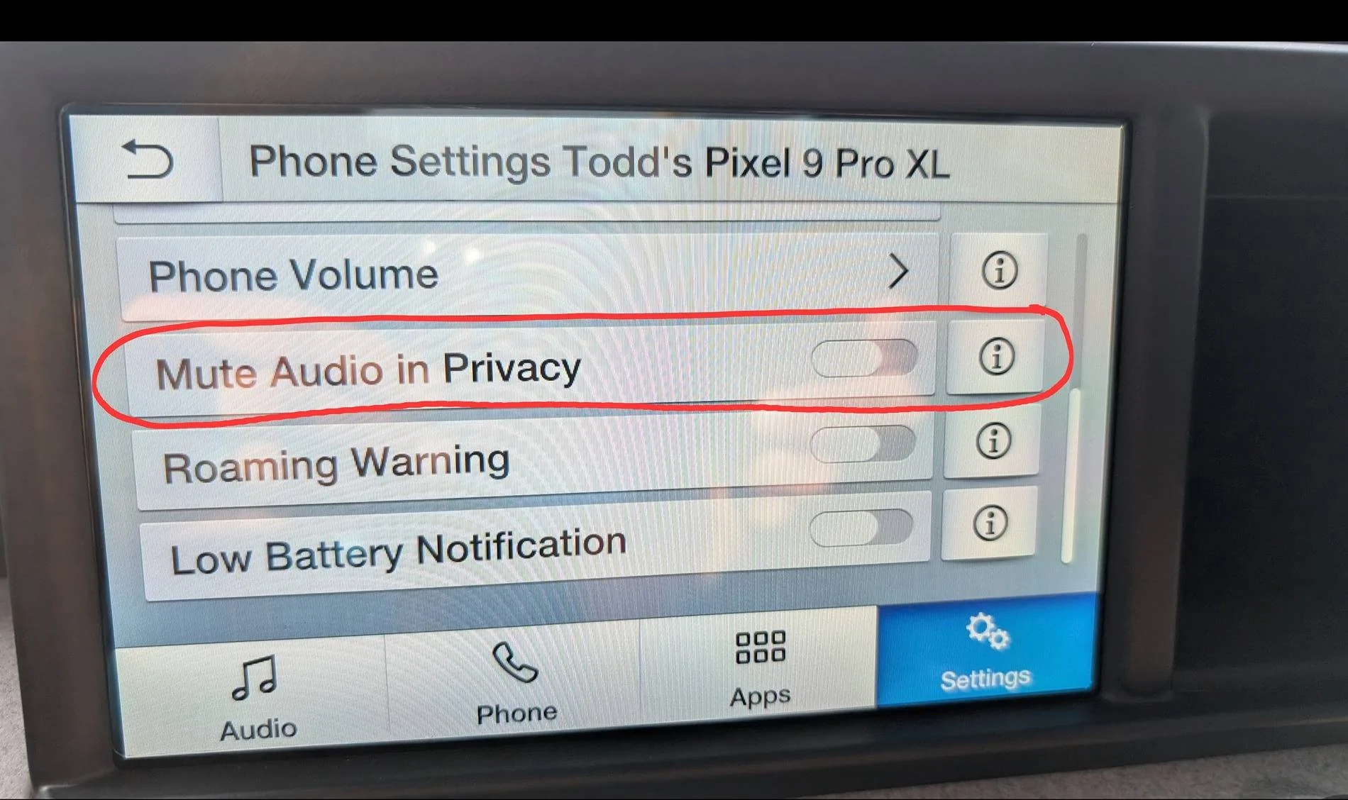

Also I don't think it's a iPhone issue I think it's a Maverick radio issue, with the phone call problem.
I also had a issue with my Pixel 9 pro XL when I first got it two weeks ago. I couldn't hear the other person, changing this setting under call privacy in the phone settings on the radio fixed the issue.
It was enabled causing me not to hear the other caller, disabling the setting fixed it.
Disabling "Mute Audio in Privacy" worked for me as well. My Pixel 8 was paired and connected to my '24 Mav XLT, and whether Android Auto was running or not, phone calls and Teams audio over Bluetooth were muted (speaker and mic) until I disabled this setting.

I have this disabled and it still does not work
