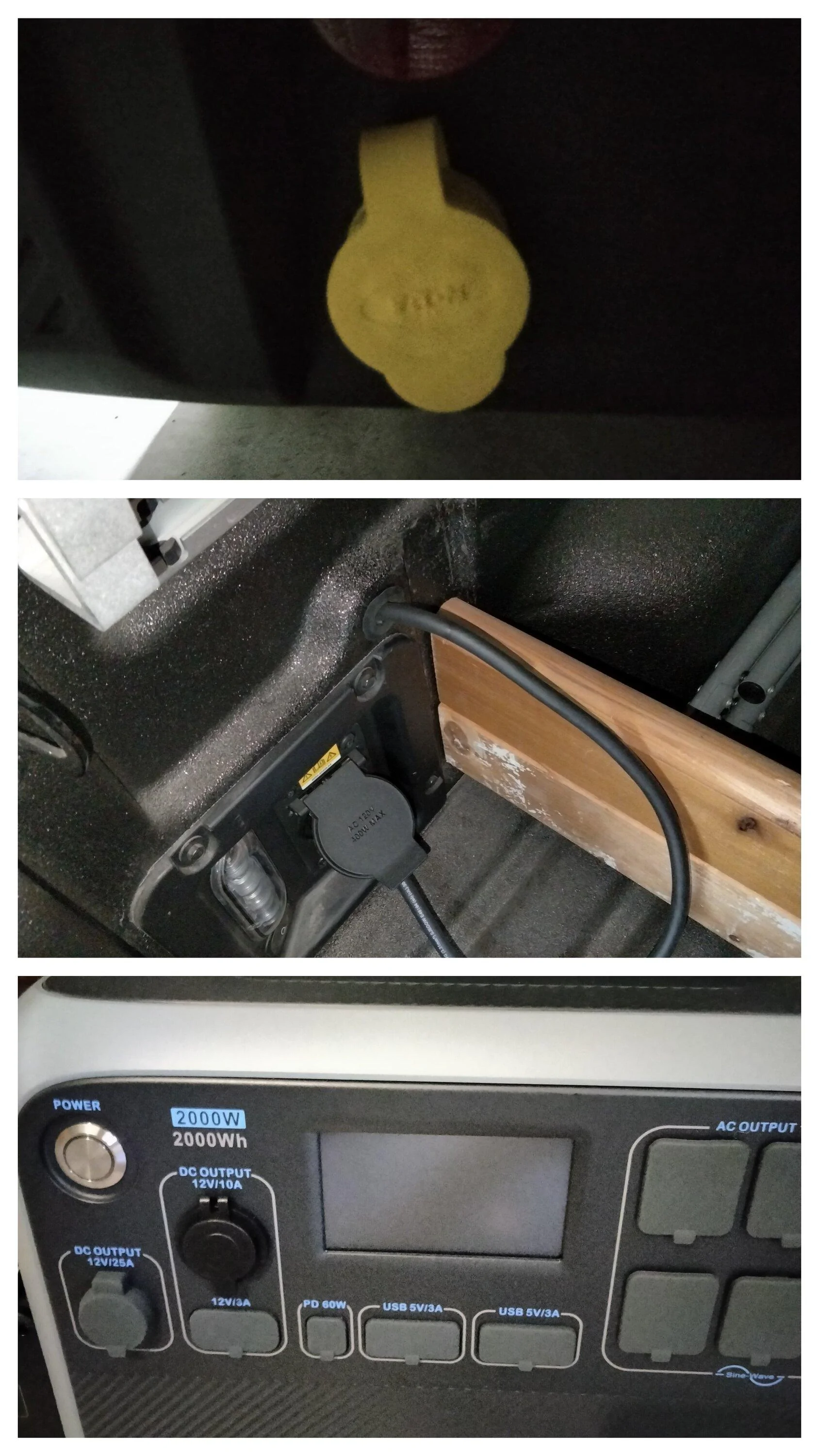

This beast will run the camper for the night, well most of it, and the CPAP.
I installed a 110volt jumper so I can lock it up while using it.
Check your CPAP, a lot run directly off of 12 volt. Some CPAP makers offer plugs that go into 12 volt power plugs. You can run your machine longer when you don’t have to convert to 120 volts just to convert right back to 12.
It's finding the right part for this machine, VA doesn't care about our convenience, machine is running at 24 volts. It's how the Bluetti power pack is located, 12 volt receptical is in the way of several functions, it's what I can do in 47 square feet of space. Your family bathroom is about the same size as our camper.

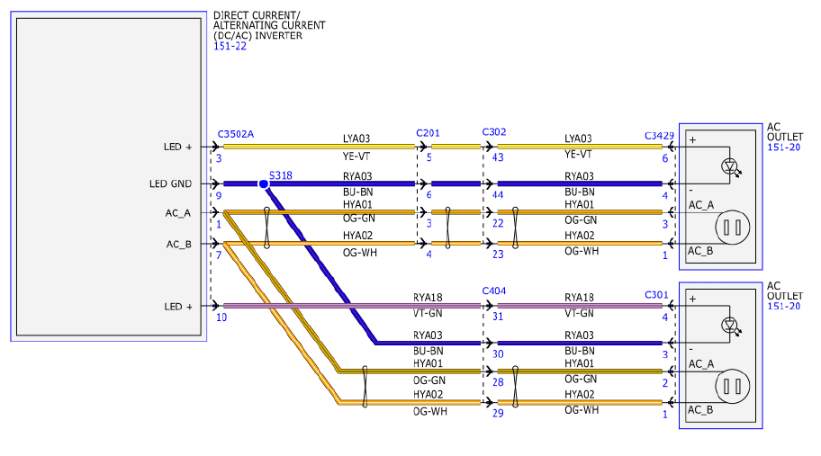

The Lux Package bed inverter outlet is wired to the same inverter in the center console as the in-cab outlet.
This got me thinking. Since I have the factory in-cab inverter/outlet installed, what specifically would it take to add an outlet to the bed?
Darnon
Jul 4, 2021
5,725
7,240
WNY
You could disconnect the C404 connector in the rear beneath the truck and see if pins 28, 29, 30, and 31 are populated. Even easier if they have the C301 connector on the rear harness as well, otherwise you'd just need to add the pins on the rear side of C404 and add an intermediate harness to add the OE outlet. Edit: Although supposedly the C301 connector doesn't have an available replacement (through Ford, anyways)
