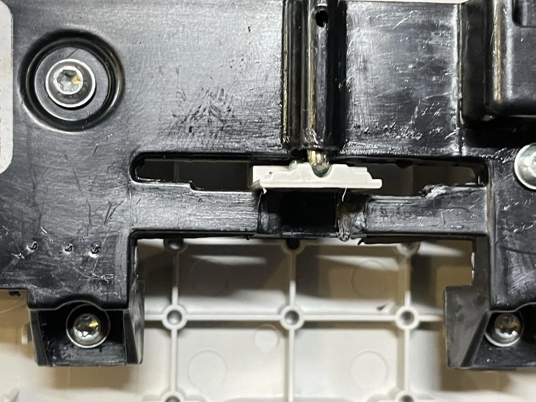

I recently took off my sunlight control panel in order to install an auto dimming mirror. Mirror works perfectly, however, the interior light switch is not working properly. It seems there is a small spring on one end, chrome cap on the other piece that became dislodged around the switch mechanism. I cannot for the life of me figure out where and how it supposed to go. Wondering if anyone has a photo of what the inside of the sunroof control panels is supposed to look like. I'm not expecting anyone to remove their panel just for me, but perhaps someone has ready pic from some DIY project involving the cover.
Ford Maverick Anyone have photos of sunroof/interior lighting control panel? IMG_2224
Ford Maverick Anyone have photos of sunroof/interior lighting control panel? IMG_2223

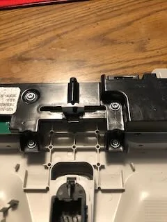

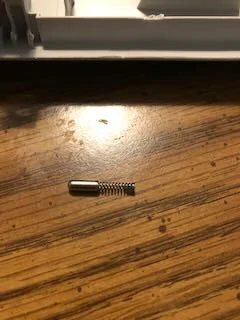

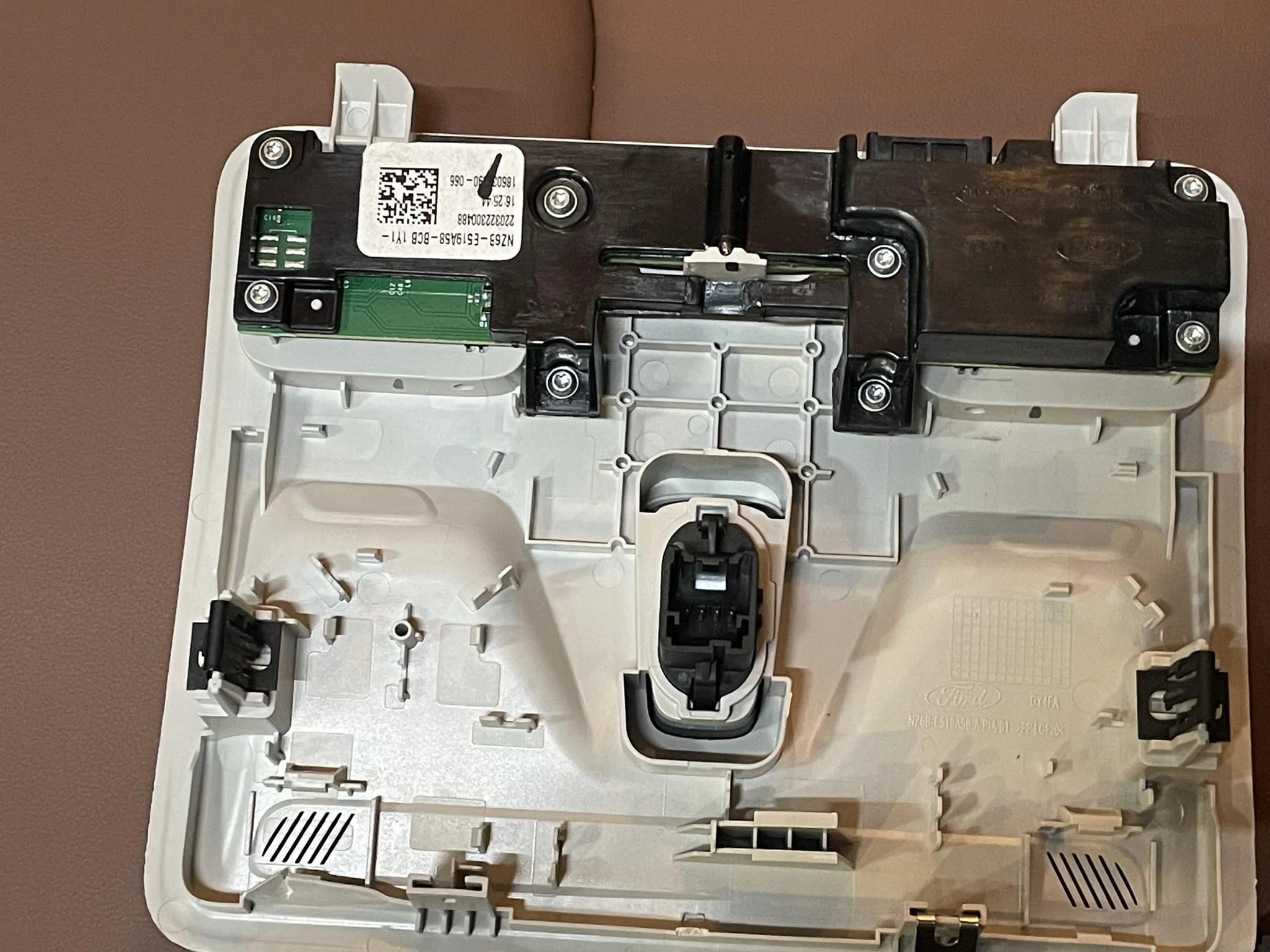

in case it happens to someone else.
Ford Maverick Anyone have photos of sunroof/interior lighting control panel? A83461FF-24C1-424C-A903-A464E272EACC
Ford Maverick Anyone have photos of sunroof/interior lighting control panel? DD4AF044-7ADA-4770-B9BA-890402C8A4BE
Yep, that's the little bugger. As mentioned in an update, I finally figured out where it lived. Took some doing to keep it in its little burrow while I re-attached the circuit board. Many thanks for posting this picture. Hopefully, no one else will duplicate my mistake, but if so, this pic will be a hair-saver.
