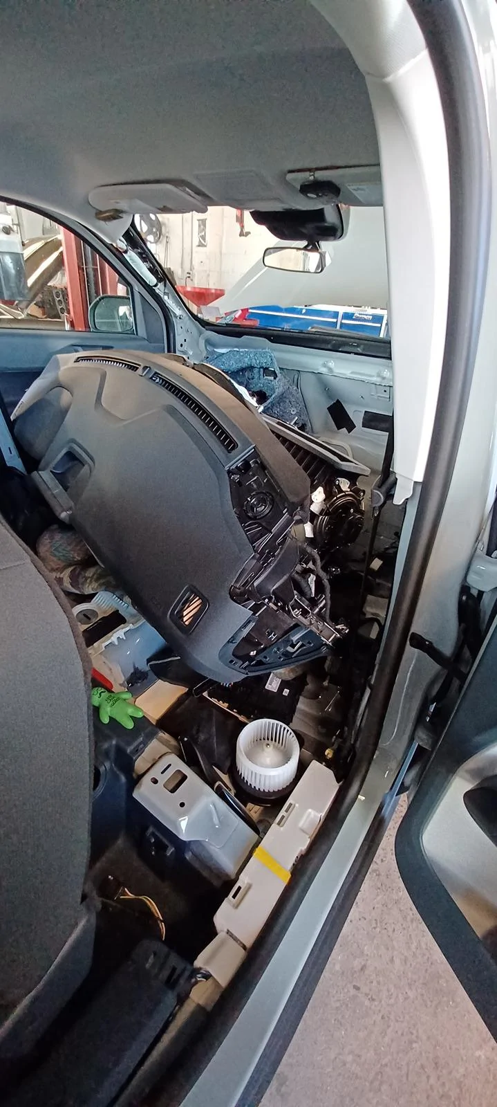

This is something that is a BIG PROBLEM!!! Mine has been at the dealer since 3/21. I haven't had any updates, so my honey and I took a road trip (16 miles) to visit him. I looked in a shop door window which is separated from the main shop area, and saw my "MaverickTruckClub" sticker on the rear glass. The dealer was closed (Saturday late afternoon) so we peeked in the shop windows.
My vehicle's new name is Scarecrow, like in the Wizard of Oz, when the witches' flying monkeys tore him apart. "first they took my legs and threw them over there!" etc, etc... Seats are out, center console on the floor, carpet draped over something, hood opened, front fender liners on the ground... We stopped looking. I hope the carpet is replaced and not de-stunkified. (won't work) I hope all the plastic clips that made my silent ride silent aren't broken and rattle, or greasy finger prints on everything.
My musty developed quickly, like a month into adoption. Again, I want to express my appreciation for the loaner while they figure it out. I don't want to rush them. I miss my car and want it right.

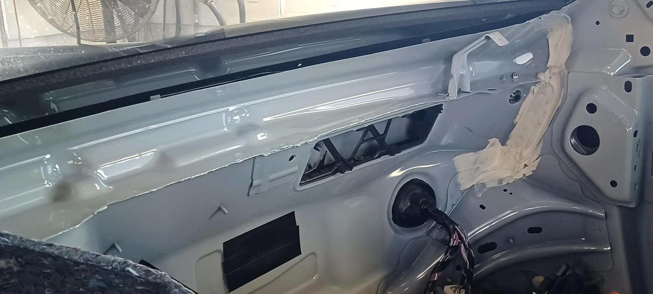

There is another thread concerning this issue. Turns out to be something between the firewall interior and exterior that was not sealed properly. It can be fixed. Dealer just needs to know where to look. It was found by having all the carpeting out on the passenger side while someone poured water from the outside on the passenger side.

Don't be scared...
I believe the repair is the silly putty you see in the right corner of the firewall.

Thanks Maui for the two pics. The First picture showing the disaster that your cab is in, has absolutely scared me. Wow!!!!! The second picture showing the putty also concerns me in regards to "how long" will that last, before it cracks and the whole issue starts over. I really appreciate you sharing your story. I can't help to wonder, why everyone else is not having this issue? How can this be an issue that is only affected a few? Best of luck to all that are having this Musty smell issue.
