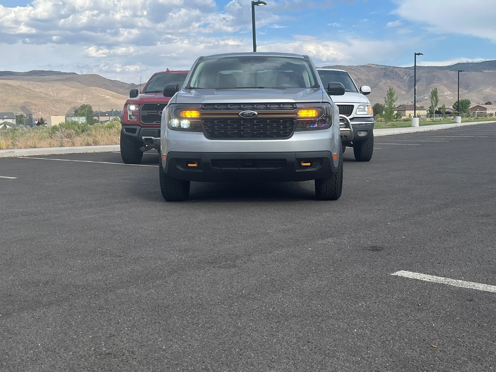

Forscan changes are as follows, I still can’t figure out how to turn the headlights off, but least I some people are able to, these are in the BdyCM
Ford Maverick Amber lights as DRL using Forscan? IMG_4938
DRL include park lamps = Enable
Dim DRL with Low Beam Outage = Inhibited
Left Front Low Beam Usage = Low Beam Only
Right Front Low Beam Usage = Low Beam Only
Using Low Beam with DRL = Disabled

No, I dont know if you notice, but LED lights do a weird flashing when you have a camera on them, so thats what happened with camera timing.
Yeah it means the cameras shutter went off at the same refresh rate of the LEDs. Typically that would be 60hz so it’s not noticeable to the eyes, but it has the side effect that it matches many cameras refresh as well.
