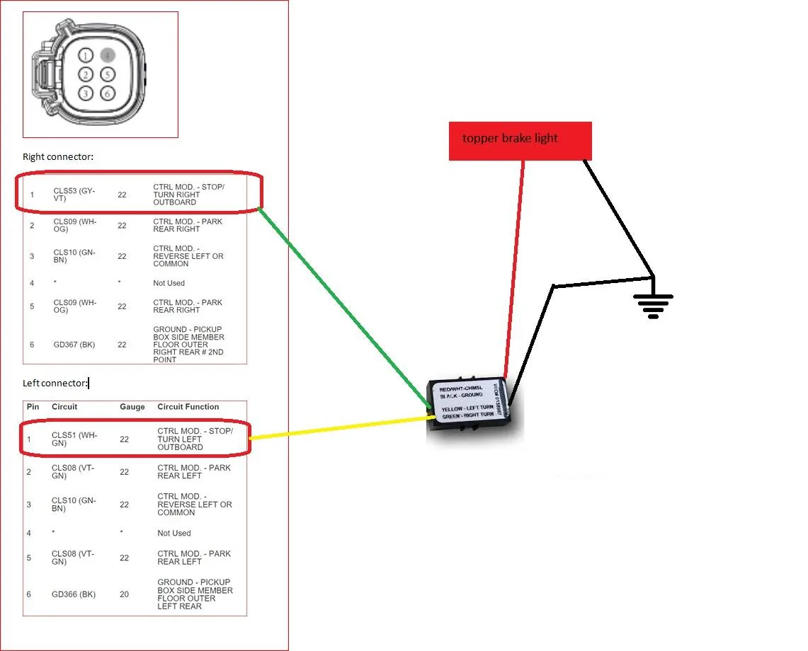

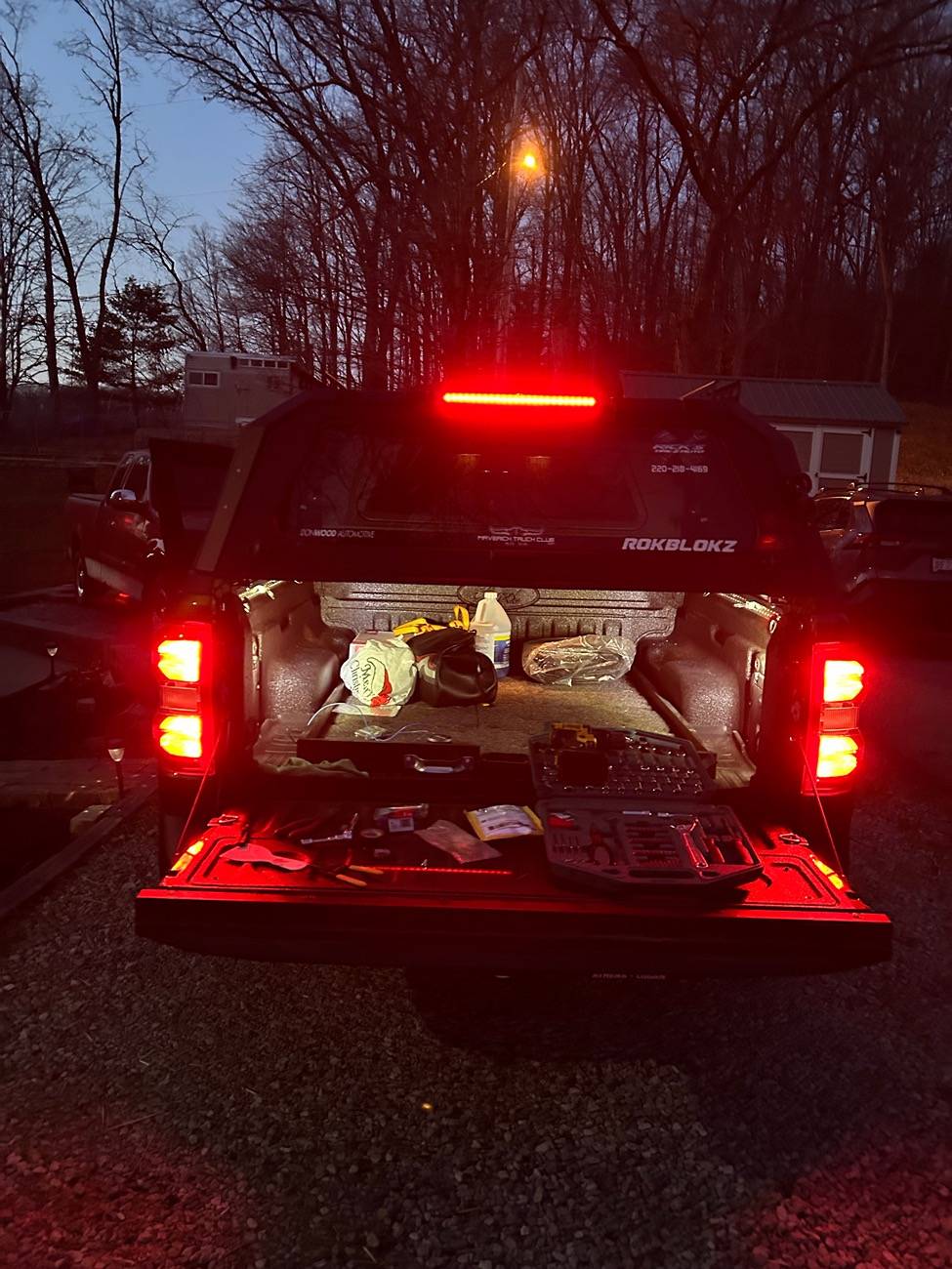

Success!!!!
Bought this unit: https://www.mastercrafttruckcaps.com/store/Truck-Cap-LOGIC-BOX-Brake-Light-Module-p657540107
-Took out both brake lights (kinda a PIA)
-Right side tapped into the GRAY/VIOLET wire from the plug that attaches to the light, not any wires on the light itself
-ran that wire under the truck to the left brake light area.
-left side tapped into the WHITE/GREEN wire (again from the plug, not the light) and attached to the logic box, and also attached the wire from the right side to the logic box
-3rd brake light power wire to the logic box
-3rd brake light ground wire to the logic box along with another wire that I grounded to the truck (found a nut that fit on a bolt on the inside of the bed
Got dark before I could get pics of the inside wiring. I will post a sketch of how I wired it up tomorrow. the wiring diagram came from a member here in another post, THANKS azadv for that. Still want to put disconnects on the wires to make removing the topper easier if need be.

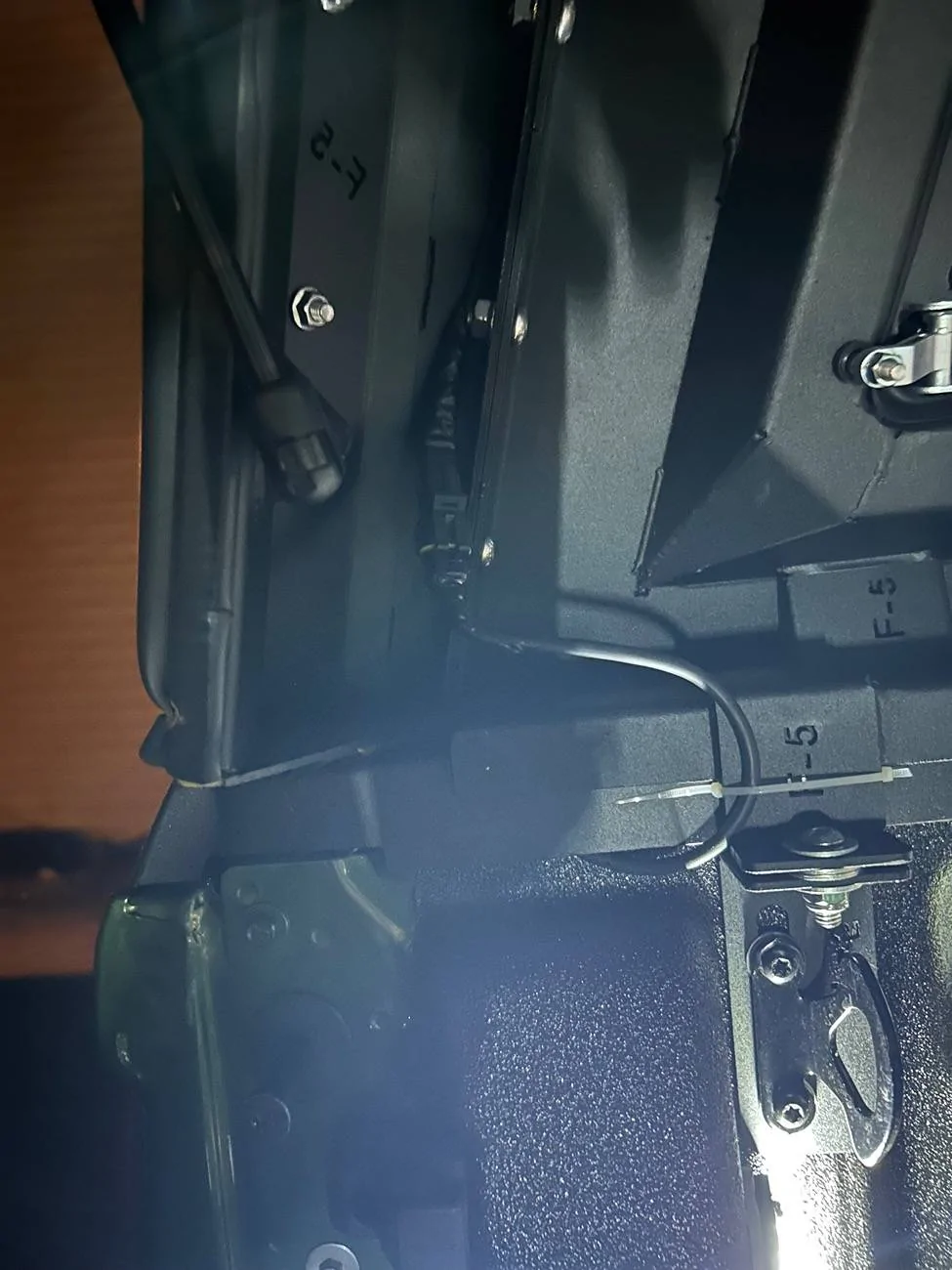

Added disconnects for the brake light and dome light for the topper this evening. Bought a kit without wires, took some patience to get things done, but turned out ok. Was able to hide the wiring fairly well under the plastic trim on the bed.
