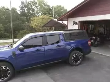

Added disconnects for the brake light and dome light for the topper this evening. Bought a kit without wires, took some patience to get things done, but turned out ok. Was able to hide the wiring fairly well under the plastic trim on the bed.

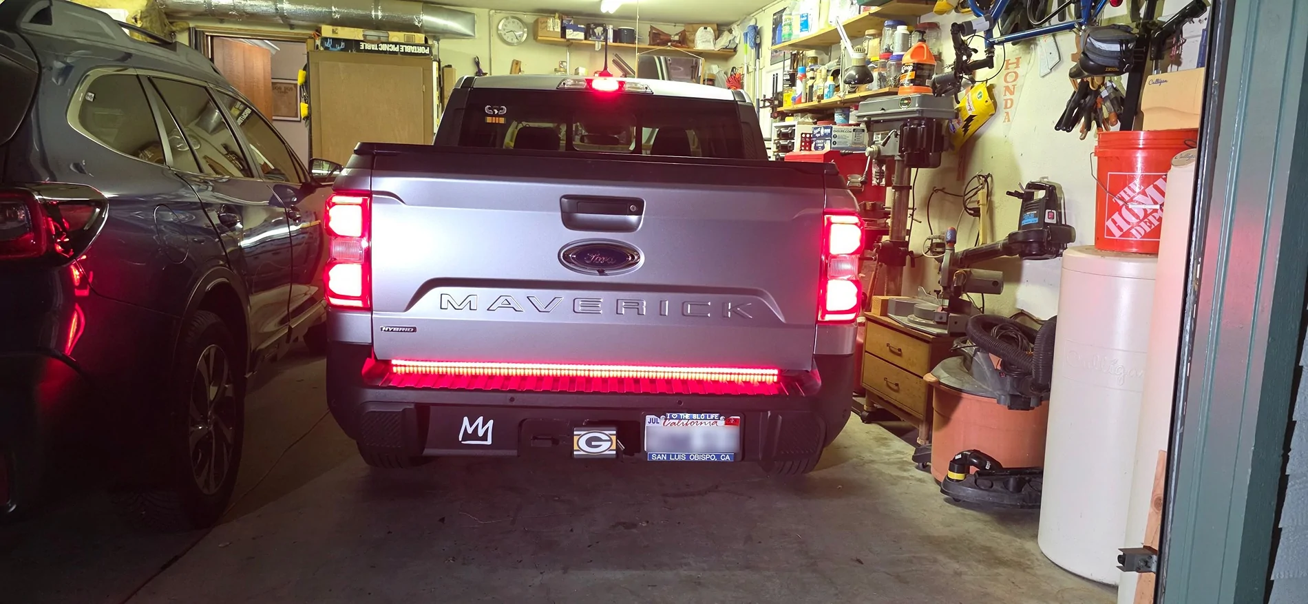

Thx a million, Don, for posting this. Your procedure worked perfectly when I installed a LED striplight as an additional third brake light on my 2023 Maverick Lariat. And yes, running the long wire to the other side was a bit of a PITA project as well. I needed (at least it made it easier) to first remove the spare tire. I ordered the Logic Box as you recommended and it makes all the difference to not have the LED strip blink with my turn signals, only when braking. See attached photo.

Follow-up: Here's the the well-made LED strip I bought on eBay. "Alpena LED Tailgate Strip"
Their instructions say to simply plug the 4-prong plug into your trailer connector but that sucks bc (1) your trailer hook-up is no longer available for a trailer, (2) plugging the LED into that connector makes part of the light strip blink when your turn signals are on which is not desirable, and (3) my Maverick thinks that I have a trailer connected to my truck and disables my backup camera. UGH! All those problems disappear once you connect the wires as you showed above, except that with the 4-wire LED strip light you would (1) cut off the wire to the running lights, (2) twist or otherwise connect both the Left and Right turn signal wires together and connect them to the RED wire on the logic box. Finally connect the Ground wire from the LED strip to the BLACK wire on the logic box. Works like a charm. Thanks again.
