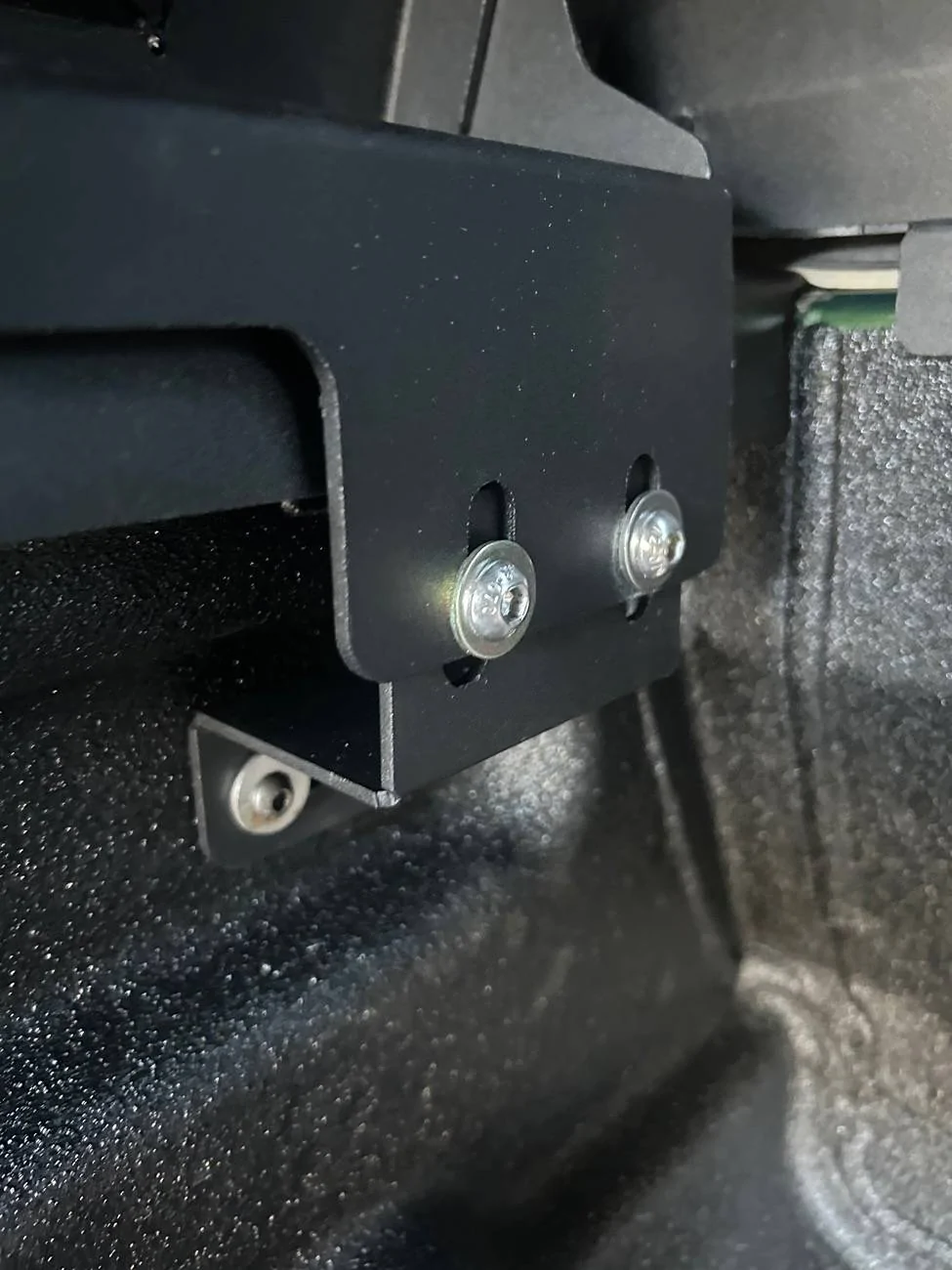

Gonna take off and try to redo the seal tomorrow.

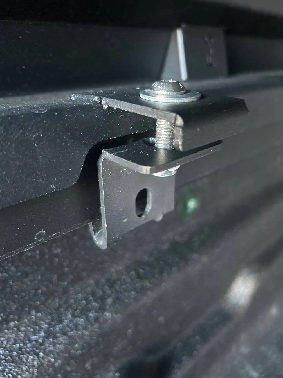

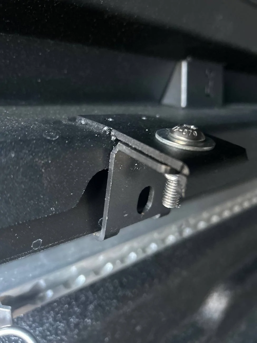

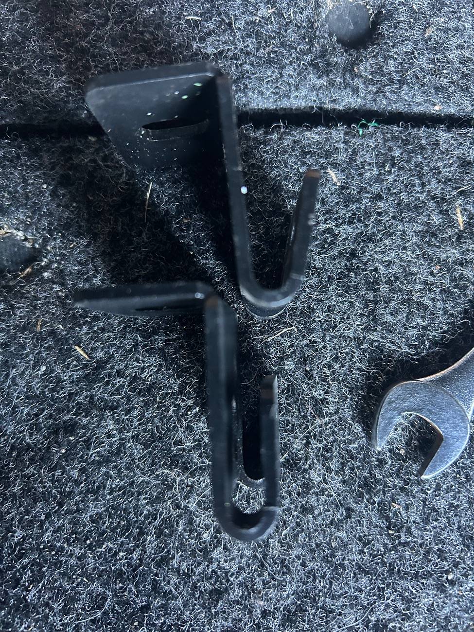

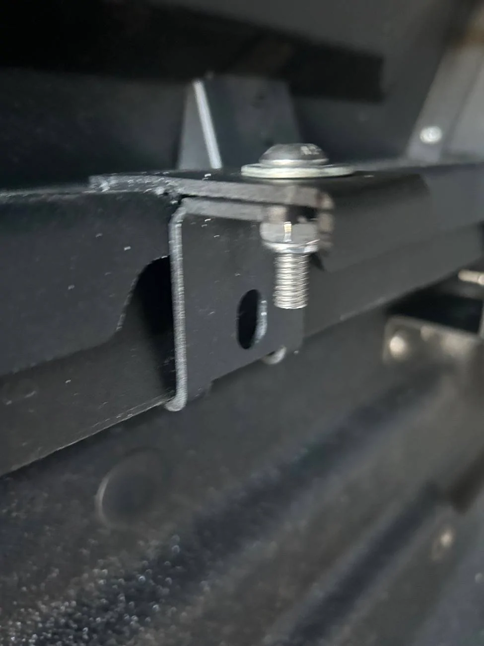

I “bent” the six tie downs in the middle, as they wouldn’t clamp down anything as the top hit the bottom of the topper, really couldn’t get them tight without what I did

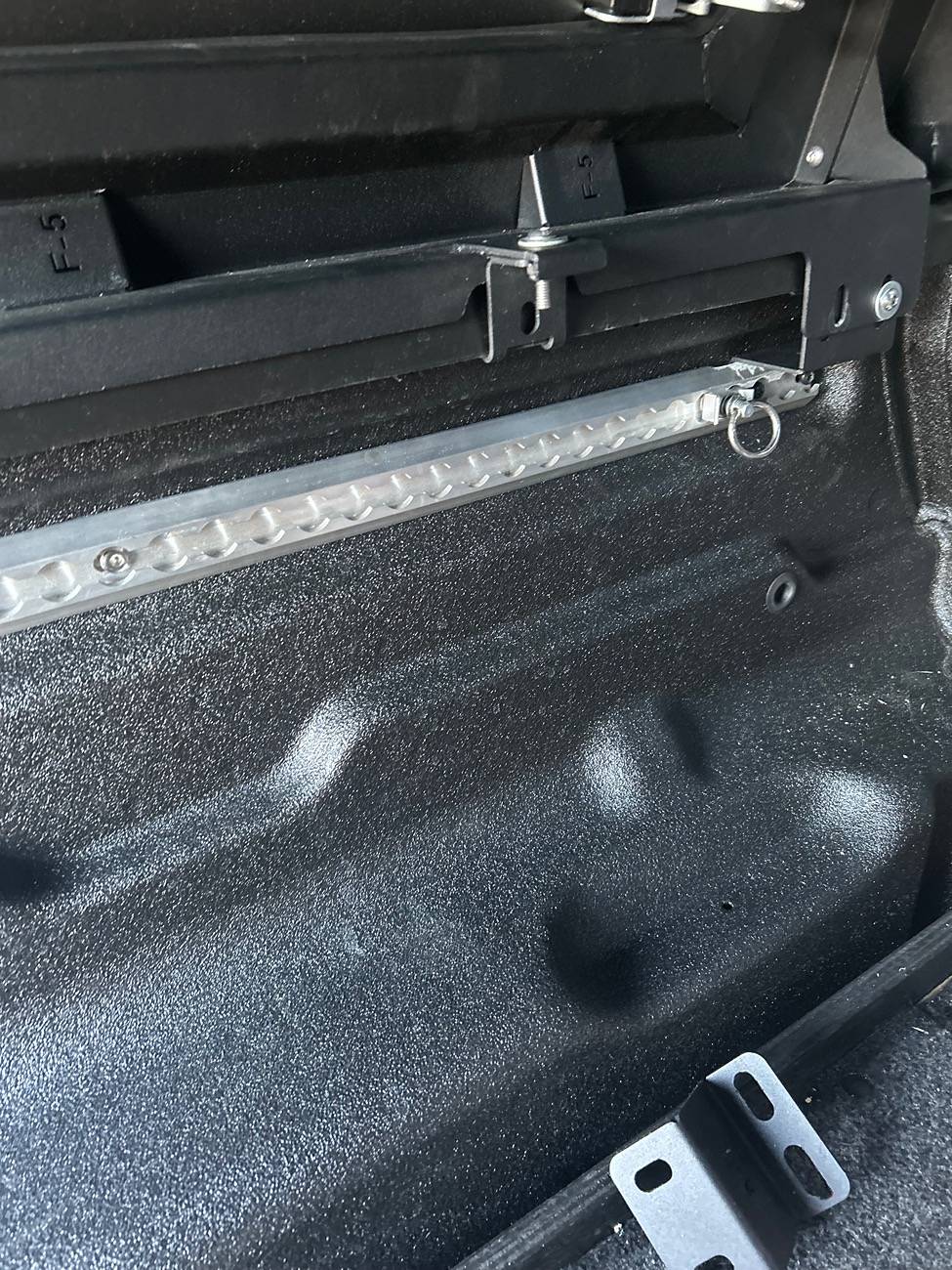

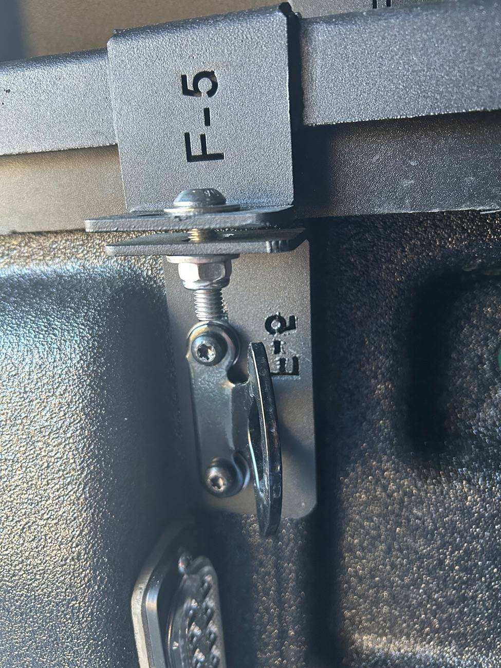

Got them tight and then took off the front clamp set up to put my tie down rails back in (required some modifications to get the holes lined up on both the tie down rails and the brackets: carbide bit on Dremel does wonders)
And now can only get one of the two bolts back in (holes misaligned) also have to hook up the brake light, but not sure about doing it since it’s a white and not red light? Might just hook it up to my cargo lights? Lots of pics

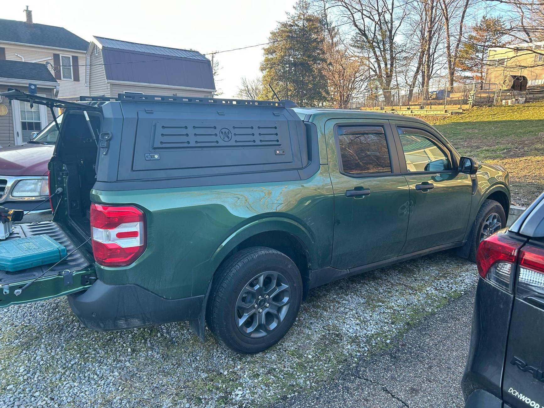

I think this is style you have?
AliExpress Maverick Topper
I like how the front of the topper is angled to fit closer to the rear window.
