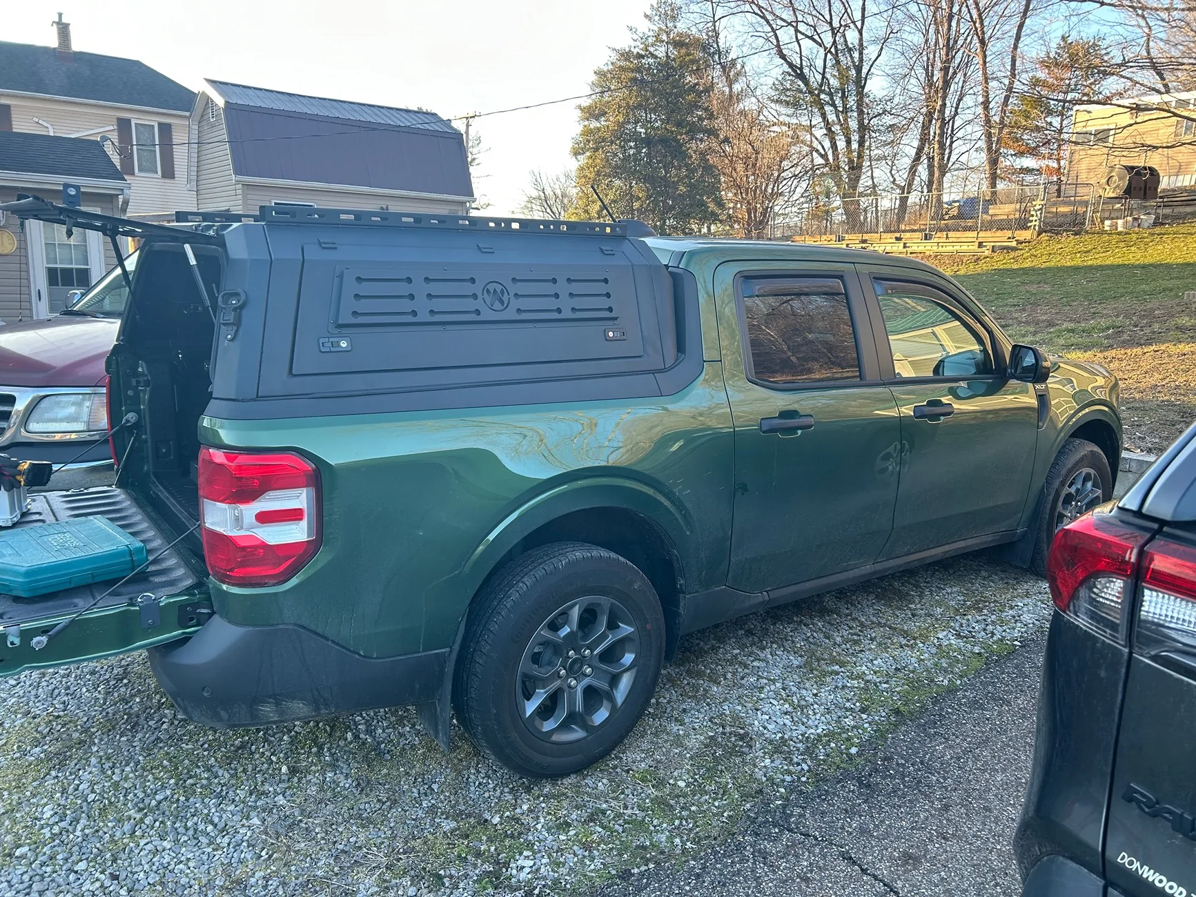

Does anyone know how much vertical space these toppers add?
Looks like Hank’s topper is a little different dimensions than mine? Taller but narrower?
I’ll try to get a height measurement and post it soon. I’d like to figure out a way for the back to open more, as it’s eye level when opened

It's the narrow width where the topper meets the cab where it goes south for me.
The picture on the Alibaba site that I ordered from was not as narrow as the cap I got. There was no way on the order form to specify exactly what I wanted in regards to that. I was clear it was a 2024 Ford Maverick. There is nothing I can do about it now, I can't send it back to China. I still like the cap though. Solid construction, very functional, and was very easy to put together. That angle of the picture make it look worse than it is. I attached a couple other views.

I'm coming up on a year with this topper, but have to remind myself that it was almost a year old when I got it (bought used). Still need to get it sealed better in the corners up near the cab, the weatherstrip on the rear door needs replaced, had a little tear on one side when I got it that has gotten worse, and there must be some sort of metal in the weatherstrip as it is showing some rust streaks. I haven't found a suitable replacement seal piece yet, and a couple of the LED's in the brake light have went out. Those are my only gripes about it.
