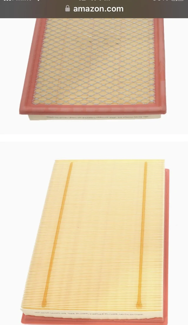

I replaced mine yesterday. I replaced with an "epauto". Are they any good? I will find out.
