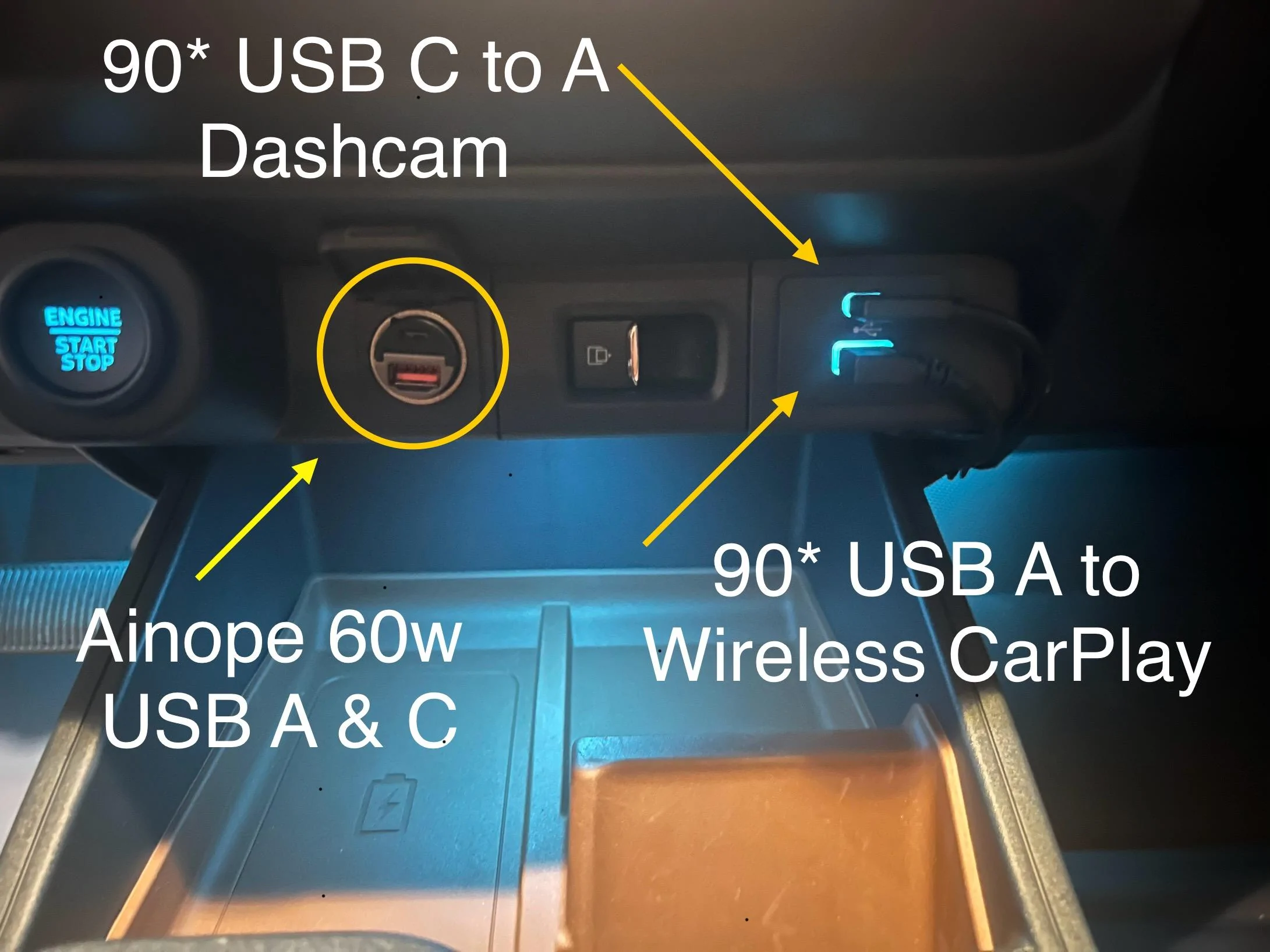

I use the USB A for wireless Carplay, and the USB C to USB A for my Dashcam. Charging is slow from those ports anyway, I recommend a better charger for the 12v port to dedicate to charging.
Ainope 12v Charger https://a.co/d/eYyc0tH
90* USB A Adapter 2 pack https://a.co/d/1P32fa5
90* USB C to A Adapter is no longer available, you will have to search for one
Wireless Carplay ( out of stock but worked well in my XL and now Lariat) https://a.co/d/8tkoyzn

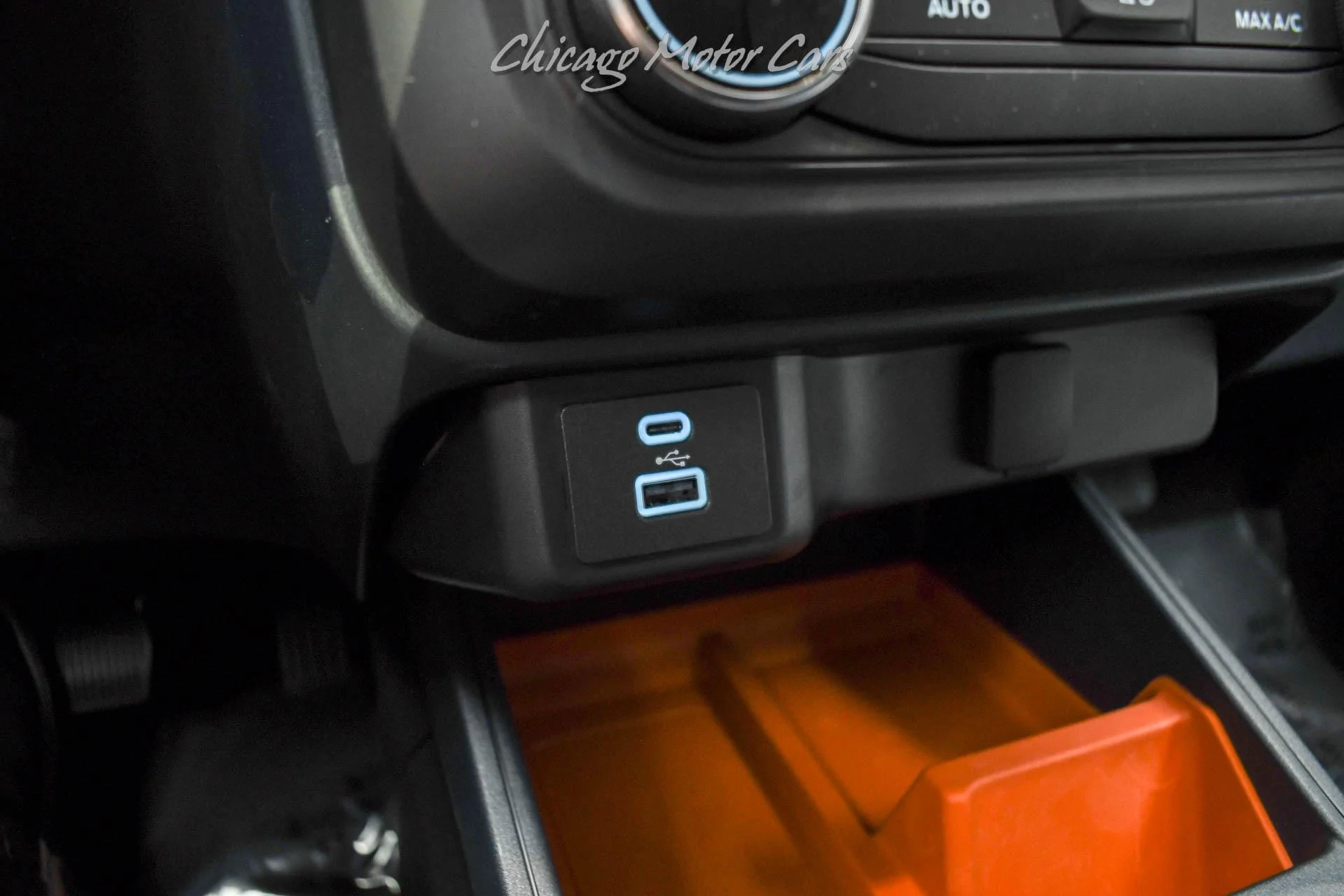

Plenty of room to install a new port. You can tap or add a fuse, as others have mentioned.
Pull front of panel downward, then pull towards you. Recommend a panel tool. It makes a lot of noise, but do what you're comfortable with.
This is exactly what I was looking for. I'll wire it to a ignition switched fuse in the cabin fuse box. Thanks!

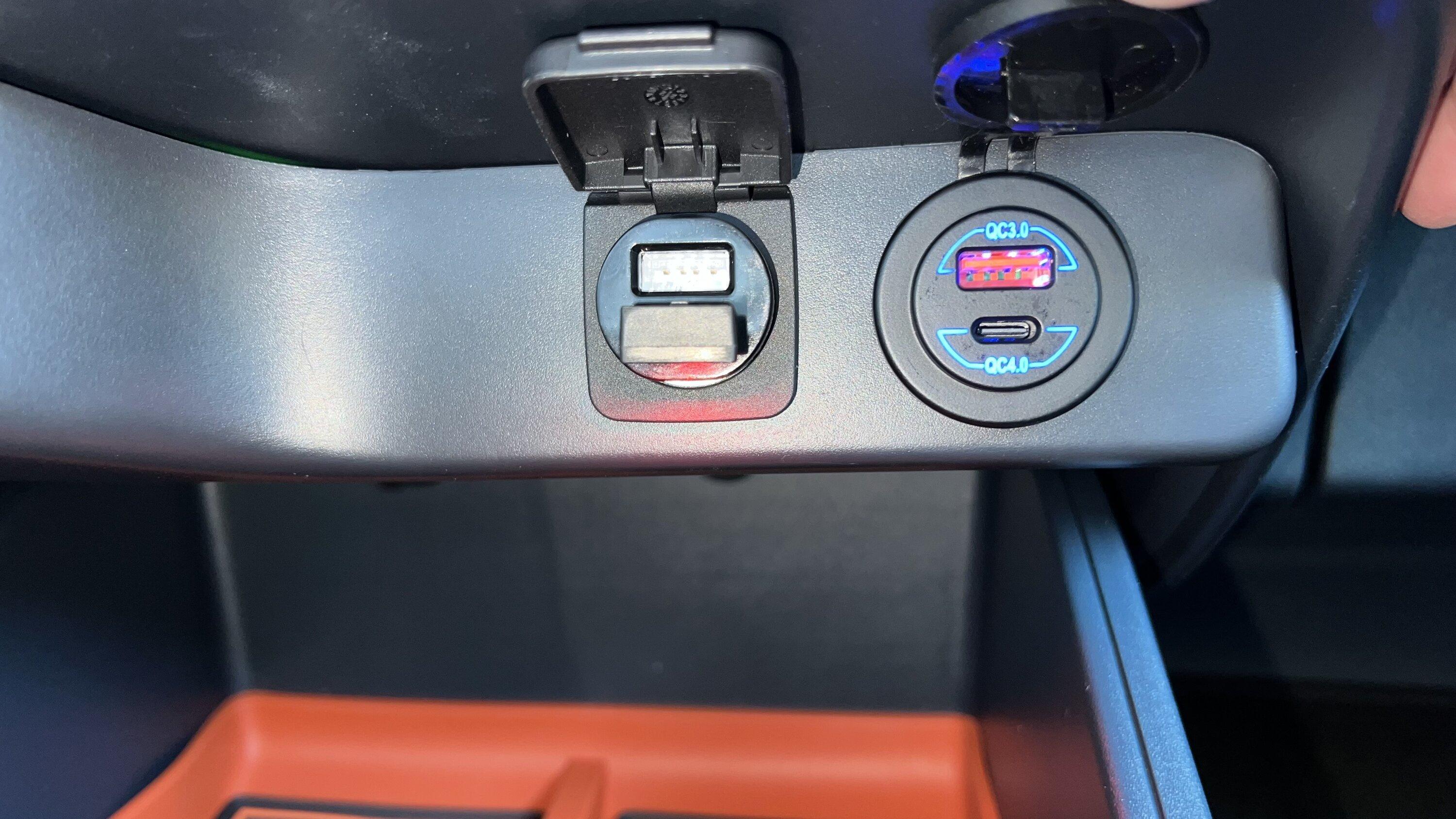

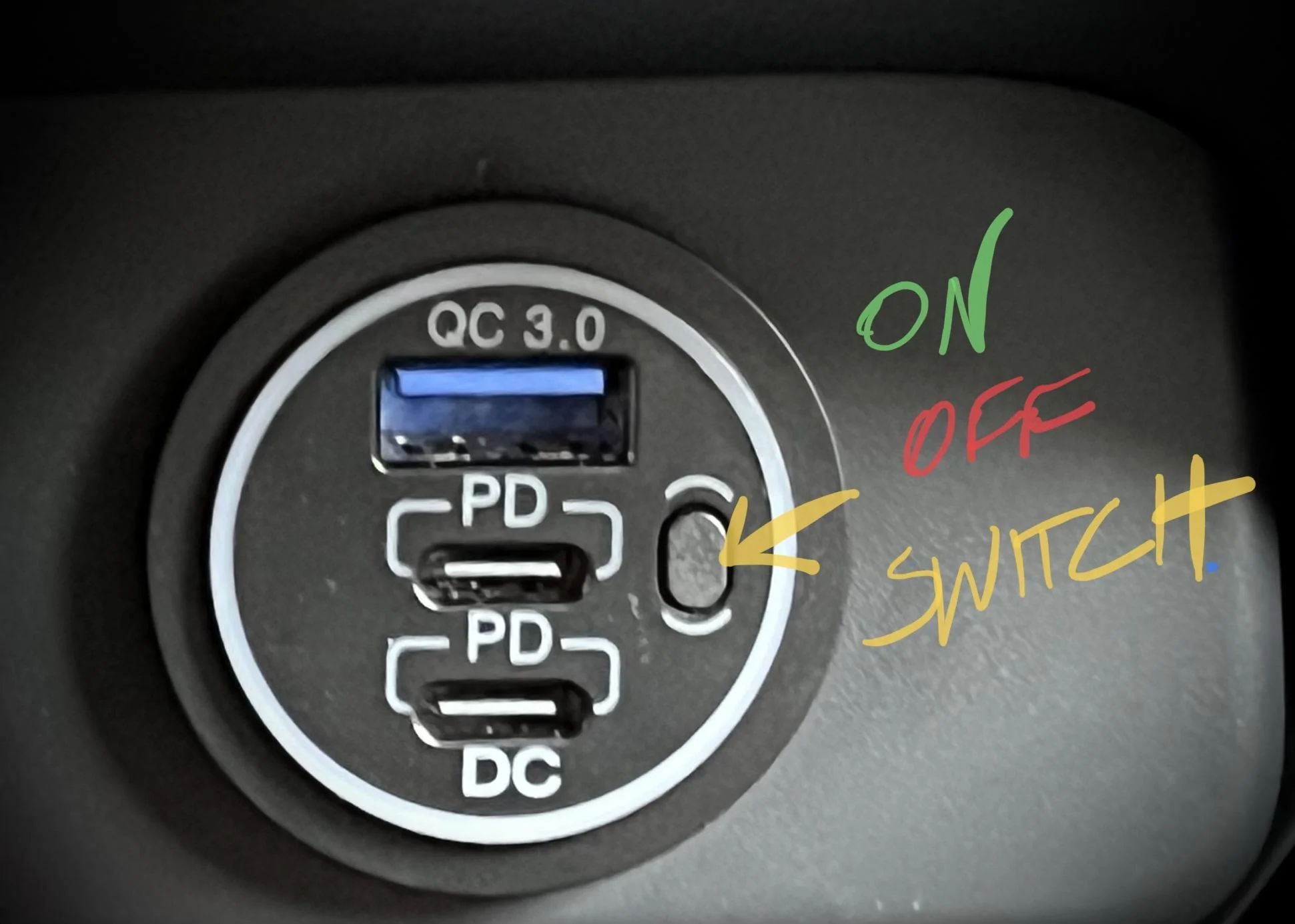

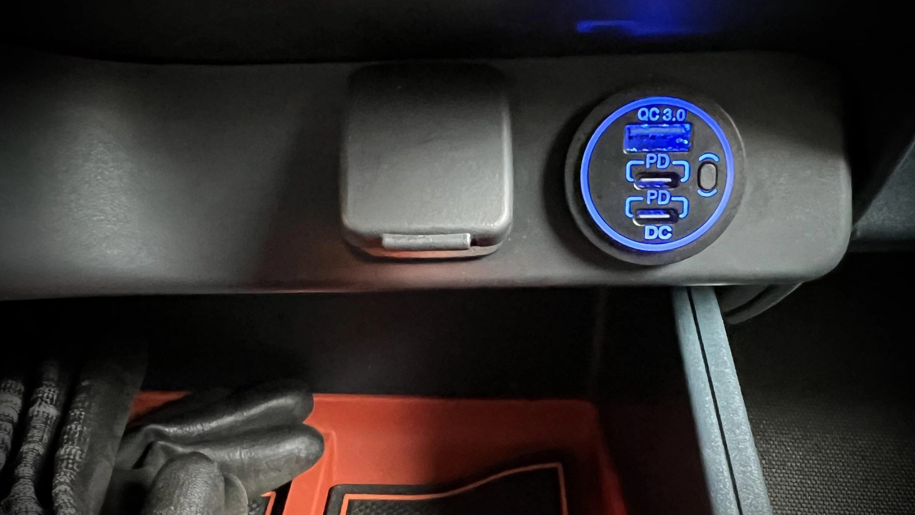

I changed it up a little...needed a few more ports. The ON/OFF switch is nice to have.
