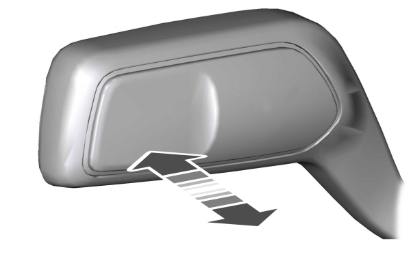

You may have been doing the presses that took you into and out of Auto highbeam.
Was a pull and hold able to keep them on - good test when you see it happening again.
OVERRIDING AUTOMATIC HIGH BEAM CONTROL
Ford Maverick A High Beam New One imagen2
Push the lever away from you to switch the high beams on.
Push the lever away from you again to switch the high beams off.
Push the lever away from you for a third time to switch automatic high beam control back on.

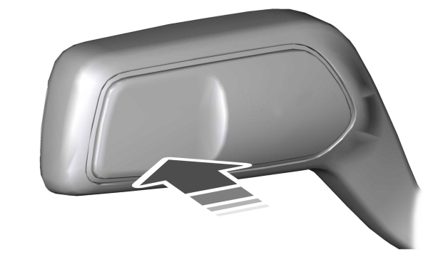

USING THE HIGH BEAM HEADLAMPS
Push the lever forward again or pull the lever toward you to switch the high beams off.
Slightly pull the lever toward you and release it to flash the headlamps.
Note: Continuous activation only with headlamps on.
