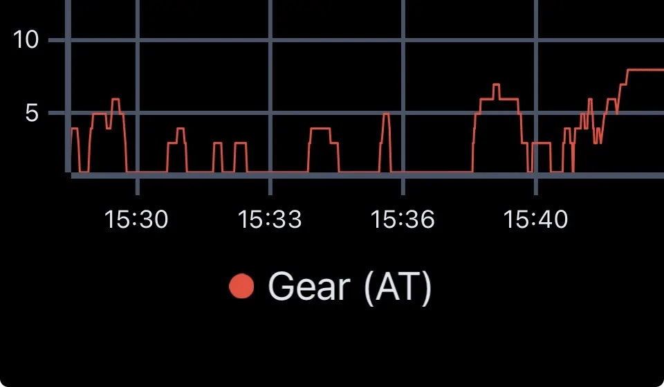

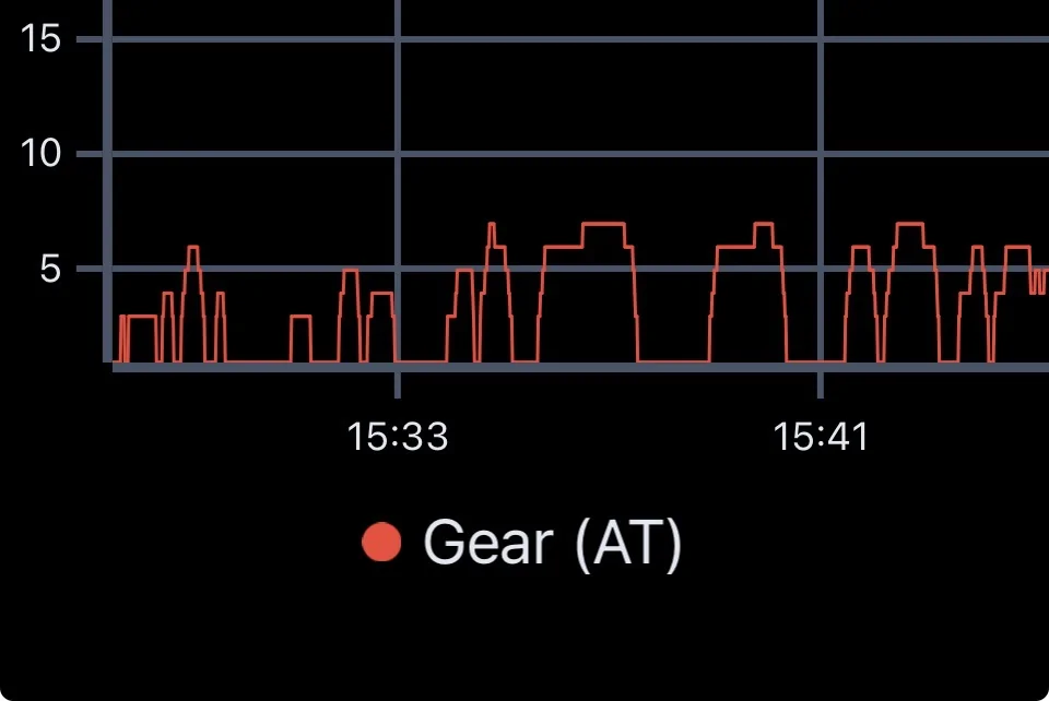

Sure and I watch the gears hop around in stop and go traffic on my car scanner app. Normal holds the gears longer so it doesn’t hunt as much.
thanks for the info. But that is exactly how eco is described in the manual. It shifts up or down sooner than normal. I only use ECO in bumper to bumper stop and go where 2nd is likely to be as high a gear as it will get. And the truck will not get over 10 mph. Normal scenarios I use, well, normal 😆. The braking effect of eco in gridlock works for me.

Correct like I originally said I feel it’s harder on your transmission to do all the extra shifts. If rather pay a few dollars more for gas than a new transmission.
Here is a similar drive leaving work same time and similar traffic. One normal one eco. One has a lot more shifting.
Not exactly perfect apples to apples but the best I can do with traffic patterns.
