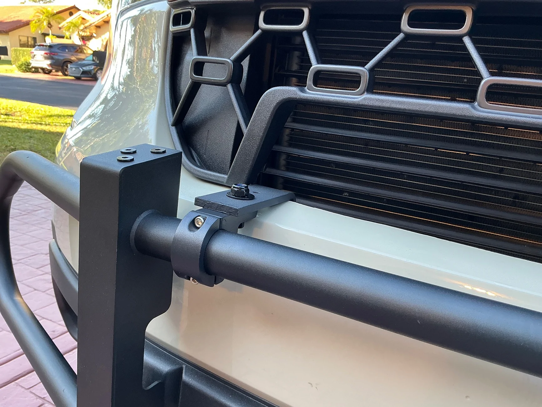

I was able to modify some Home Depot brackets and off road light brackets to add the Maxzina bull bar on my 2025 Tremor. The placement clears the parking sensors and ACC sensor. Finishing up tomorrow with cutting the bottom flush and making some lower brackets. Overall happy for a $200 project.
I went with simple brackets mounted to the rock shield. The @Maxzina bull bar is super solid. Not worried about the couple of degrees of approach angle lost. I did it for looks and partly because of all the old people in parking lots in S.FL that like to back up into cars in the parking lot as I always back in.

Like the purpose you stated.
Does it block the front tow hooks?
Hard to tell from the photos.

only if the angle of the snatch rope were upwards about 10 degrees, but the side hoops are removable so it will never be an issue.

Not trying to be rude, so is it only for looks? Those brackets are going to bend under minor force applied to them.

I jumped on it (~ 200 lbs) and no issues. The bottom brackets are support and 3/16”, the top is 1/4” bolted to the inner bumper with M8 fasteners. I don’t plan on ramming into things, but I am confident I could push another car without any bending. And if it does get bent at some point, then I’ll break out the welder and get some box tubing.

Wow!Thanks so much!After modification, it can be applied to tremor! Thank you very much for your modification and sharing. :inlove: :thumbsup:

Nice work!! I have thought about looking into adjusting mine to try to make it a little more ridged.

Wow that looks nice, I was actually considering something that protects the whole front end on my Maverick Tremor since I live in deer country but I was worried it would look dopey on a small truck like this, so I am leaning away from it.

I like that! It's not overwhelming the front.
