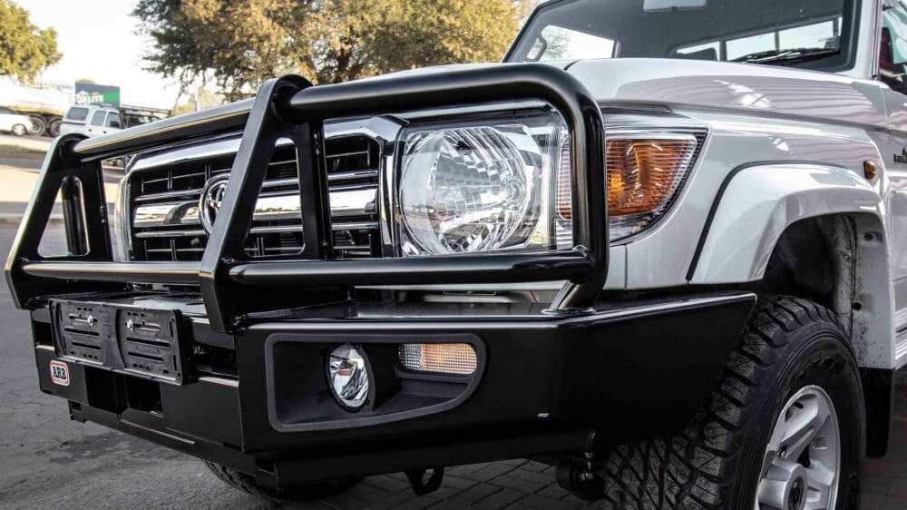

If you think these tiny 'bull bars' going to do anything about a deer you're nuts.
These are about looks and aren't anything close to a real bull bar.
People have to stop confusing these tiny things with these:
Ford Maverick Maxzina Bull Bar Modified to fit 2025 Maverick Tremor ARB-Flared-Winch-Bull-Bar-Land-Cruiser-70-Series-6-scaled-1-3441594884
hardly anyway to get a real firm attachment on a "Maverick" consider this if you run into somebody and it can be proven your alterations contributed to the injury or death of the victim,a real shrewd lawyer could take you to the cleaners,these things are designed to be sort of pedestrain friendly at least the newer models anyway.just saying before you create a juggernaut.

if you hit a solid object at 50 mph you are going to be hurting,no the Toyo wont survive either,these are actually glorified brush guards only useful in low mass soft impacts and the occasional overrunning of brush and brairs,good place to mount a winch or towhooks( looks nifty as well-a "Ranch hand has heirloom quality)
I live in South Florida, the only thing we have to worry about hitting here are Bentley's and old people at Publix Supermarkets. Both of which I am confident the Maxzina bull bar can withstand ;)
