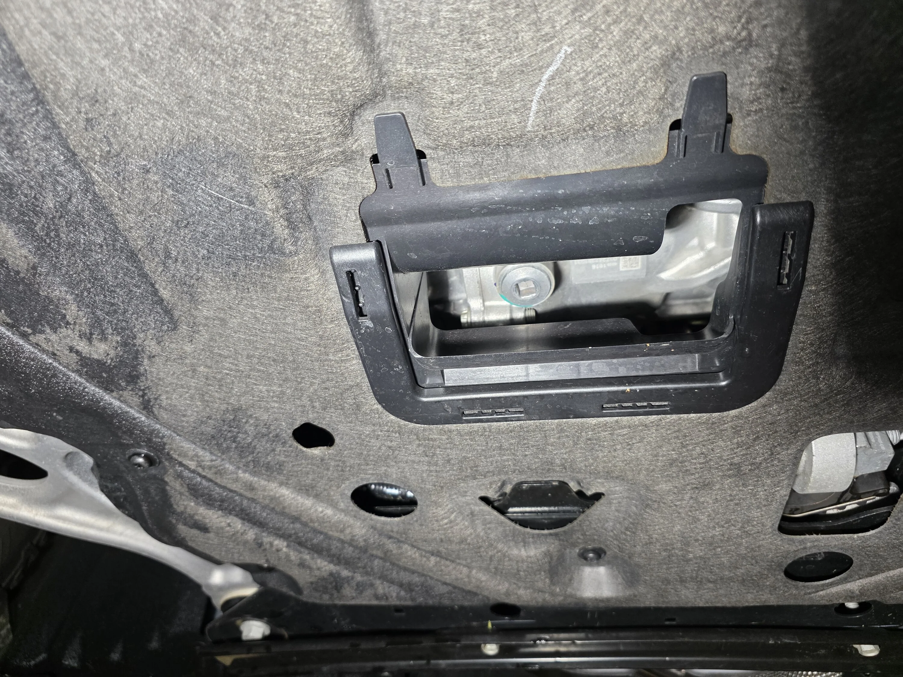

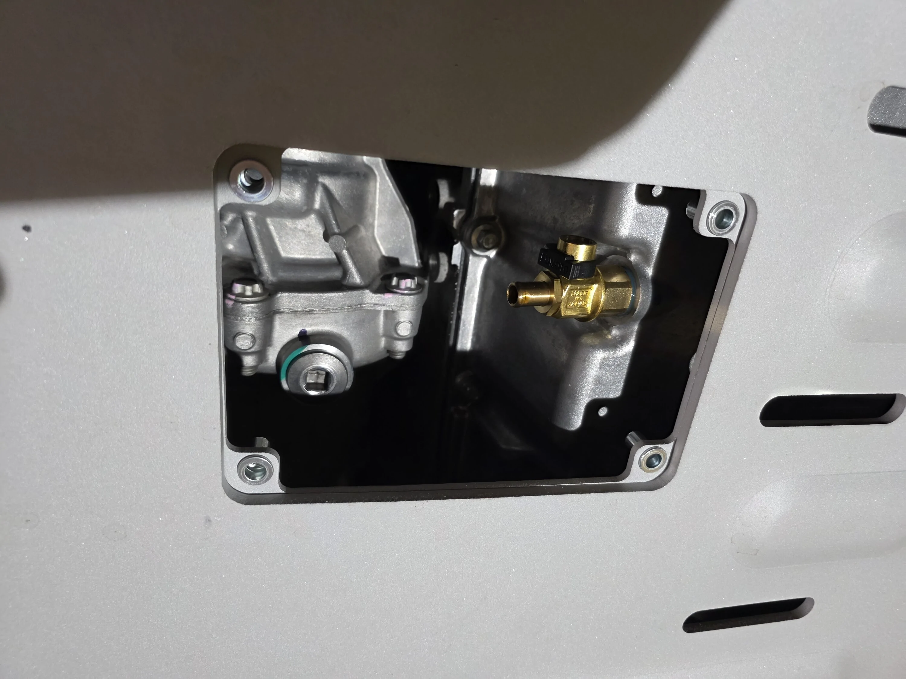

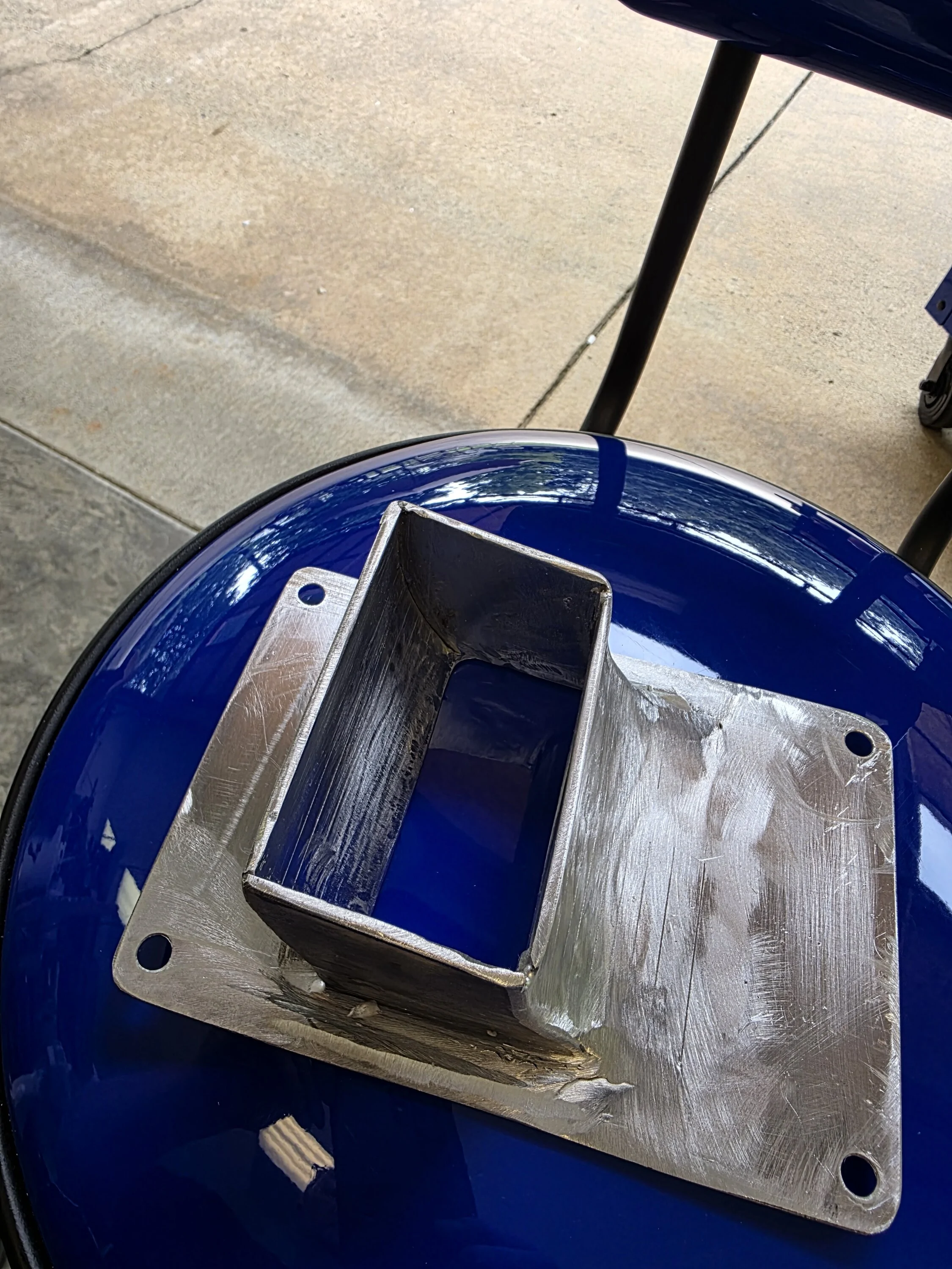

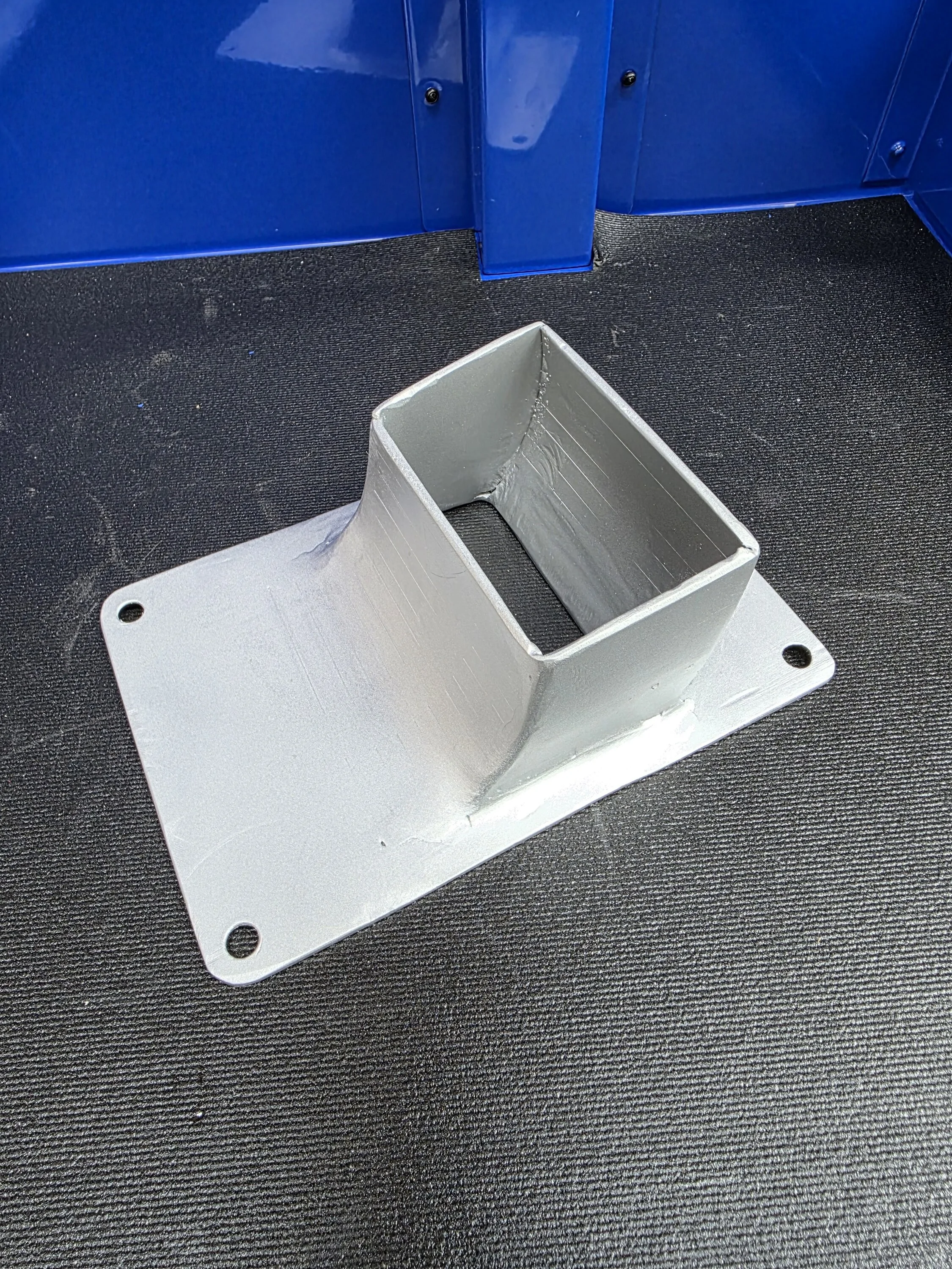

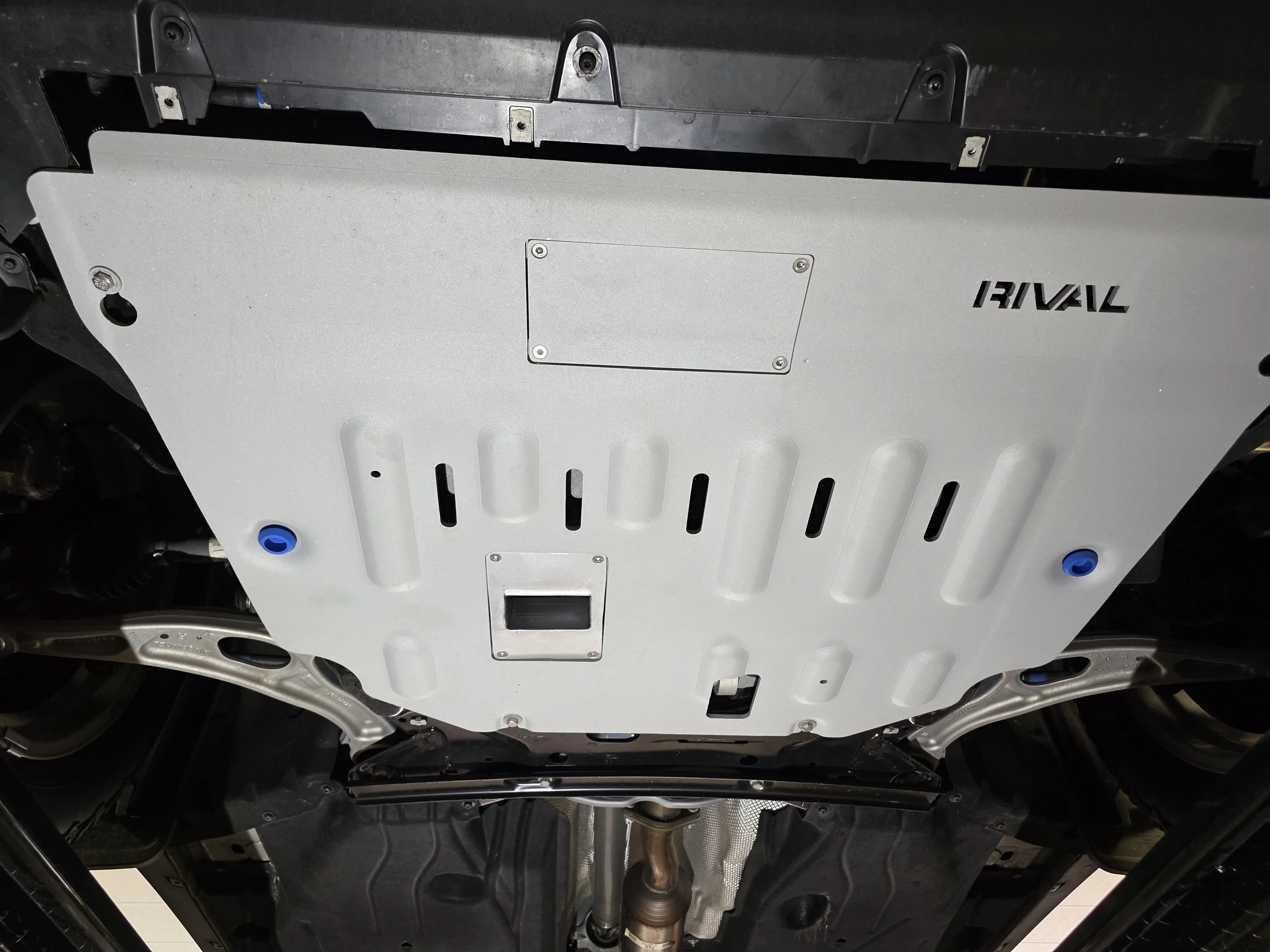

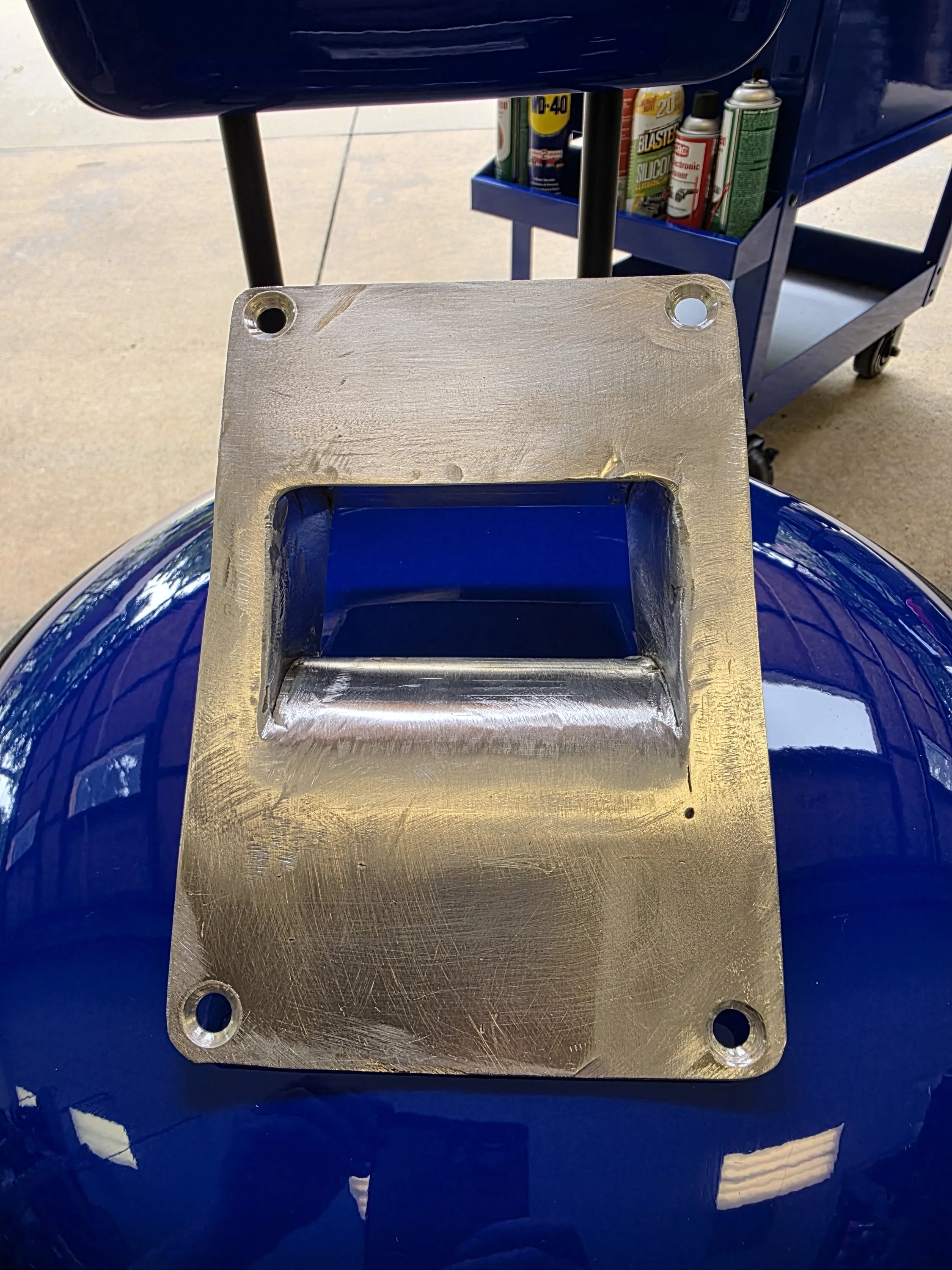

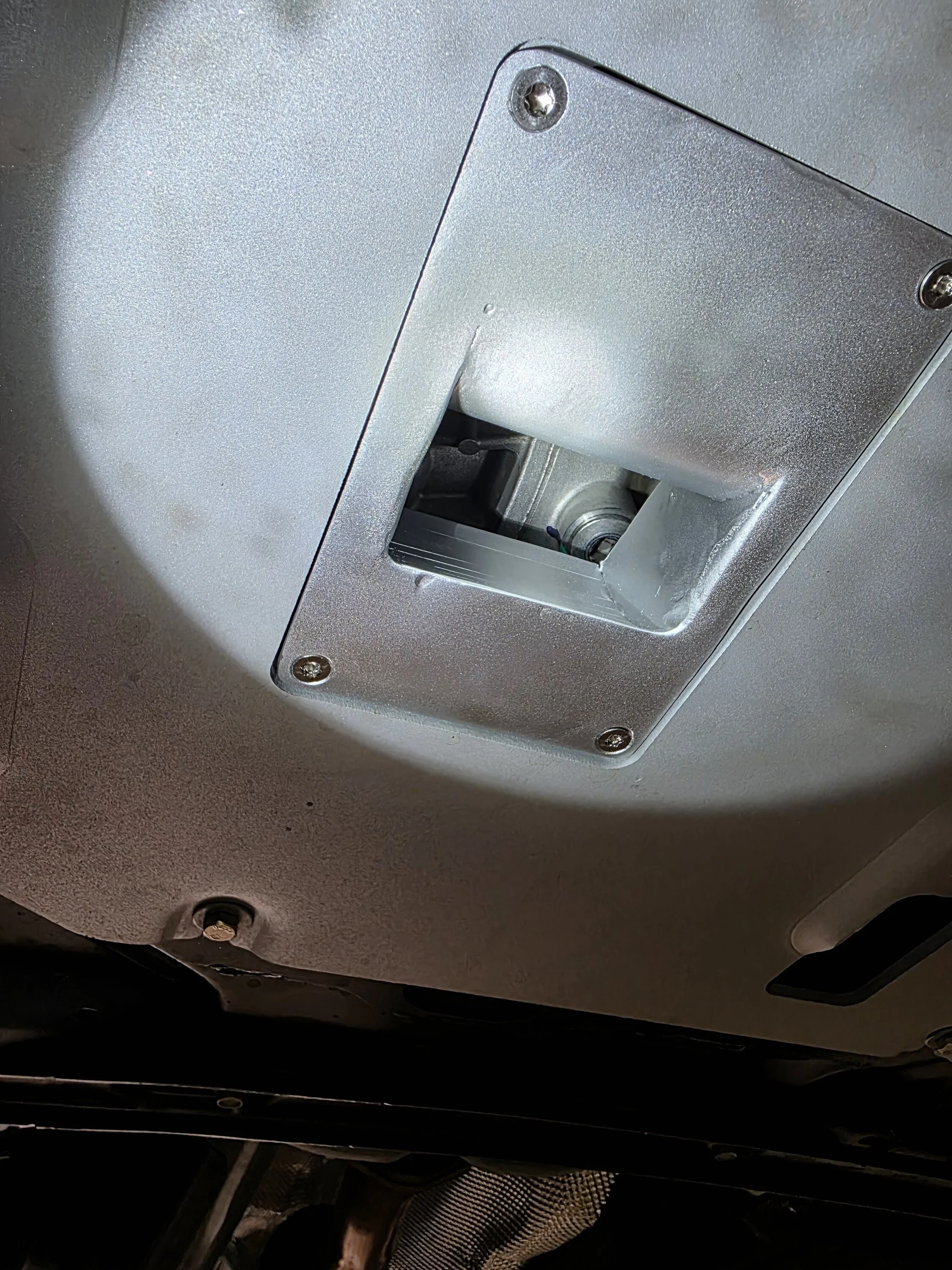

So, I once again spend way too much time on a project. I figured that if Ford was still spending an extra dollar on the AWD PTU air scoop on the factory felt belly guard, Ford must feel it's VERY important, especially given that Ford now feels that logos and a keypad are a bridge to far for a vehicle they've raised the price on 8K in just 4 short years.
I also changed the oil in the PTU and the RDU while I was at it.

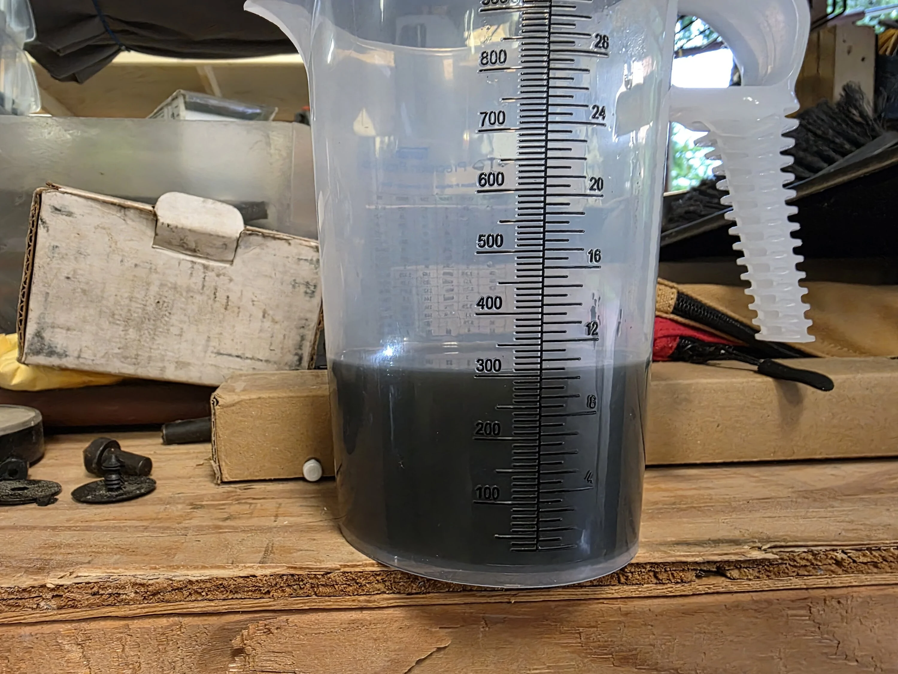

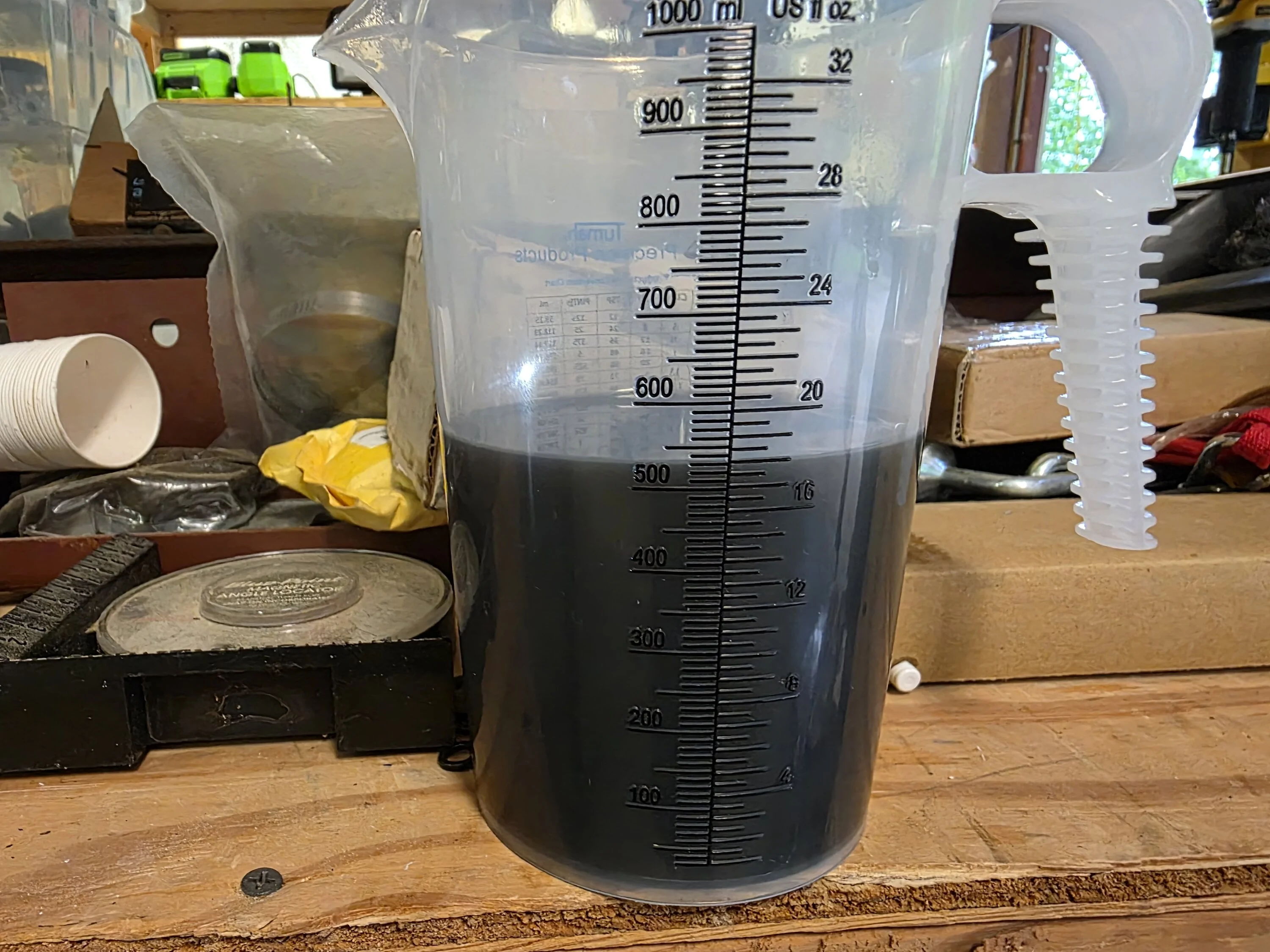

As many others have discovered, the PTU was WAY underfilled and was full of both solid metal flakes and a great deal of oil suspended metal partial. The RDU was nearly full and in a condition of about what I would expect. This project was done at about 5K miles.

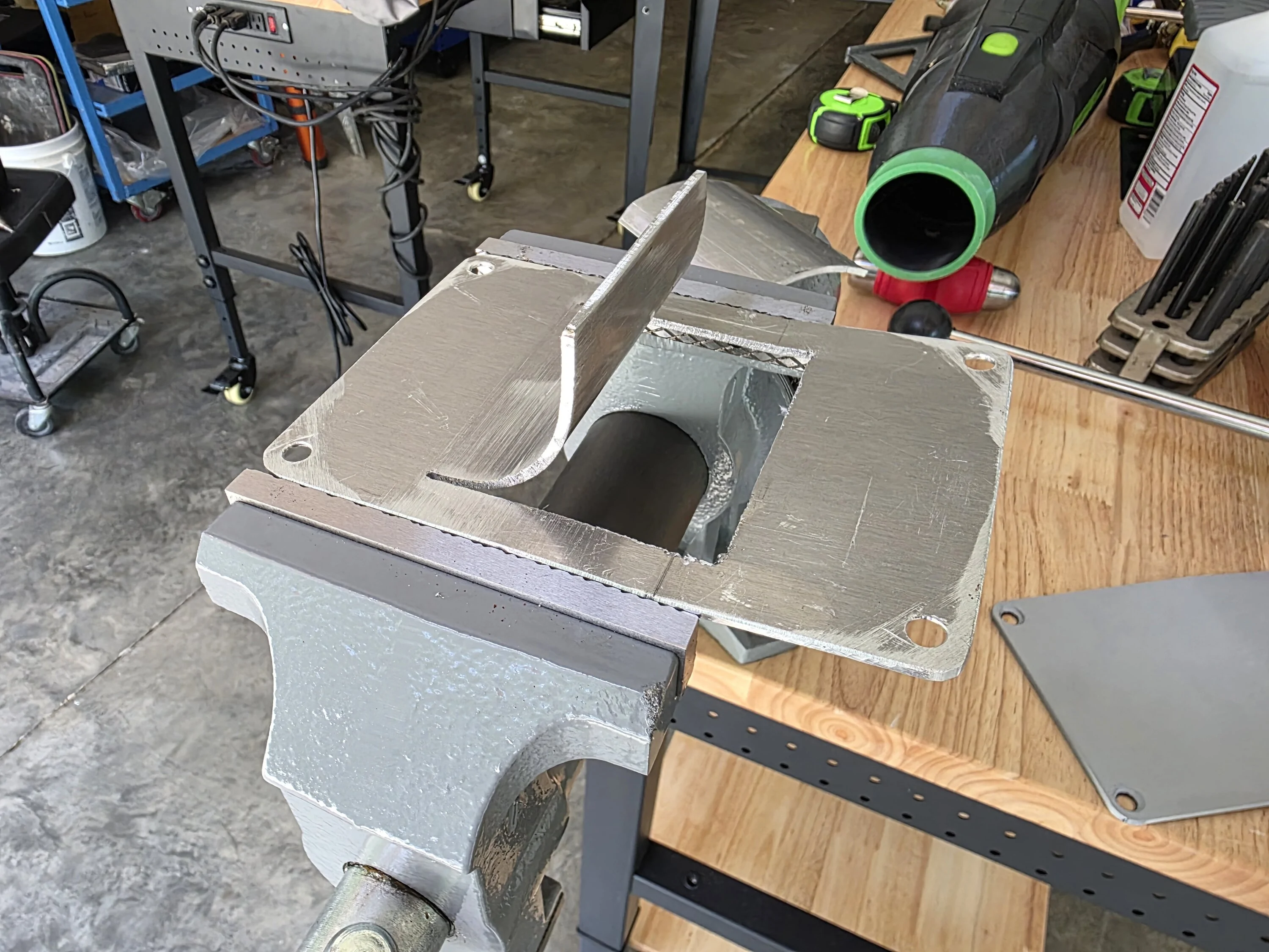

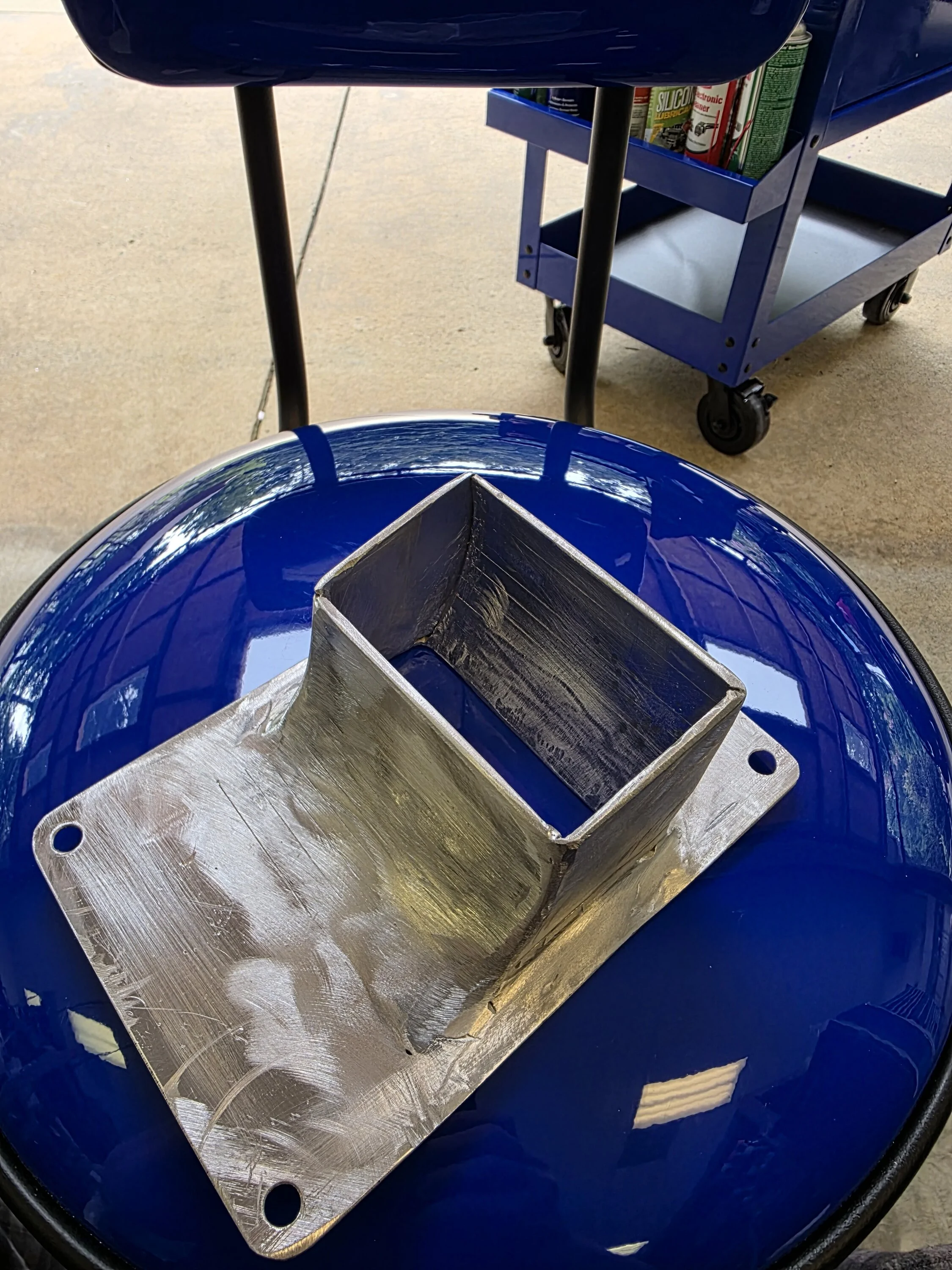

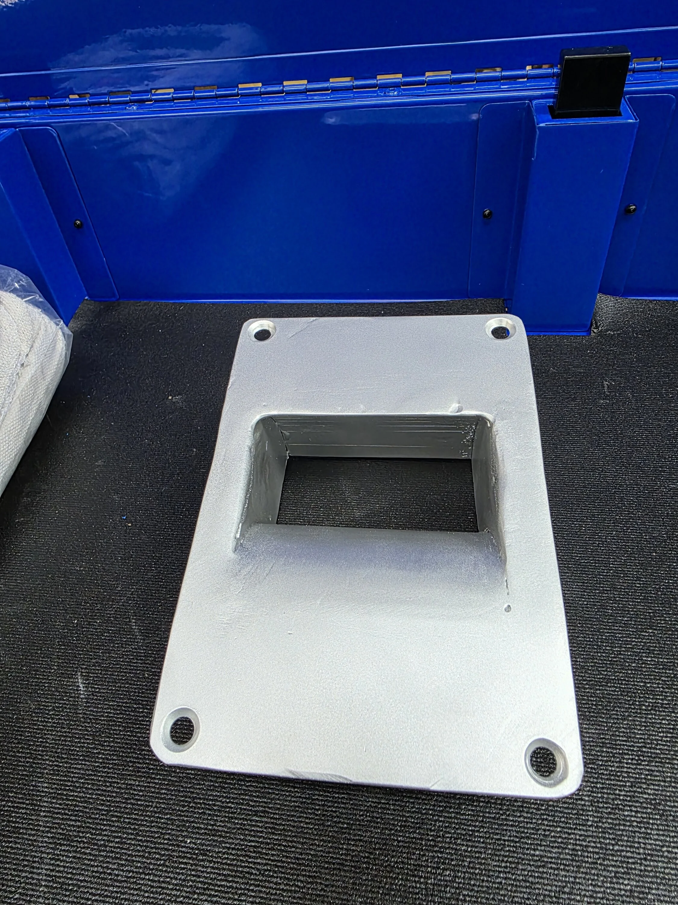

Please note that I have not tig welded in about 40 years, and 40 years ago, I wasn't that good at it either (and it shows). While it's not that pretty, I think it will function well. Someone with plastic 3D printing knowledge could probably do this in a fraction of the time.

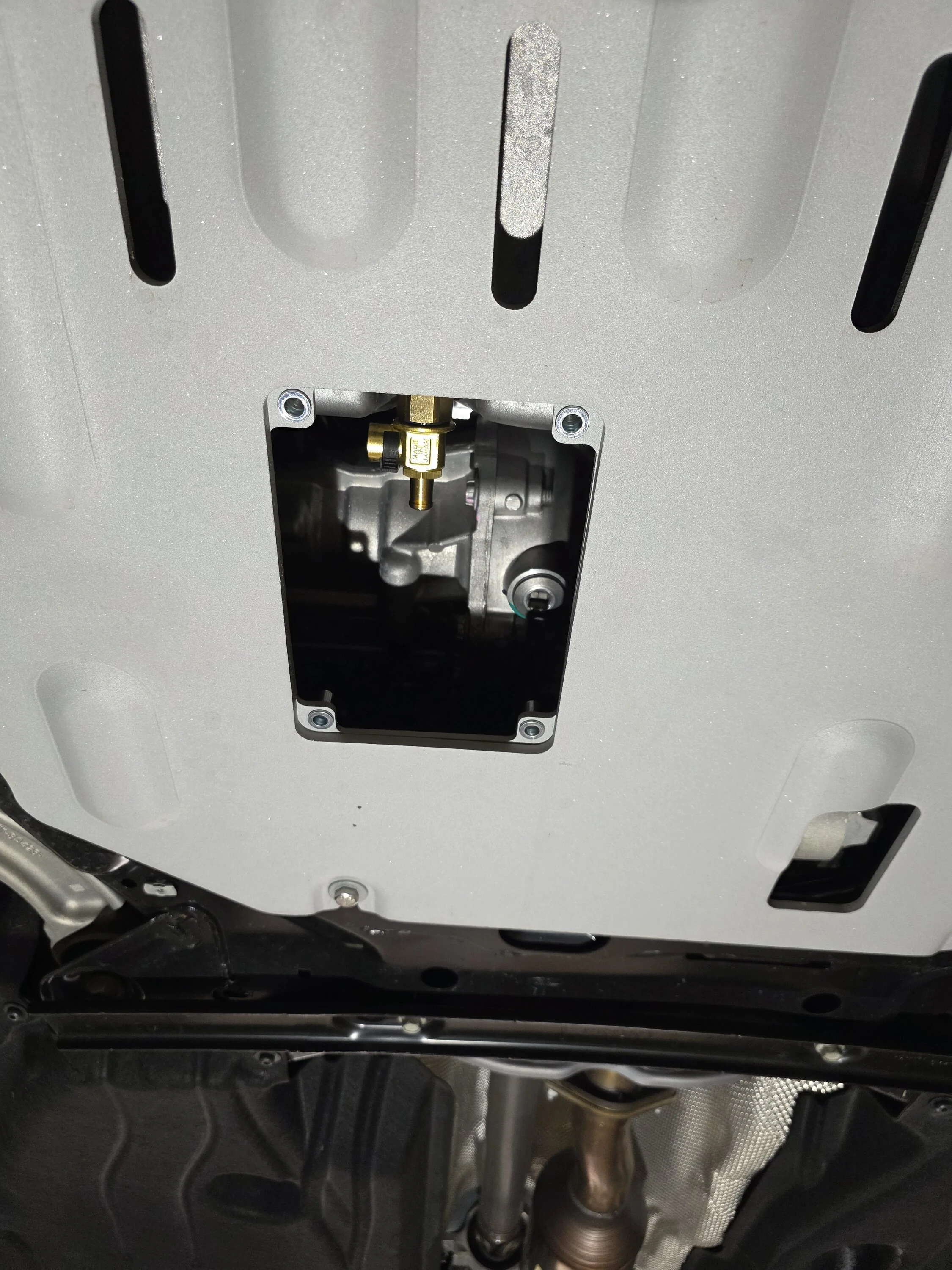

During this process I also installed a Fumoto 1/4 turn quick change oil drain, as I don't want to clean up a mess after changing the oil and I don't want to remove the RIVAL skid plate during the process. The RIVAL pan install was quite easy (I have a car lift) and the rear bolt threads were already in place.
Ford Maverick RIVAL skid plate PTU cooling scoop DIY - 2025 hybrid AWD 4K Tow. original belly gaurd

Ford Maverick RIVAL skid plate PTU cooling scoop DIY - 2025 hybrid AWD 4K Tow. PTU oil
Ford Maverick RIVAL skid plate PTU cooling scoop DIY - 2025 hybrid AWD 4K Tow. RDU oil
I agree. Although I don't have experience on the Maverick AWD PTU, my experience with the Ford CD3 platform PTUs tells me that they need all the extra cooling they can get. The Dorman OE Fix Ford PTU has a heat shield to help reduce the PTU temperature.
I am sure that your TIG-welded piece will outlast anything that a 3D printer can make out of plastic.

Okay, I’m a worrier and over-thinker. I have a rival skid plate. Should I be concerned about the PTU getting too hot? .

My grinding and sanding skills made up for my tig welding skills. but I even got tired of tig filling and grinding, so I stopped at good enough.
It's hard to say, I guess only time will tell. I just didn't want to take the chance, given that Ford thought it was necessary I feel, or they wouldn't have spent that extra dollar.

I haven't heard anything stating they will. An aluminum one like I built would be hard to justify for the cost ( material was cheap, but the labor would be outrageous) I think a 3D printed plastic one would be cheap enough if anyone with those skills wanted to take it on.

Nice work- So its been reported that the stock plastic scoop is not orderable thru Ford- Lowest hanging piece on a steel skid plate is pretty silly- I had to JB weld mine back together after a belly scrape.
