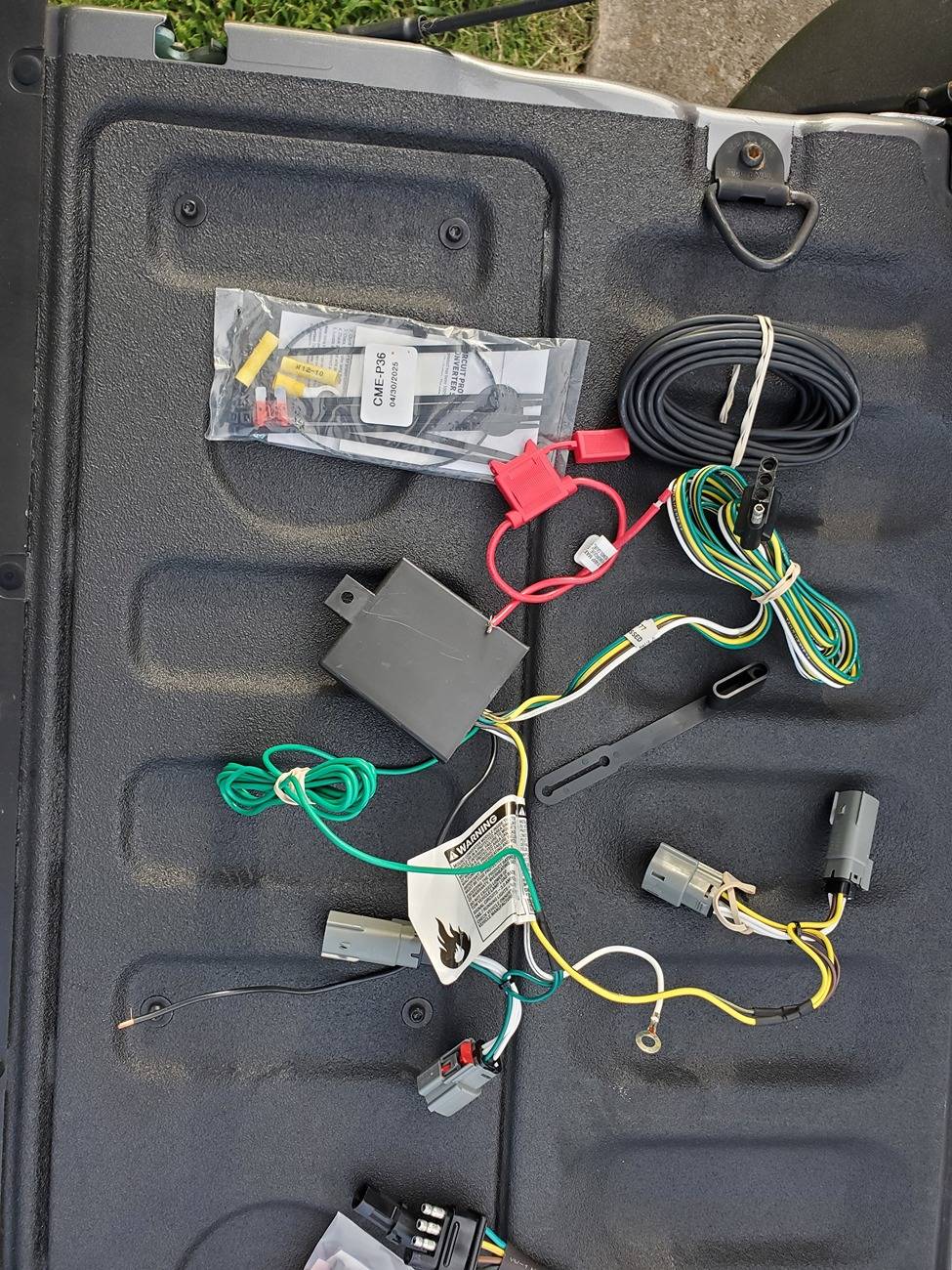

  • Plug the Putco 4-pin plug into the 4-pin trailer jack. Turn on the left turn signal (driver’s side) and identify which of the two bars are for that side (blue painter’s tape marked as driver). Repeat for the right turn signal (passenger’s side) and mark it as passenger. Remove Putco light strip from the Maverick’s 4-pin jack. (This was a hard lesson that caused me to spend way too much time redoing cable routing. And yes, the truck thinks you have a trailer attached.)

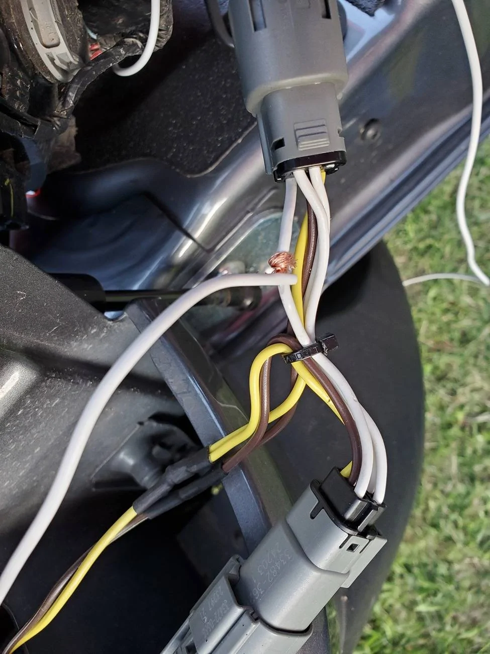

  • On the driver side Curt adapter there are three white pass-thru wires connecting the two plugs. If you want backup/reverse lights, you will need to tap into the wire going to pin three. I tapped into the Curt rather than the actual reverse light, since the whole reason for buying the Curt harness was to not mess with the factory wiring. I used a length of 16-gauge white wire that I eventually tied to the Putco light bar. Do it now so that in the next step it can be pulled thru with the Curt plugs.

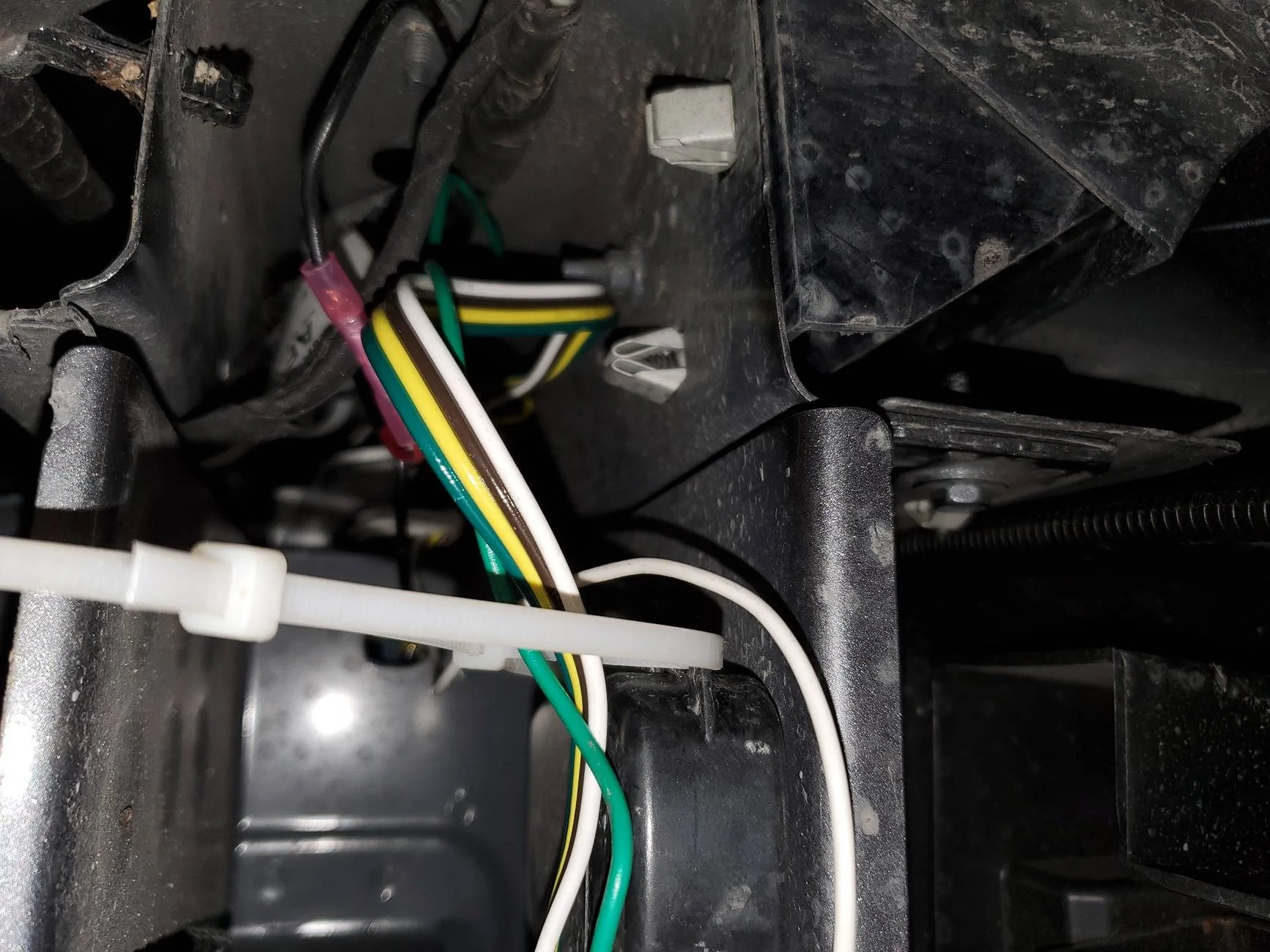

  • Remove the rear passenger wheel cover to aid in routing the green cable from the Curt harness and the Putco passenger side light bar.
  • Remove and unplug both taillights.

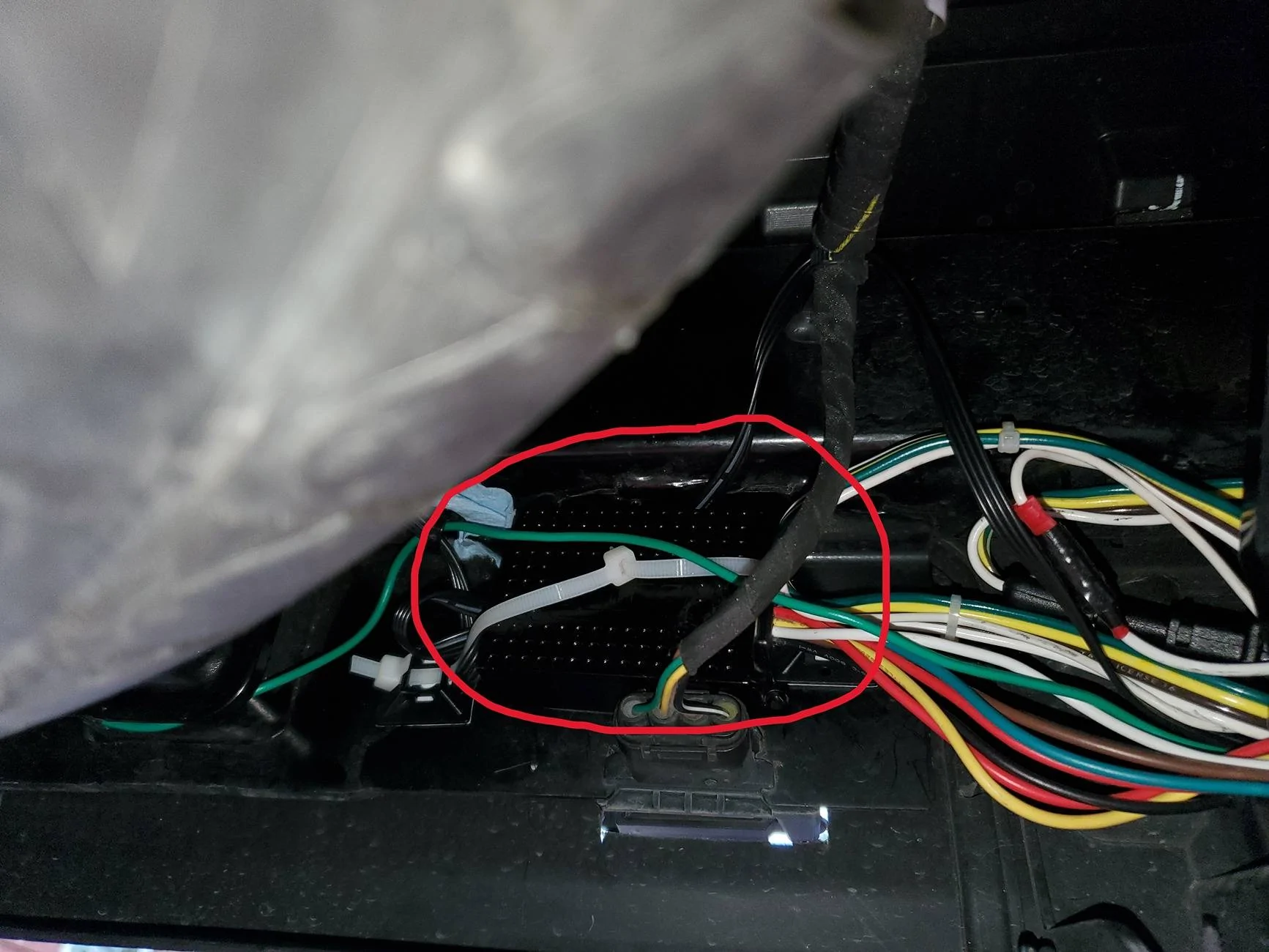

  • Using a fish bar, fish tape, or a long string with a nut tied to it, drop it thu the fender assembly until whatever you are using hits the ground. Attach Curt plug and fish it up thru the fender. Plug the Curt plugs into the wiring harness and taillight.
  • Reinstall the taillight. Repeat steps 5 and 6 for the other light.
  • As a temporary solution for power (did I mention it is hot right now) I used the driver’s side 12-volt Flex Bed pigtail (I finally found a use for the one that came with the truck.) Eventually I plan to have a direct run to the internal 12-volt battery. The only downside I can see at present is that the light bar will stop working at some point when the truck is turned off.
  • Light Bar Placement: As previously mentioned in above thread, post #20 by Truckhef, if you try and place it on the flat metal part directly above the plastic bumper it will be hard to see. So, I ended up fastening (3m magic tape) to the curved part of the bumper all the way in the back.
  • Attach white reverse lead from the Curt harness to the white lead of the Putco light strip (If you want reverse lights.)
  • Plug the Putco light strip into the Curt harness and except for cleanup you should be golden.

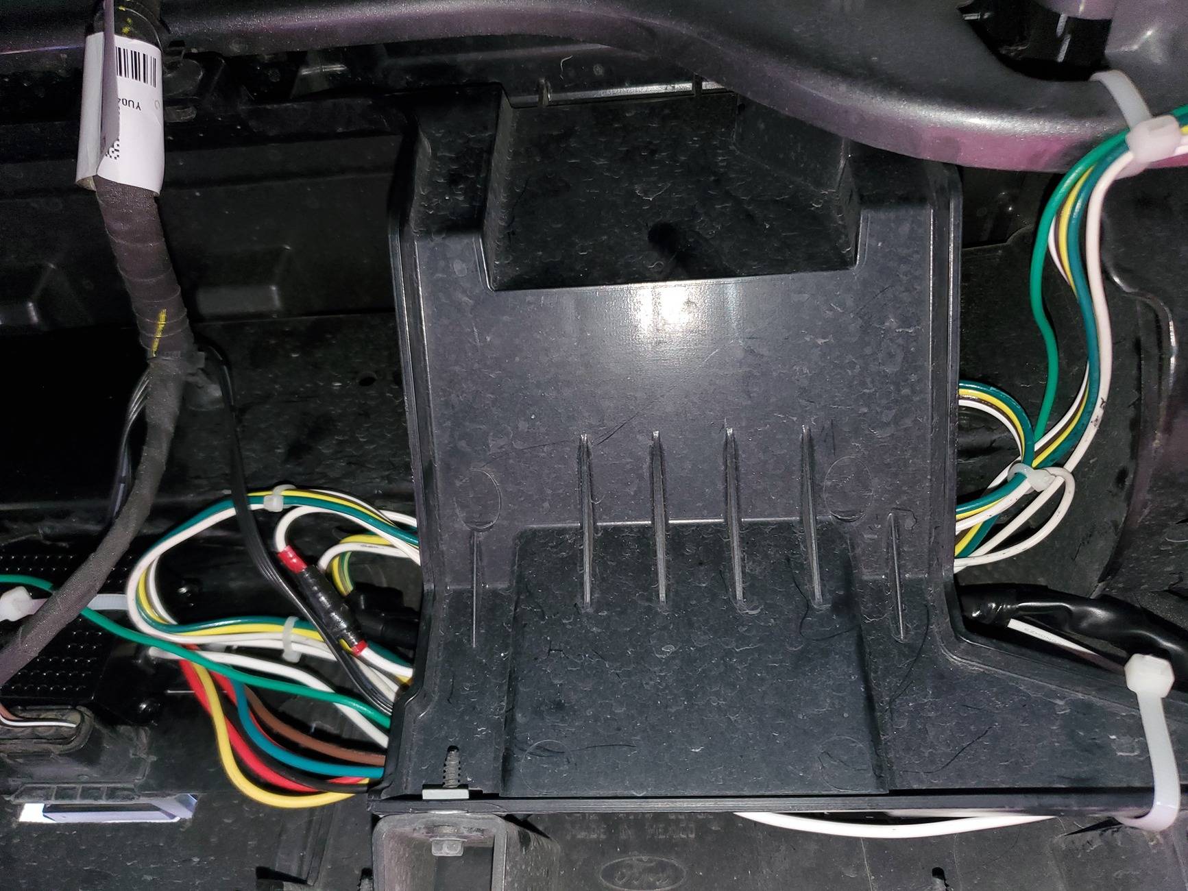

  • I crawled back under the truck and did my best to put everything back and make it neat. I discovered the Putco 4-pin cable/plug is way, way too long. So I removed a few feet of it.
  • Placement of the Curt and Putco control boxes I leave to you. I put the Curt unit in the driver’s side fender and the Putco control unit on the flat surface above the factory 4-pin plug using 3m tape and tie wraps.

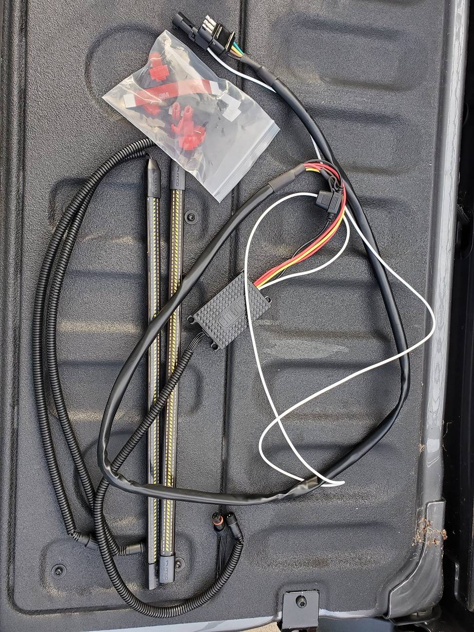

Ford Maverick Putco 18" X2(Pair) Led,92009-18/Curt Manufacturing 56477 Taillight Installation 20250627_192329
Ford Maverick Putco 18" X2(Pair) Led,92009-18/Curt Manufacturing 56477 Taillight Installation 20250627_192337
Ford Maverick Putco 18" X2(Pair) Led,92009-18/Curt Manufacturing 56477 Taillight Installation 20250628_174059
Putco Light Bar 92009-18 -------- Curt Harness ---------- Putco left/right identified

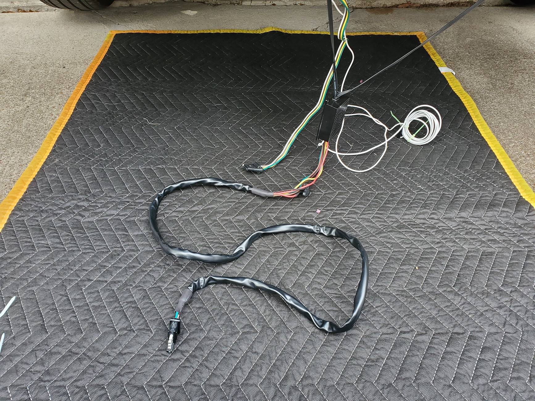

Ford Maverick Putco 18" X2(Pair) Led,92009-18/Curt Manufacturing 56477 Taillight Installation 20250628_200259
Ford Maverick Putco 18" X2(Pair) Led,92009-18/Curt Manufacturing 56477 Taillight Installation 20250703_174127
Taped Curt for Reverse. Yes, I ------- Putco cabling was way too long, so I shortened it
properly connected this after
testing

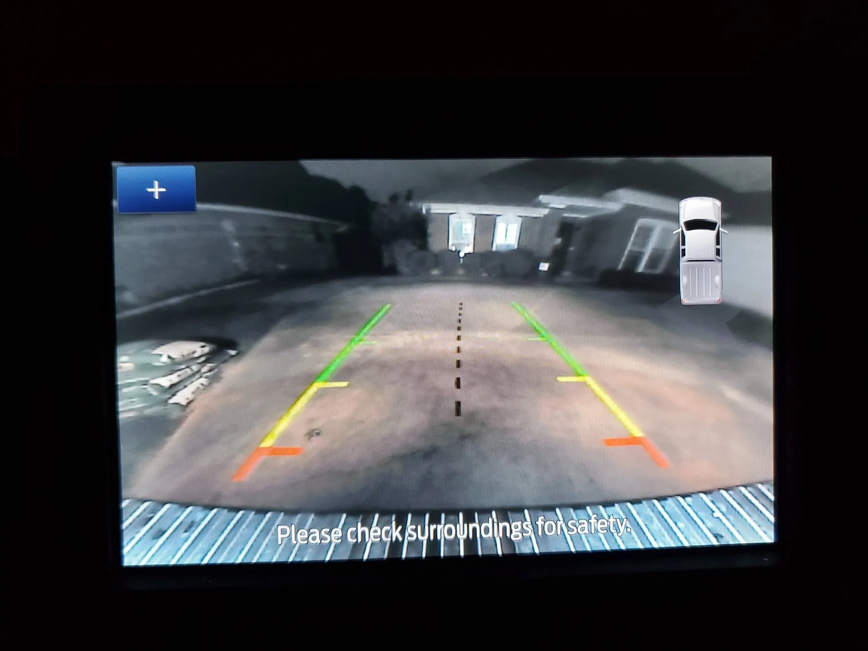

The back-up light looks darned helpful!! šŸ˜† but does the bright light under the camera wipe out any ability to see with the back-up camera???

Beautifully done.
I may want to save this so I can look at your great wiring job later ;)
Had to wait until it got dark so you could see it in all its glory.
