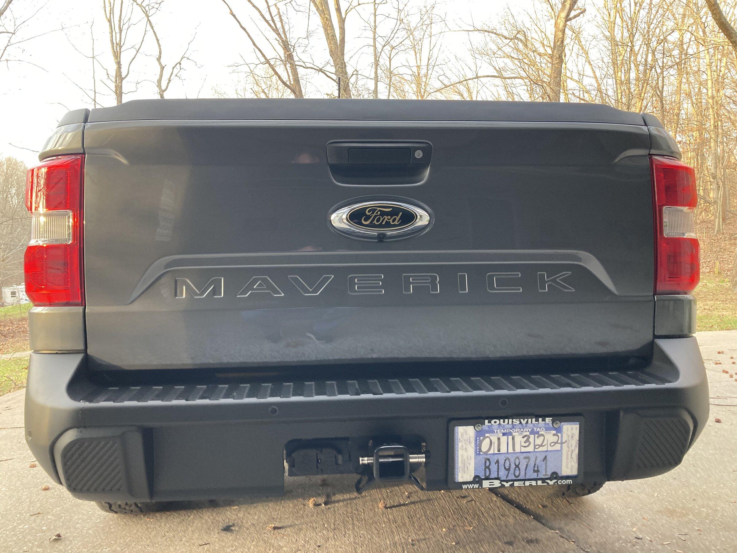

I was looking at the rear emblem this morning. I did pop the panel on the tailgate off to see how it was attached. My Maverick is Alto Blue, which is pretty dark. I am OK with the flat black of the trim but don't like the huge bright chrome trim ring behind the emblem smack in the middle of the tailgate. I am thinking of either doing a flat black wrap on the trim ring... or I might even paint it and keep the emblem as is. I don't mind a little chrome. The "vents" behind the hood that say XLT have chrome lettering. I also ordered some flat black letters to fill the spaces on the tail gate... but I need to do something with the big chrome bezel. Great information. Good to know the bezel and emblem between the Ranger and Maverick are different.

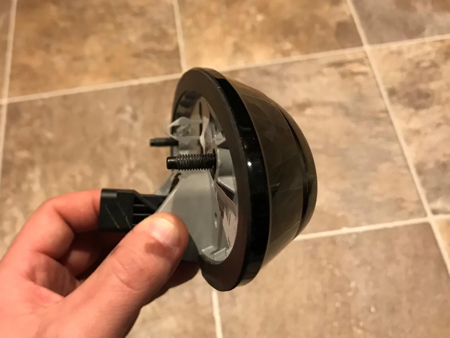

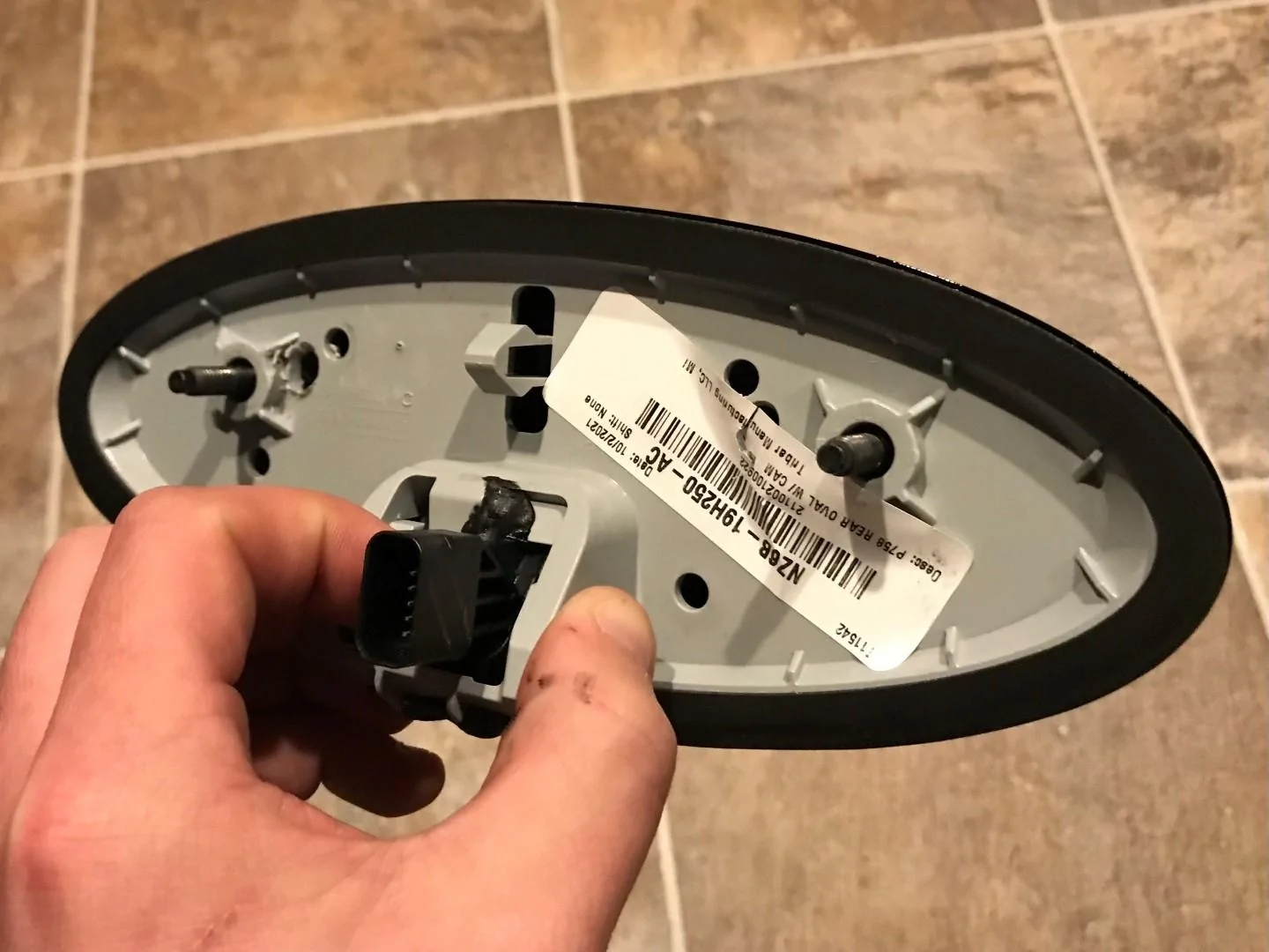

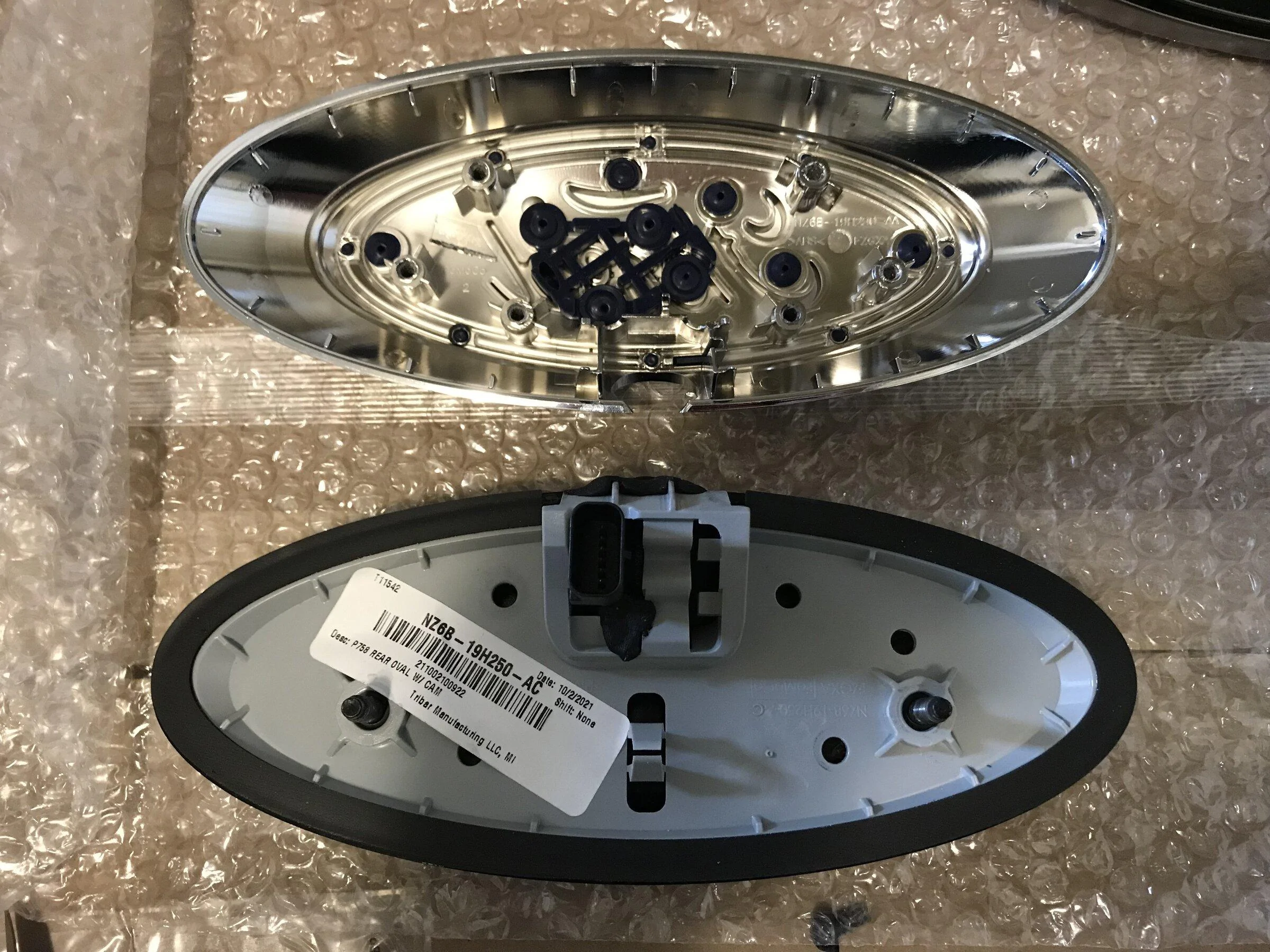

The Maverick emblem has the "bezel" molded in with the Ford emblem as just one piece. They cannot be separated. Only the blue can be separated from the chrome. The Maverick also has this baseplate which I've separated here and you can see the rest of the bezel/emblem is molded together as one piece.
Maybe that number there on the "baseplate" as you call it, is the part number for the emblem. You said you had to seperate those, maybe they come together as one from Ford so part number to search for would be NZ6B-19H250-AC
No clue, just throwing out there.

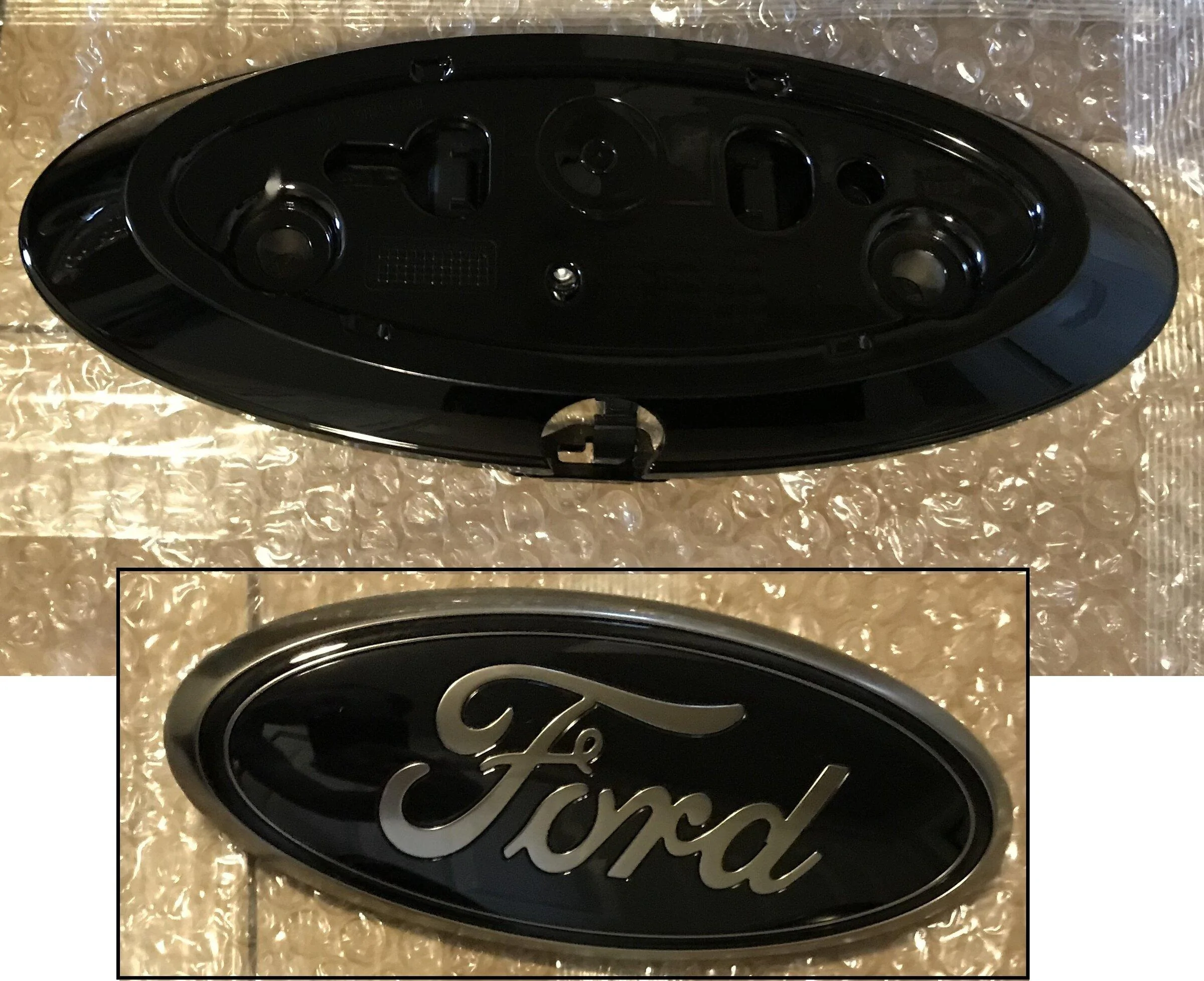

Just to clarify, the Maverick emblem is two pieces but not in the same way that the Ranger emblem is two pieces.
Ranger tailgate emblem and bezel, the bezel is completely separate.
This is ultimately what complicated the install as I had to fit the Maverick baseplate to what I had left of the Ranger bezel after cutting a ton of material away. Here's the Maverick baseplate attached the Ranger bezel & emblem.
