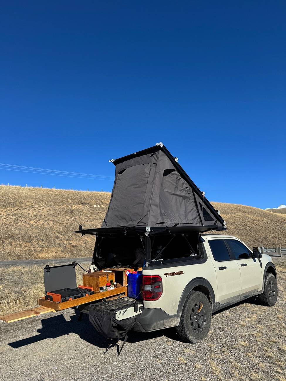

Hey guys, so just game back from another awesome trip in the little maverick up too Mamoth mounts for camping after a winter storm. This thing handles awesome in the snow/mud and is becoming an awesome adventure build.
Below I’ll list all the mods to date
- gofast camper(3 beef bars with solar tray)
-2” rough country lift
-245/70R17 Toyo Open country AT3
- Pair of Baja design LP6 lights (gfc aluminum mounts)
-pair of Baja design squadron sport (diode dynamic a pilar mounts)
-Auxbeam 6 gang switch panel/fuse box
- pair of Amazon special amber chase lights and same pair in white for back up (gfc aluminum mounts)
- pull out kitchen(built by yours truly)
-Alpicool 44 quart fridge/frezer
-bluetti ac180 battery
-renovou 100w framed solar panel
- maxtraxx with maxtrax mounts mounted to beef bars
-Overland vehicle systems shower room (2 gfc awning mounts used)
-Overland vehicle systems HD LT 270 passenger side awning (3 gfc awning mounts used)
Cosmetics
-window tint all around
- chrome delete on badging
- roof wrapped black
Everything you see here was bought brand new and all for the cost of less than a ranger raptor. Considering I don’t plan on jumping this thing in the dunes it’s perfect. It has taken me anywhere I needed to go and has been extremely reliable.

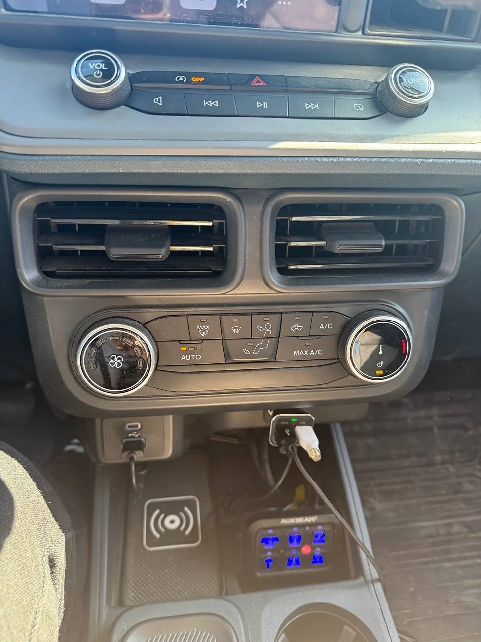

Awesome setup! Where did you mount your switch panel?
