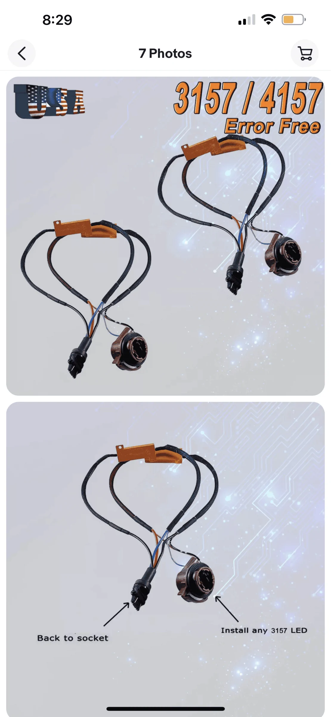

JUST ADD RESISTORS!! Leds will never fully function properly without them. This isn’t hard
testa422
Nov 21, 2021
732
1,135
Charlotte, NC
Subaru Legacy
Don’t even need to deal with splicing…get resistors like these pictured(just reference pic) and they’ll be plug n play literally
