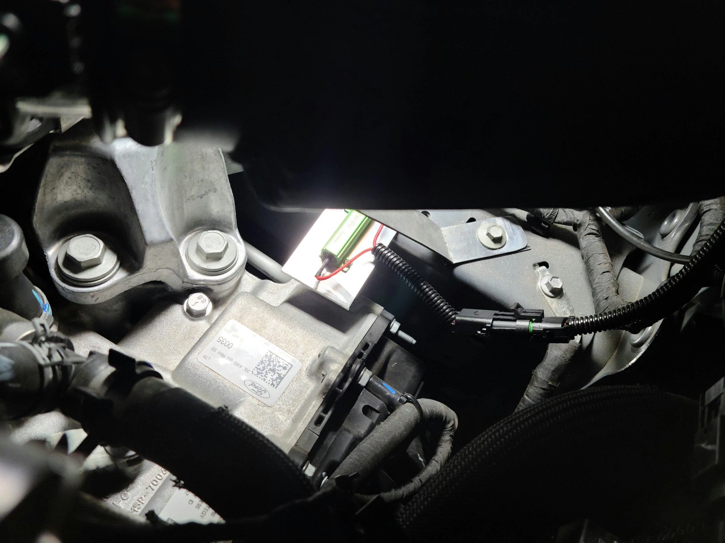

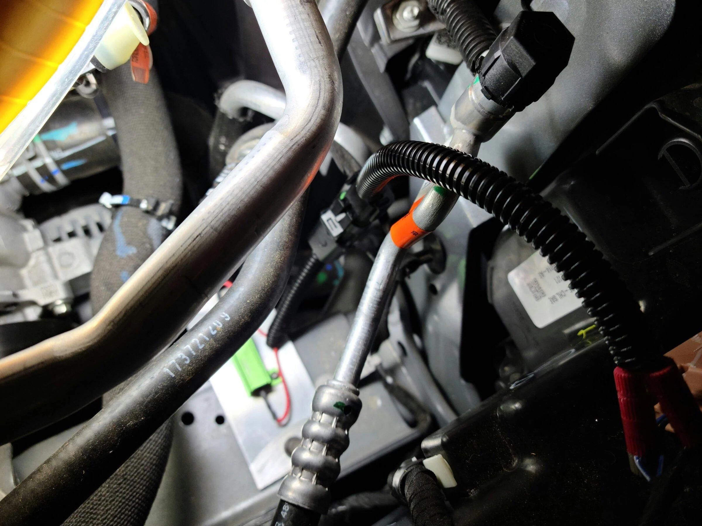

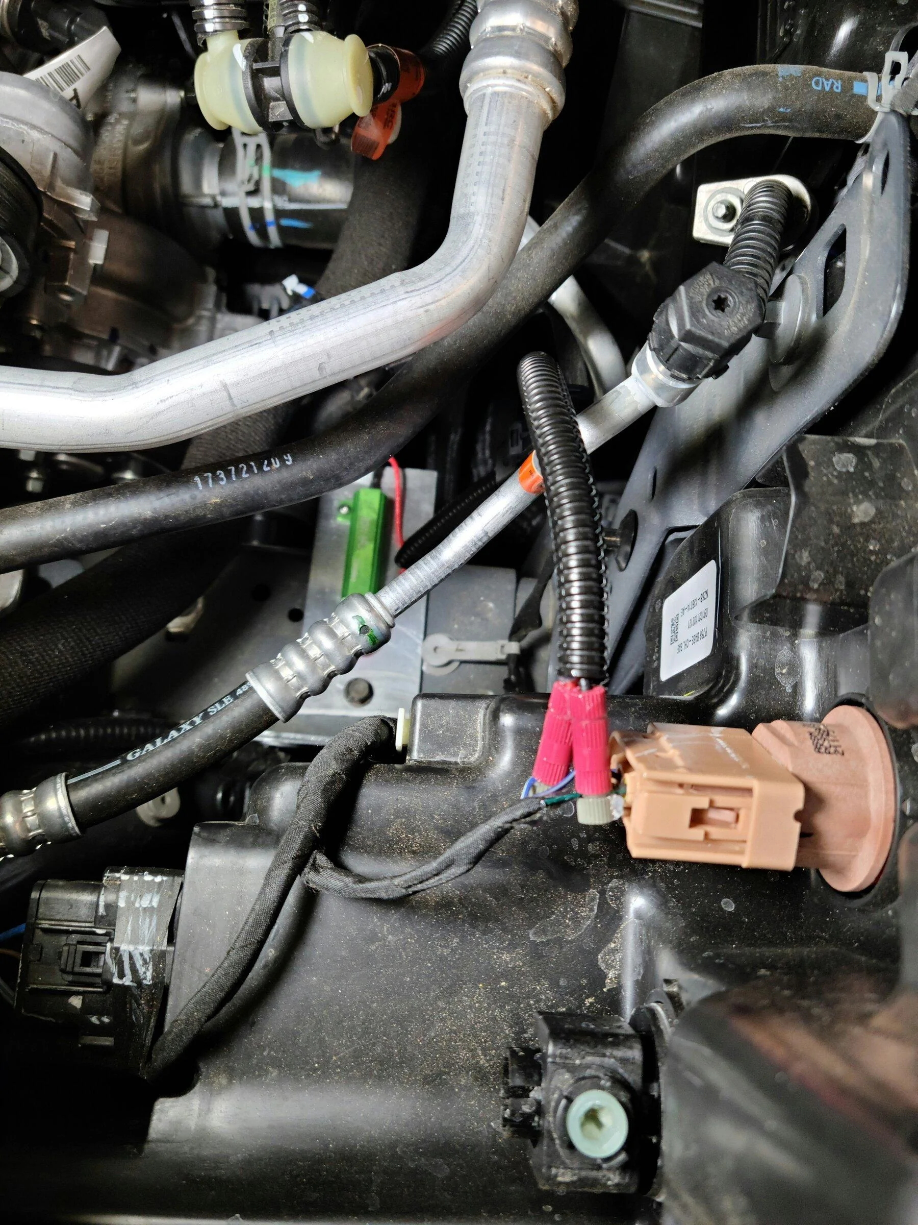

I got tired of the hyper-flash and wired in the resistors this evening. Used posi-taps, stuffed with dielectric grease and knocked up some simple aluminum tabs for mounting and to help dissipate the resistor heat. These are 50 Watt / 8 ohm, got a 4 pack from bezos. I also used weather pack connectors to allow me to pull and replace the resistor easily in the future if needed, probably overkill, but I had 'em.
All can be returned to stock in under 10 minutes, the posi-taps will only leave a small puncture in the factory wiring.

Thanks I see the posi-taps but not the weather pac connectors

Forgot to add, there are bushed / untapped holes on the frame rails there, so I completed them with a 1/4-20 tap to mount those AL tabs

Way better than cut and splice🤙

I agree. I would strip some factory insulation and do a soldered tap if I were concerned at all about these posi-taps. There is absolutely no need for anyone to cut their factory wiring, auto strip pliers will cut and pull / push insulation back mid-wire and then you can wrap and solder, much more solid joint but not reversible very easily.

Hey thanks for the updated photos.I now see the weather pack connectors 🎅🤙
