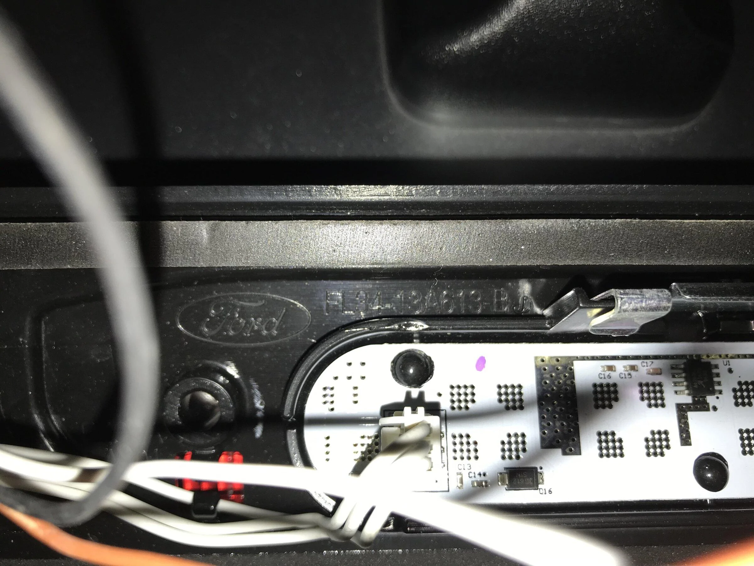

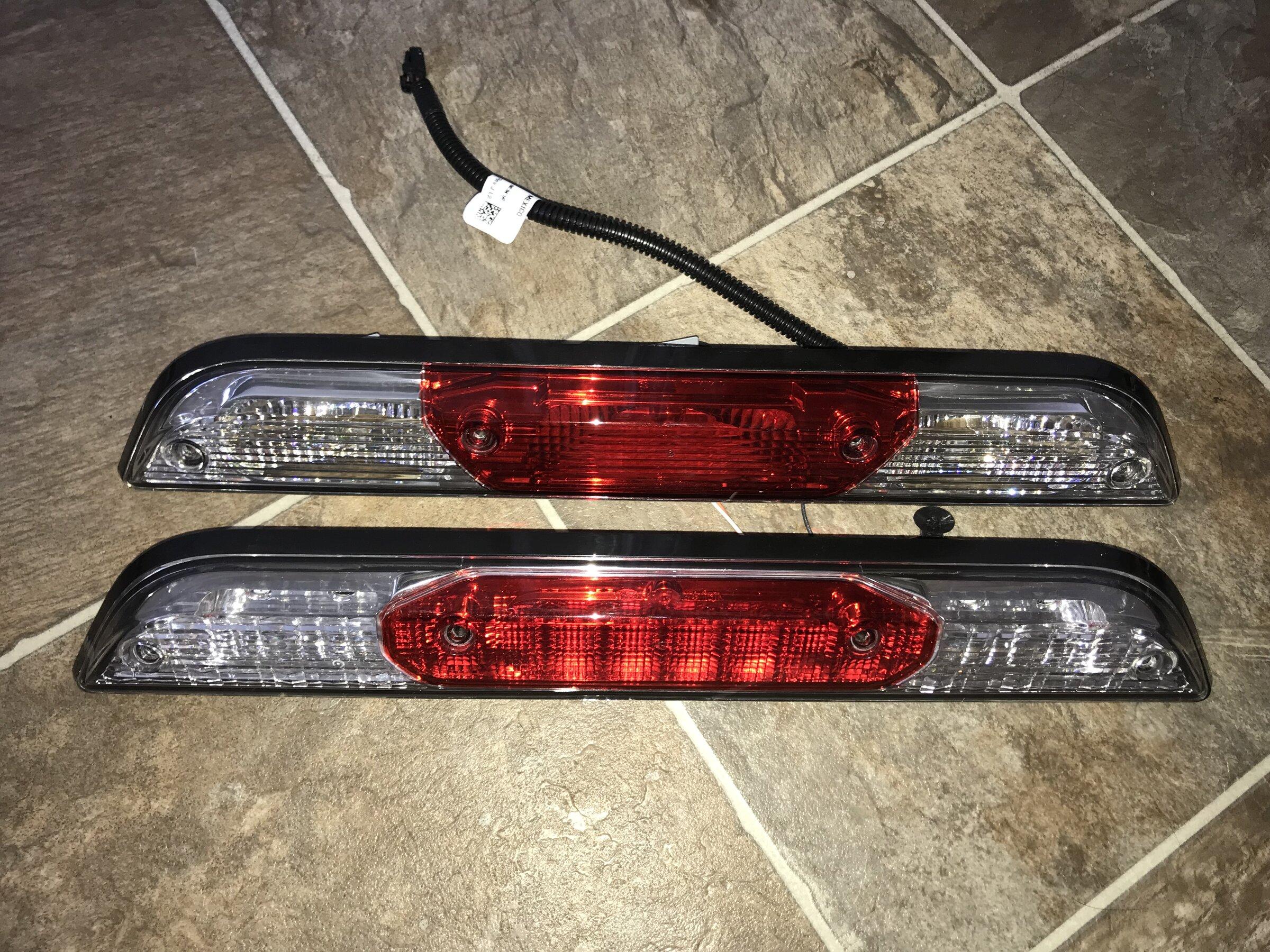

I actually found my old OEM LED Third Brake Lamp from my F150. Here it is with the OEM Halogen Maverick light for comparison. This would be another option if someone wanted to stay OEM but upgrade to fully LED. Install would be the same and the connector would require the same modification.
OEM LED Part number:
FL3Z13A613B
