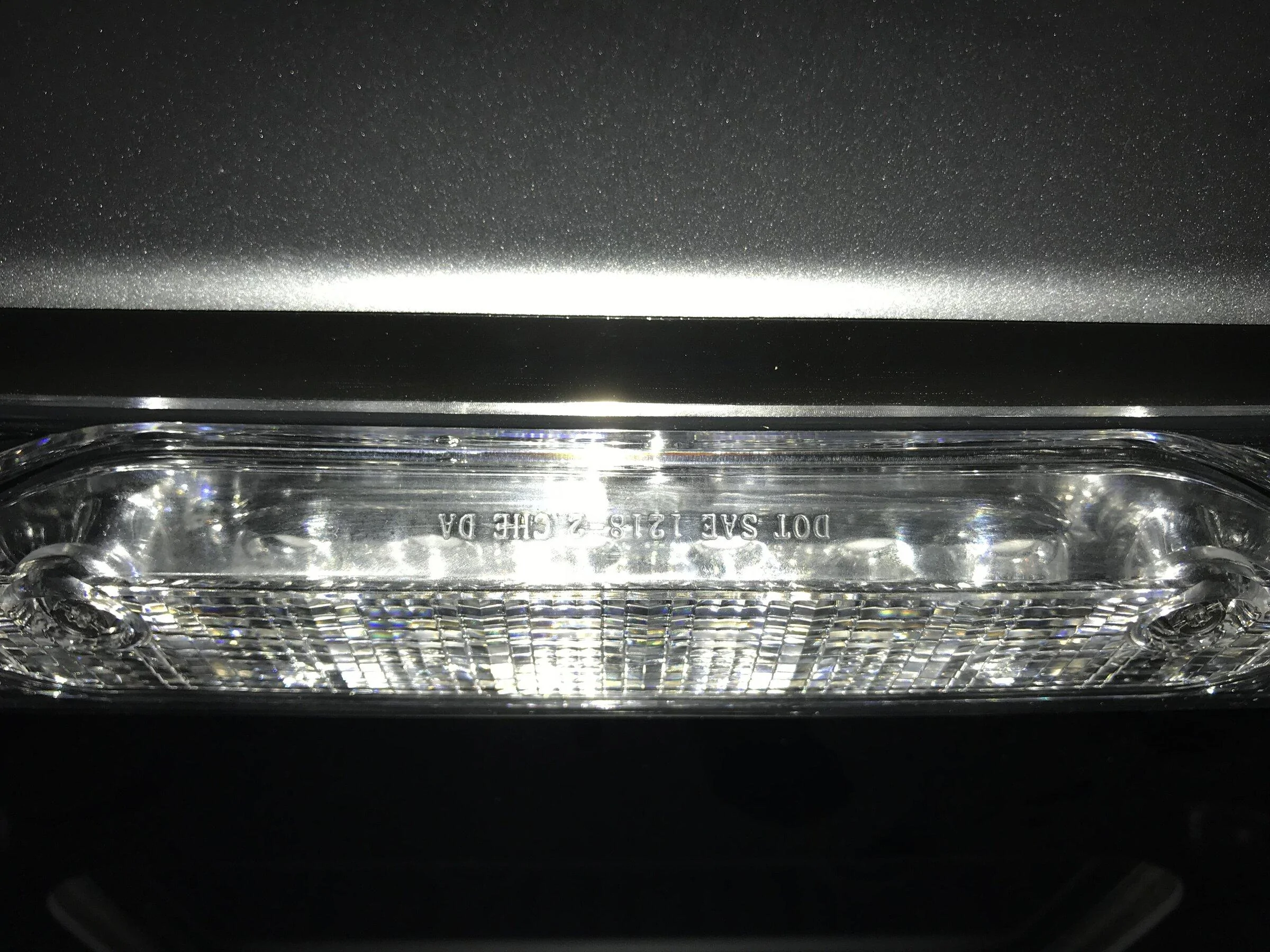

Also, probably doesn't matter to you, but are these "replacments" dot/sae approved? If it doesn't look or feel cheap, probably safe but I know that approval may matter to some.

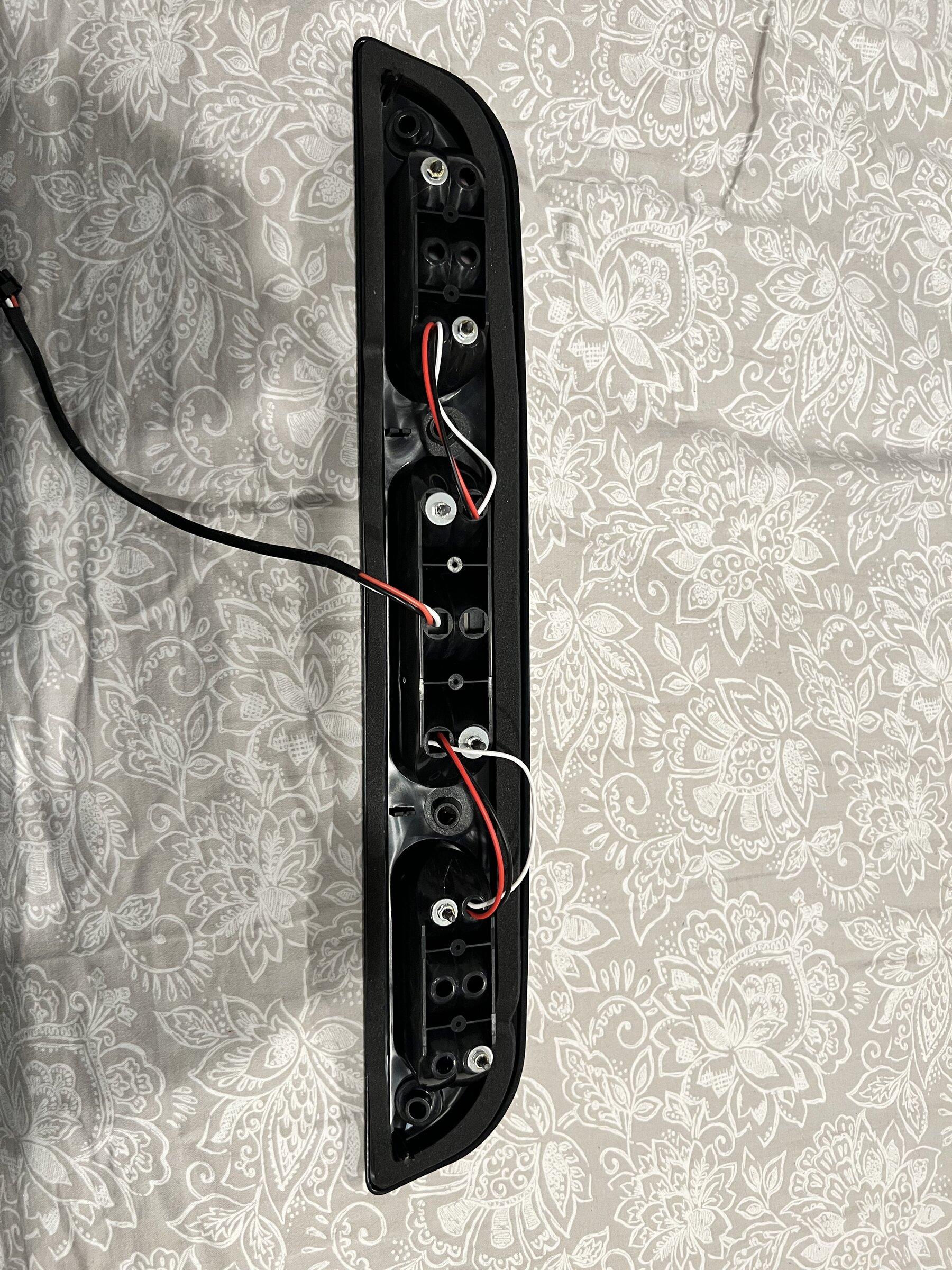

I replaced my halogen third brake lamp with a fully LED unit. The installation was pretty straight forward. The only tools I needed for this were: T20 Torx bit, small pry tools, and an X-Acto hobby knife. I had to modify the connector on the new light just slightly. Overall, I'm very happy with new look. The look and feel of the new light is very comparable to stock despite only costing $33. I've previously purchased aftermarket replacement lighting that I could just tell were cheap, knock-offs, this doesn't seem like that at all. I'll update here if any issues arise though.

The light came with a new gasket that I pre-applied to the back of the housing, this is shown below:

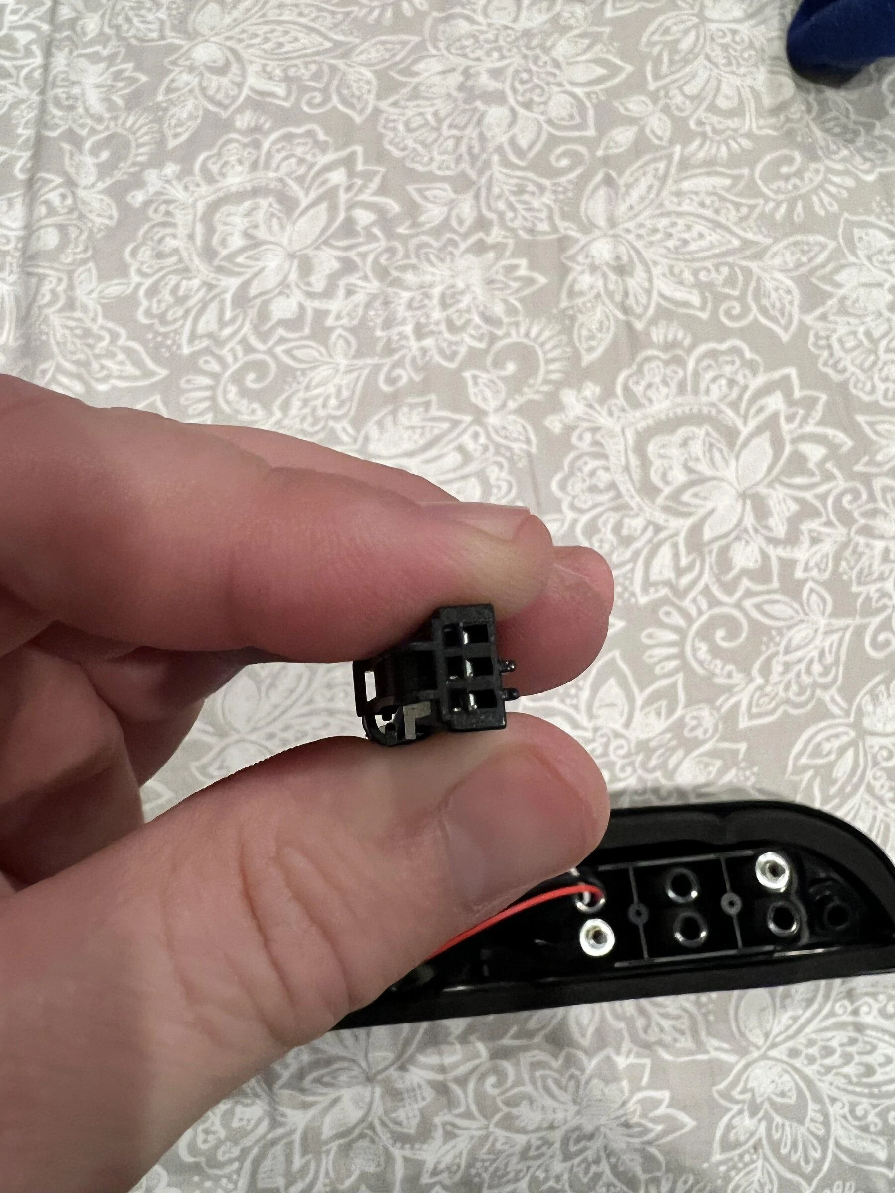

After removing the OEM light, I realized that the connectors vary slightly in that the guides are mirrored (luckily the wires are oriented correctly). The arrow points to the guide that I had to remove.
I used a hobby knife to trim this guide away. I scored it on each side then carefully cut through the remainder. This allowed to new light to be connected.

Good questions, the new light actually does say DOT SAE. This light is for F150/Super Duty but it clearly fits the Maverick.
