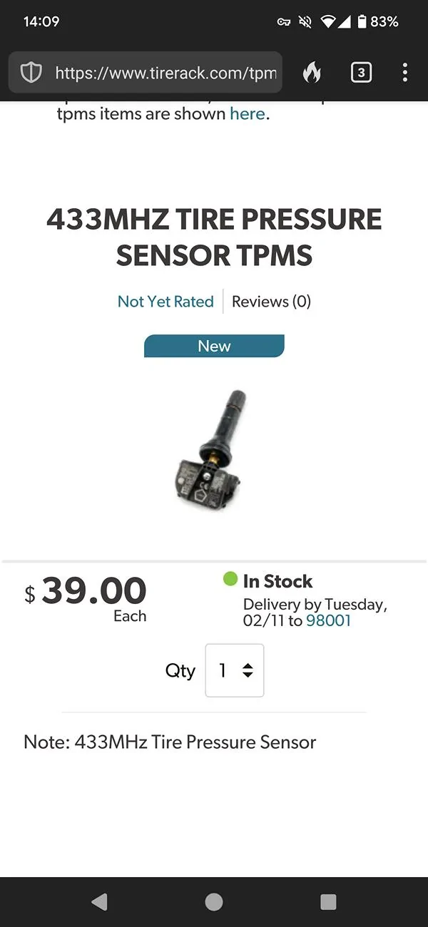

Might ask for a price match from Tire Rack.com on the TPMS at $39 each.
Discount Tires owns them I believe and have price matched before.
https://www.tirerack.com/tpms/results.jsp?autoMake=Ford&autoModel=Maverick+Hybrid+AWD&autoYear=2025&autoModClar=225/60-18
fair, but he did say $62 with labor so that's $23 in labor per wheel.
not unreasonable. for fun, he could call his local Ford dealership for a quote... I bet it's significantly more.
