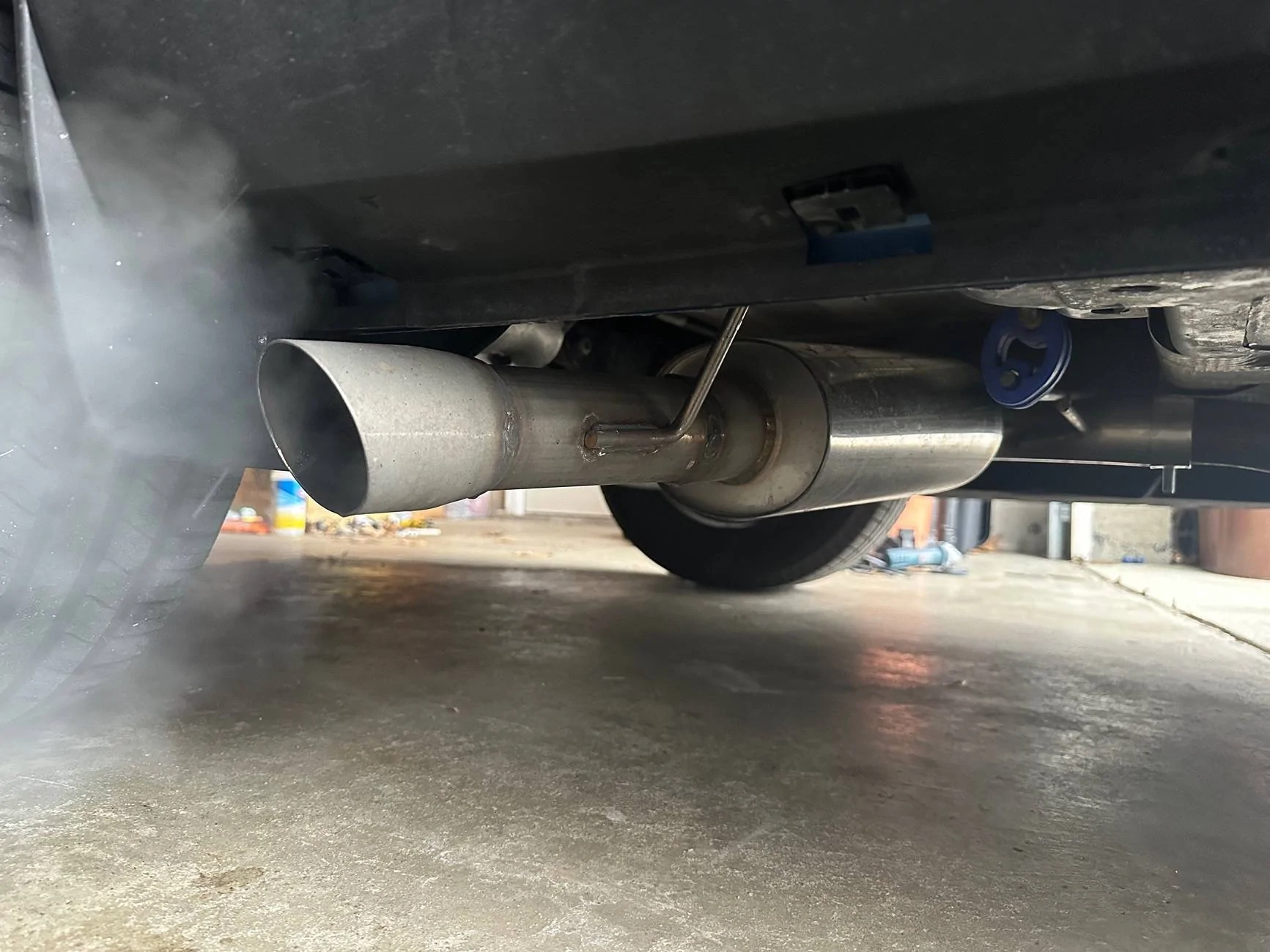

I just installed the @MRTperformance Tremor Trail Rated SideKick side exit exhaust on my Ford Maverick. It's exactly what I was looking for. It provides a bit more sound than the stock exhaust but it is still subtle and has no drone. The install was pretty easy as MRT gives detailed instructions. Here are some pictures and videos below.

I was really looking at this exhaust but it sure looks like you don’t gain any clearance with that muffle in that position
Yeah im not too sure about clearance. The picture I posted might be misleading because I was laying on the ground when I took it. The exhaust is not any closer to the ground than the stock exhaust and I assume some clearance is gained in the rear section of the vehicle.

it was not too bad. It would have been easier with a lift but it's definitely doable without one. Here are a couple videos that helped me to install it. One thing to be careful of is where you drill the holes for the exhaust hanger provided with the kit. Make sure where you drill in a similar spot to the install video and make sure there is clearance for the self tapping screws on the inside of the frame where you drill into.
