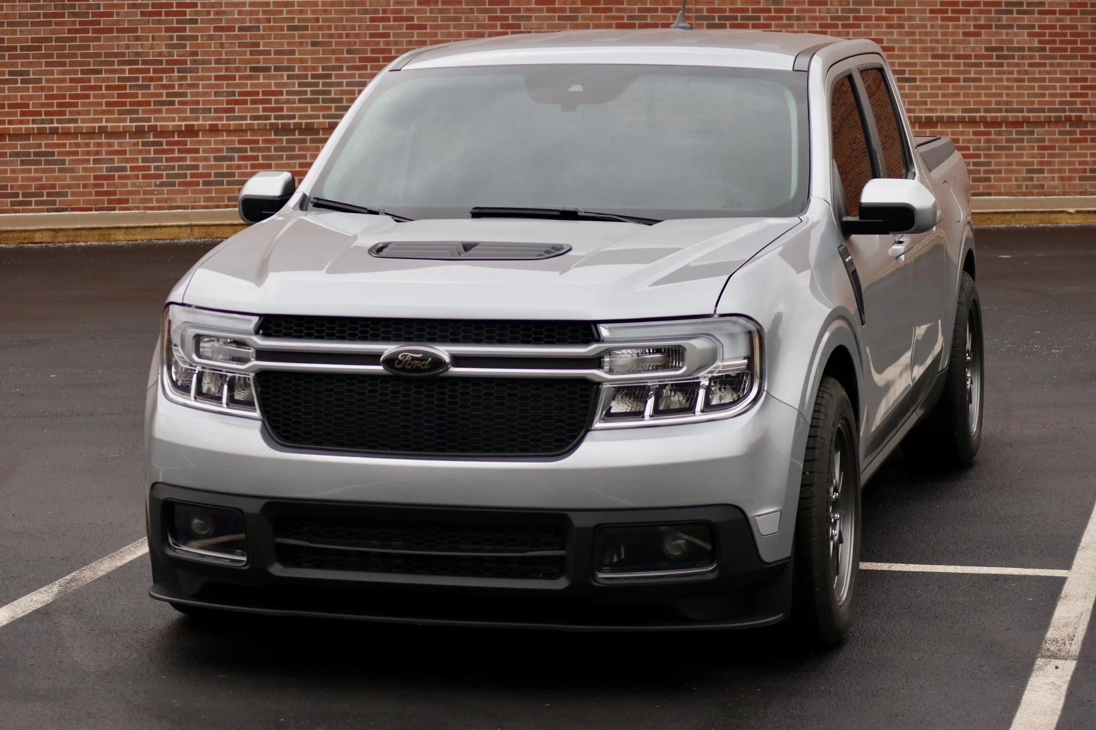

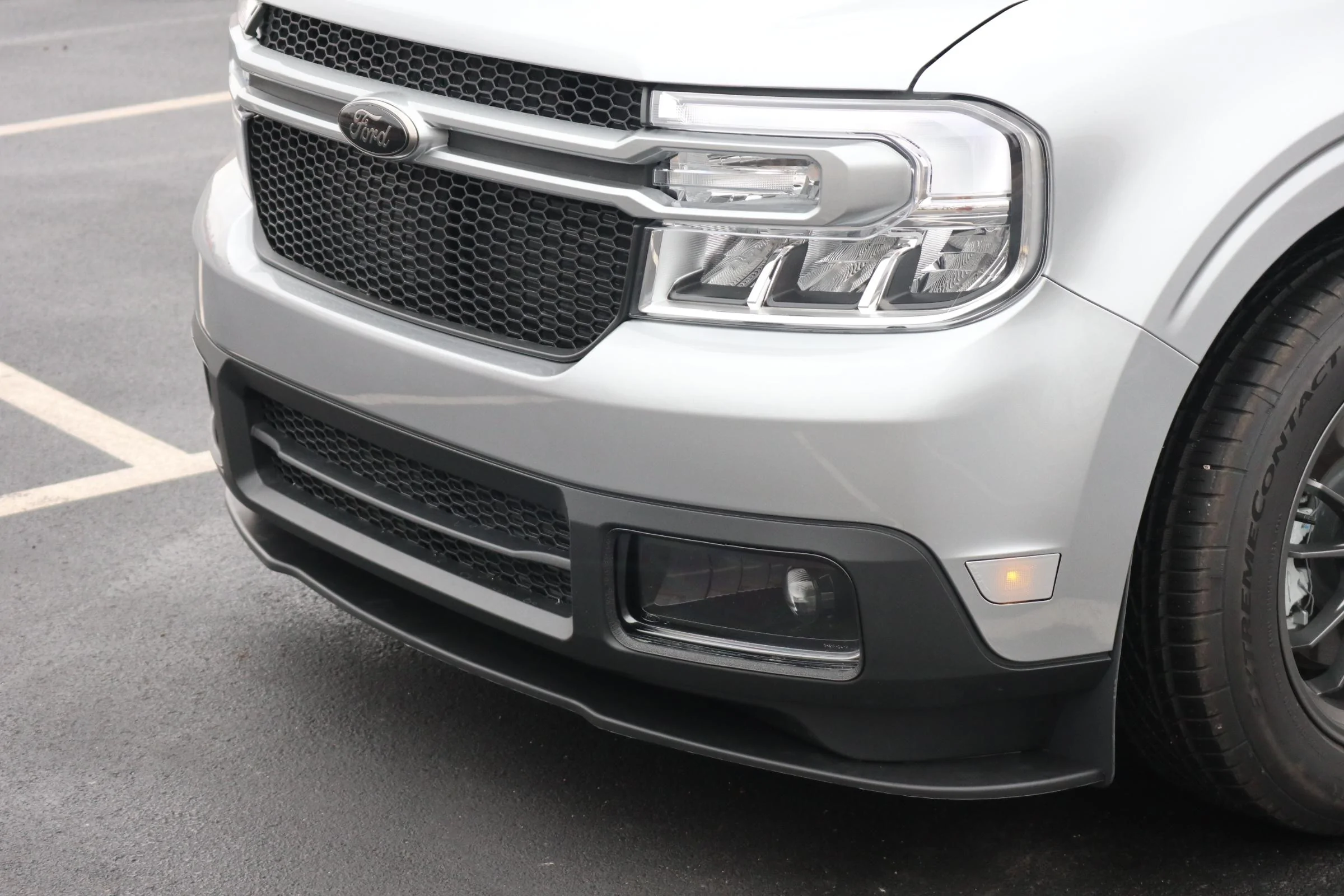

Modified my grille this weekend. I cut away the OEM grille bars and replaced them with honeycomb inserts. Here's the honeycomb mesh/sheet that I used to make my inserts ~$35: Car Grill Mesh ABS Plastic Racing Honeycomb Mesh Grill Spoiler Bumper Vent 47" x 16" Inches
I had just enough left over to make a matching insert for the bumper. It was a lot of work but I think it was worth the effort. Fog lights are up next.

Thanks, just take your time cutting away the old grille. I spent about 6 hours just cutting away at the stock grille.
I didn't take any pictures during, it was very ugly process lol.
These are all after. Here's a before and after though.
Thanks, no issues with the bumper removal. I cut nearly all of the OEM grille. Everywhere that's honeycomb, the original Lariat bars had to be cut away and replaced. Basically the outer shell of upper grille is all that's still OEM. And the painted middle portion of course.
Yeah, the pre-collision alert/braking still works. I'm glad it does because that was something I didn't consider before hand though :oops:
Yeah, could be a little more difficult adapting the 360 to the new grille.
J-B Weld 8237 PlasticWeld Plastic Repair Epoxy Putty - 2 oz. I also used zip ties around the entire perimeter to help the honeycomb hold the shape of the grille. I let it cure overnight and then I removed the zip ties before re-installing the bumper.
