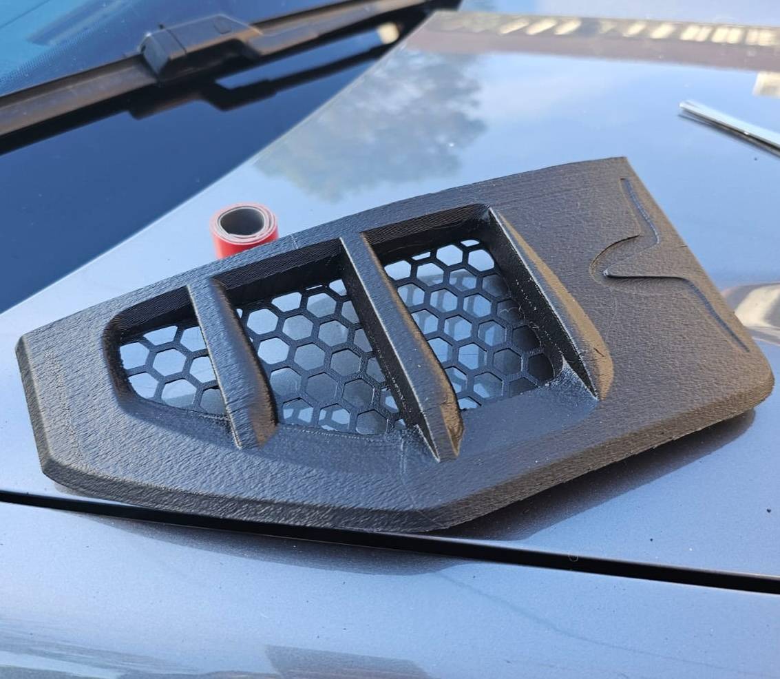

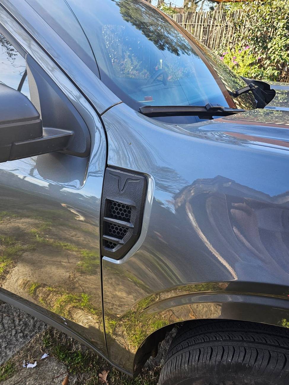

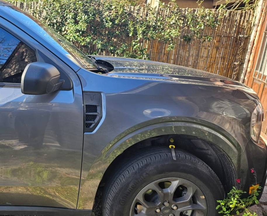

Hey Guys, just wanted to share and get your opinion on the side vents I designed/copy from the original ones.
Printed in ABS, coated with a Rustoleum transparent coat, and glued with 3m double side tape, already withstanded a 2000 mile without falling appart.
In my mind they helped on the MPG, but not solid test so far.

What printer (Bambu?) and resolution did you print at?
I am thinking with 0.05mm, a little sanding, and high fill automotive primer, it would give the smoother finish others are talking about.
Justa a cheap ender 3v 2 with mods. 0.6 noozle and 0.2 layers.
Next version will be a sanded and painted. I was just focusing on the model more than on the finishing

thanks for the good appreciations.
Indeed the rough look was by choice. I printed it with fuzzy skin to minimize the post process, my intention was to match the texture on the mirrors.
Priming, sanding and painting would take some tools and space I don't currently have.
Would be curious what this would look like with a PETG-CF or matte ASA smooth finish, could probably still get away with minimal / zero post processing.
I think you are rigth, but seeing the noozle temperature IDK if my ender will print it.
