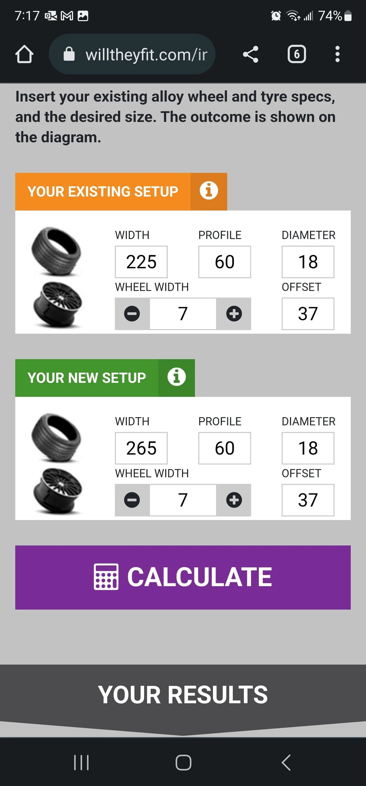

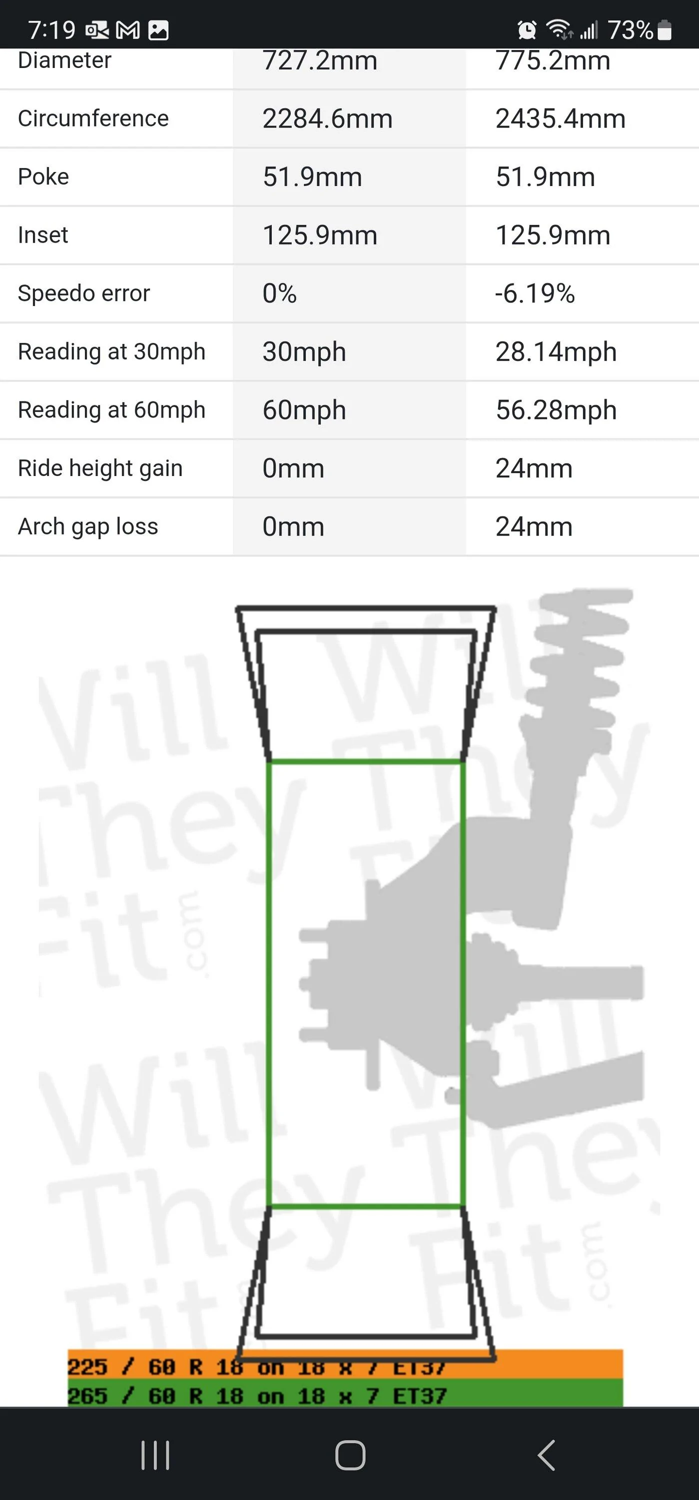

Throwing around the information gained here plus some addition it would appear these tires would fit stock with slight to no rubbing (see below)
Ford Maverick 265/60/18 tires on stock Lariat? Screenshot_20230430_191736_Chrom
Ford Maverick 265/60/18 tires on stock Lariat? Screenshot_20230430_191929_Chrom
I would like for someone to go over this (if possible) and double check me on it. Let me know your thoughts!

I have seen the 265/70R17 on the Maverick. That tire stands 31.5 inches tall depending on brand. The 265/60R18 stands roughly30.50" tall. In theory, you should be ok.

One last question diameter being addressed at 30.5" would width be called into question given that it is 10.4".
Thoughts??

265 mm translated to inches is 10.43 inches. Mounted on a 7" wide wheel you will be closer to 11" overall width from sidewall to sidewall. You should be OK.

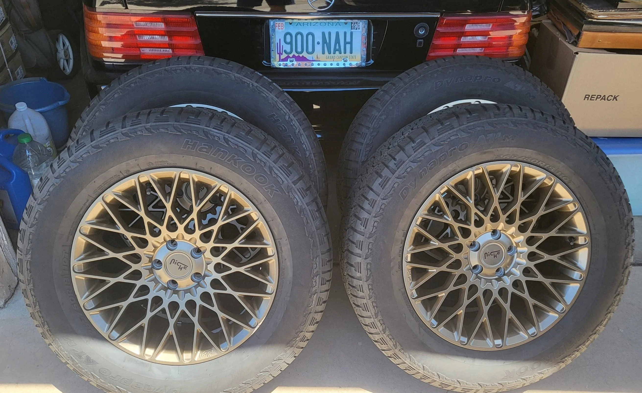

Are you still on Pause? I found some 265/60/18 Hankook AT tires I had mounted and balanced.
My Maverick should be here any day now. Just wanted to see if you had any progress on your project?

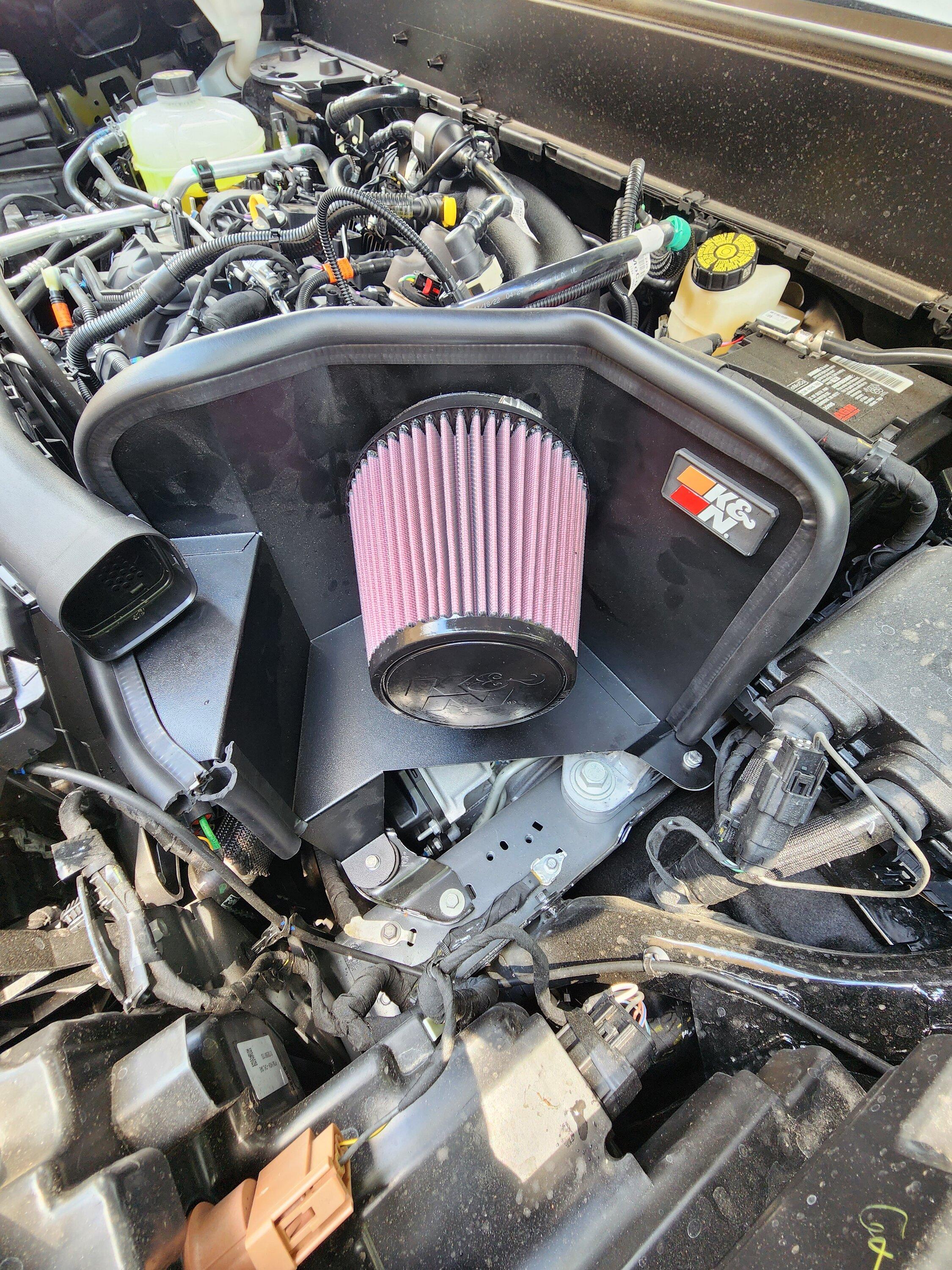

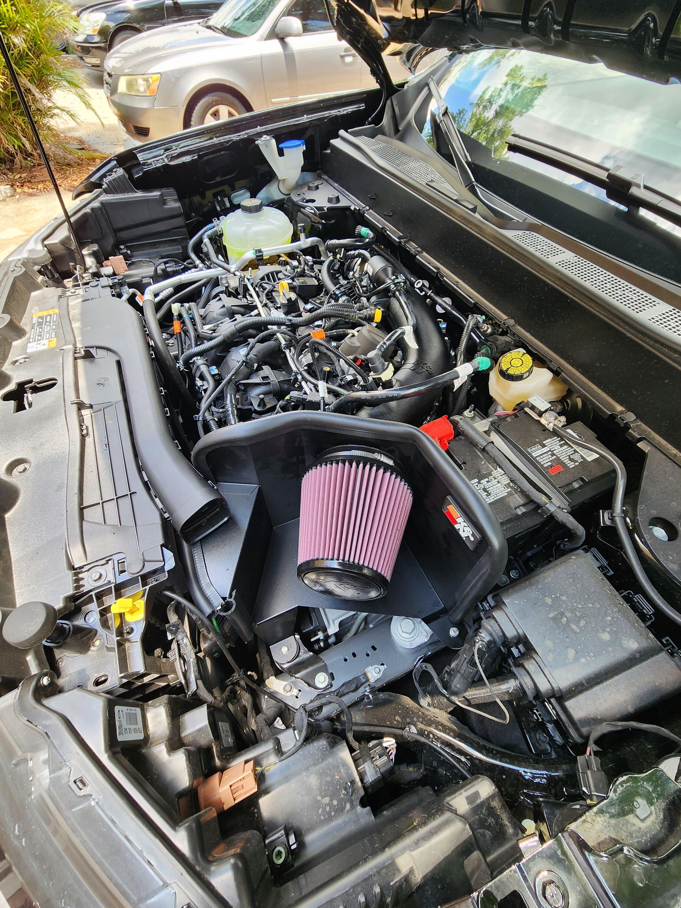

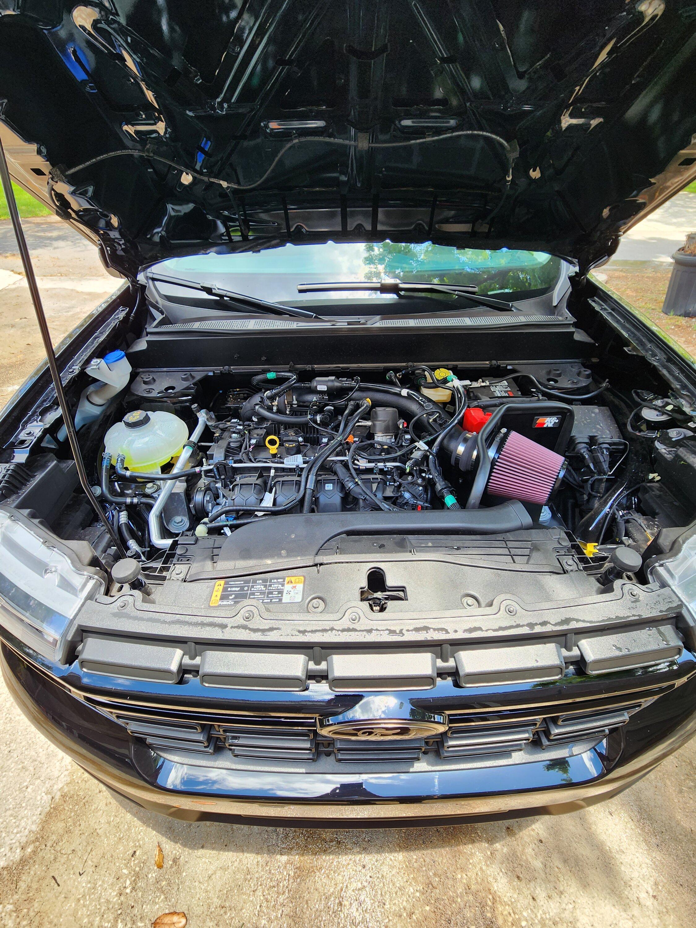

Trying to find time in between work to get this going. I did manage to get my CAI and BOV installed. I dont trust shops so im limited to when I get a break.
Ford Maverick 265/60/18 tires on stock Lariat? 20230513_132131
Ford Maverick 265/60/18 tires on stock Lariat? 20230513_132122
Ford Maverick 265/60/18 tires on stock Lariat? 20230513_132118
Sweet! Let us know if you can feel the power with that cold air intake.
I want to say yes, I can feel the power. But I know its subjective. The noises are cool though, sounds like a jet when spooling up.

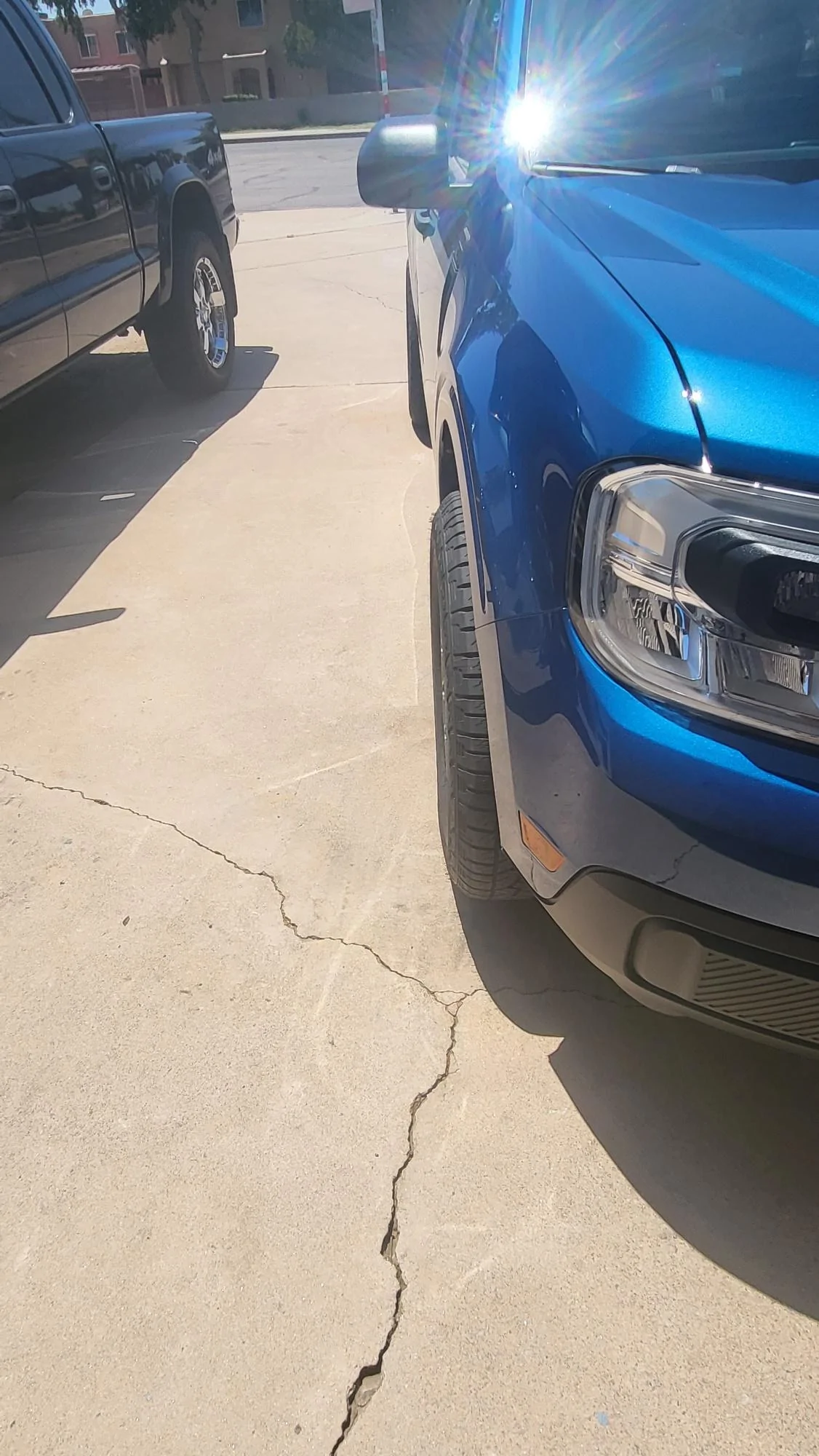

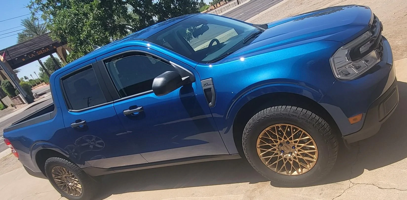

just an update, the 265/60/18 fit perfectly on stock suspension, no rubbing! The wheels are 18x8 with a 40et. Super happy with the fit and ride. Plenty of power. The truck only has 53 miles on it so I can't tell you about mpg. I don't care, it looks great and fills up the wheel wells with minimal poke out. Best of luck with yours!

Hell yeah!!! Im digging those rims too!
