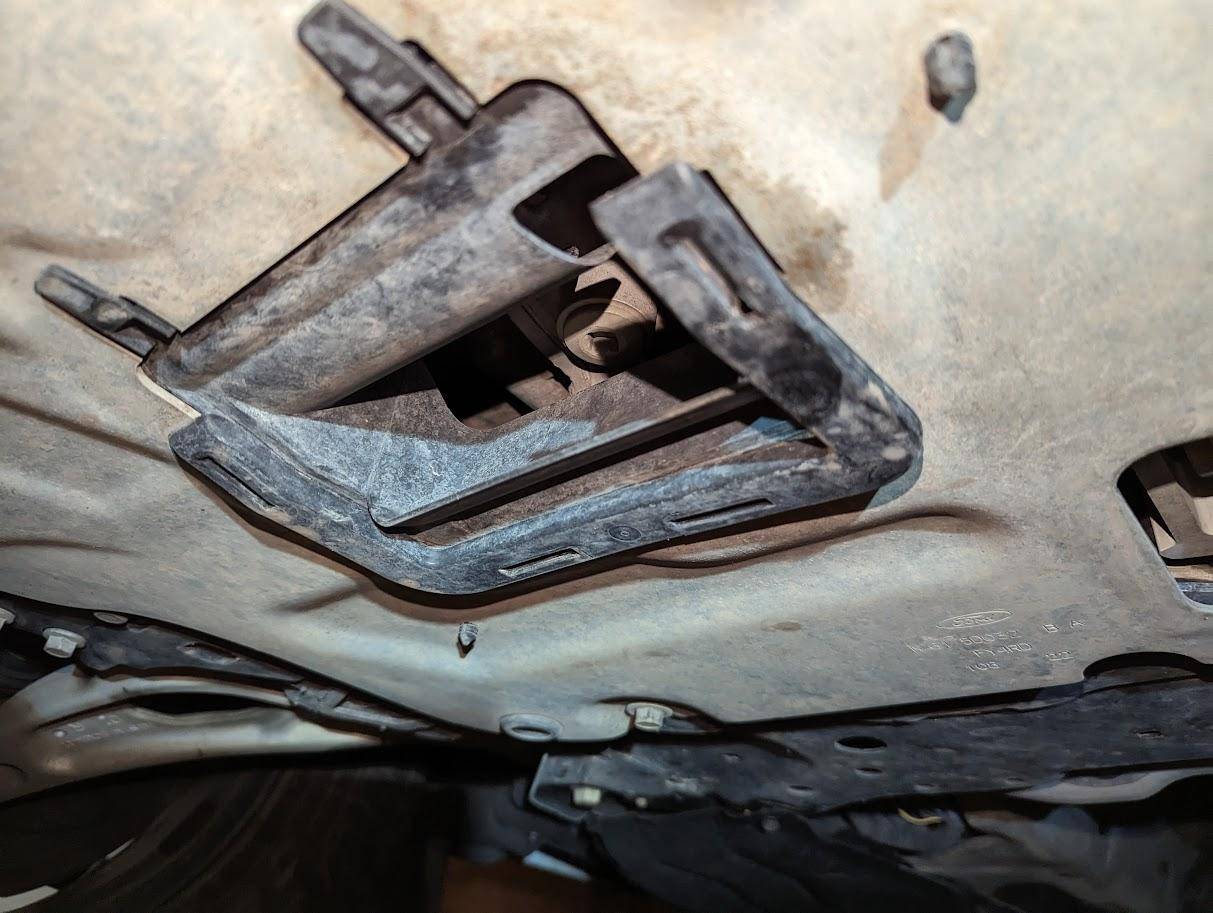

What plastic access port for the drain plug? Are you referring to this?
I believe that is a vent for the PTU. There are no removal oil drain plug access panels in the stock FX4 skid plate.
This is on opening for air to cool the PTU for the AWD system. It is not meant to be opened.

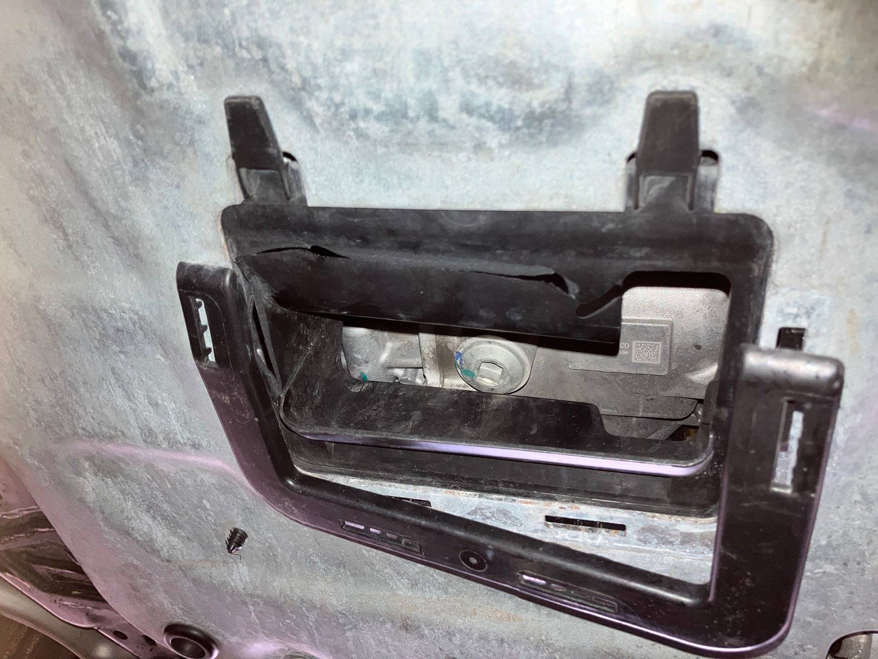

Yes, that's it. If you remove it, the oil drain pan plug is directly above it. (I incorrectly responded to Superg0). I just happened to nudge it a little and the outer piece fell off in my hand. Then the inner piece was just floating around on its own above the skid plate. I was able to wiggle it back out thru the slotted openings towards the front, and could easily see the oil pan drain plug. Then, try as I might for 15-20 minutes, I was unable to get it to snap back into place, and tomorrow it becomes Ford's headache to fix while doing an oil change.

I believe my dealer broke my plastic air deflector during an oil change but can’t prove it, see photo. Anyways, now that I change my own oil and also remove the plastic air deflector to access the drain plug, I zip tie the air deflector pieces back together upon completion of the oil change. So maybe you could utilize some zip ties?

If you permanently remove that air deflector; plan on your PTU warranty VOID! It is there to funnel air over the PTU which is very very prone to overheating. Many many threads on this overheating on other forums. THey have used this PTU on Edge, Bronco Sport, Maverick and Escape. Very prone to overheating. That "Vent" is not to be removed.
