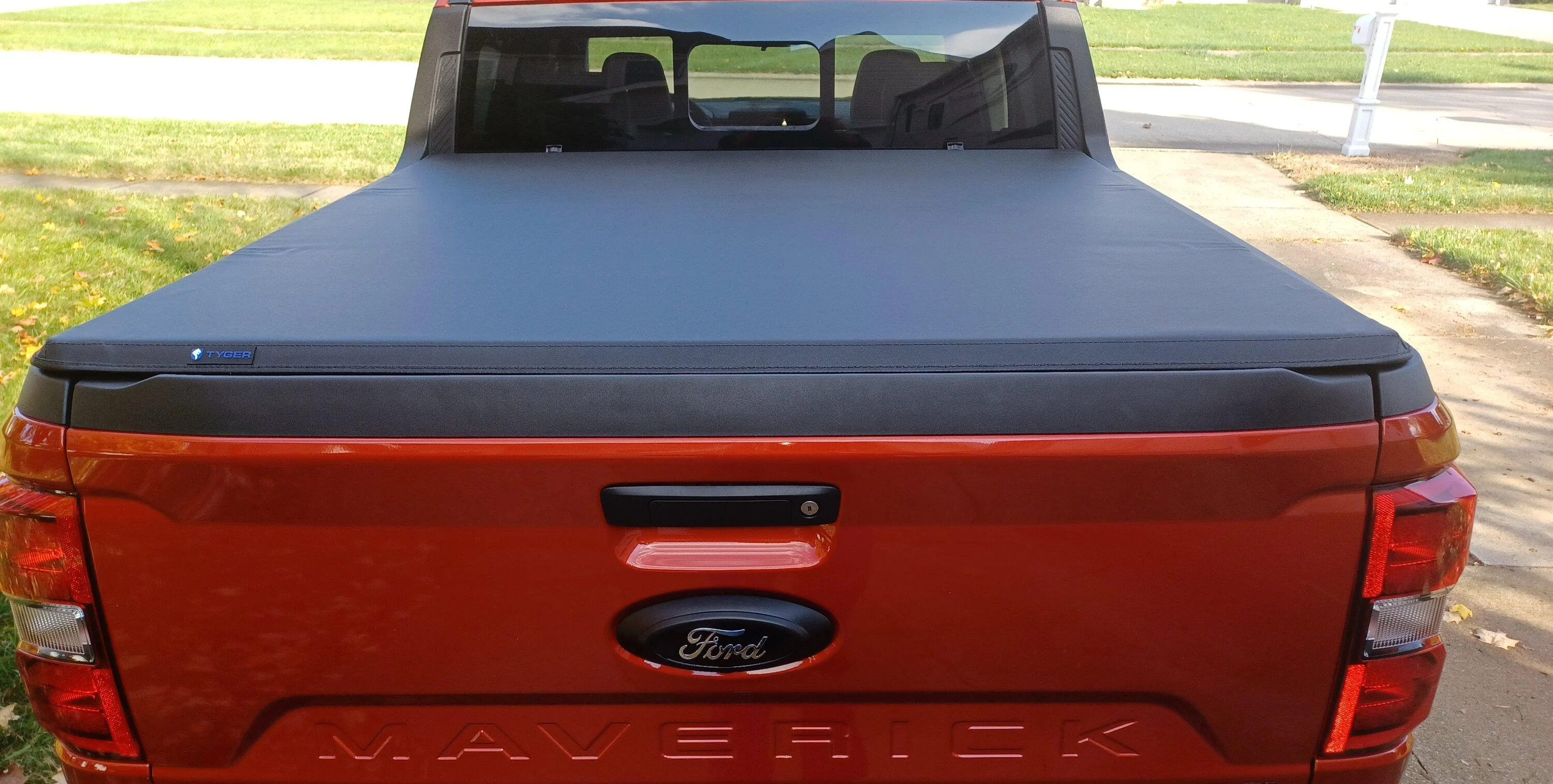

Got one on my living room floor just now getting a coat of protection on top and seals. Will go on the truck when the sun comes up ;)

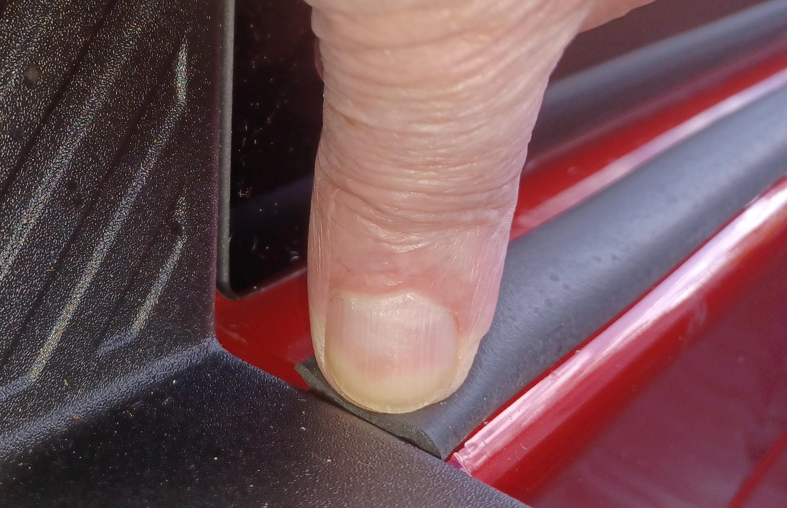

The included bulkhead gasket seemed too thick for the Maverick so used a softer D bulb seal strip I had on hand. I also added a short bead of black silicone to the two notches in the bed top rail to cure overnight.
The vinyl is a smoother texture than previous bed covers and should be easier to keep clean. The cover uses a similar D bulb seal on three sides and a double wipe seal at the tailgate.
my only complaint is the two straps used to secure the top when open aren't secured in place to the front cross rail.
I had the same issue with the two straps on my Gator Tri-Fold from Real Trucks. I got tired of them both sliding to one side. I ended up putting zip ties on either side of both straps to keep them in place.
