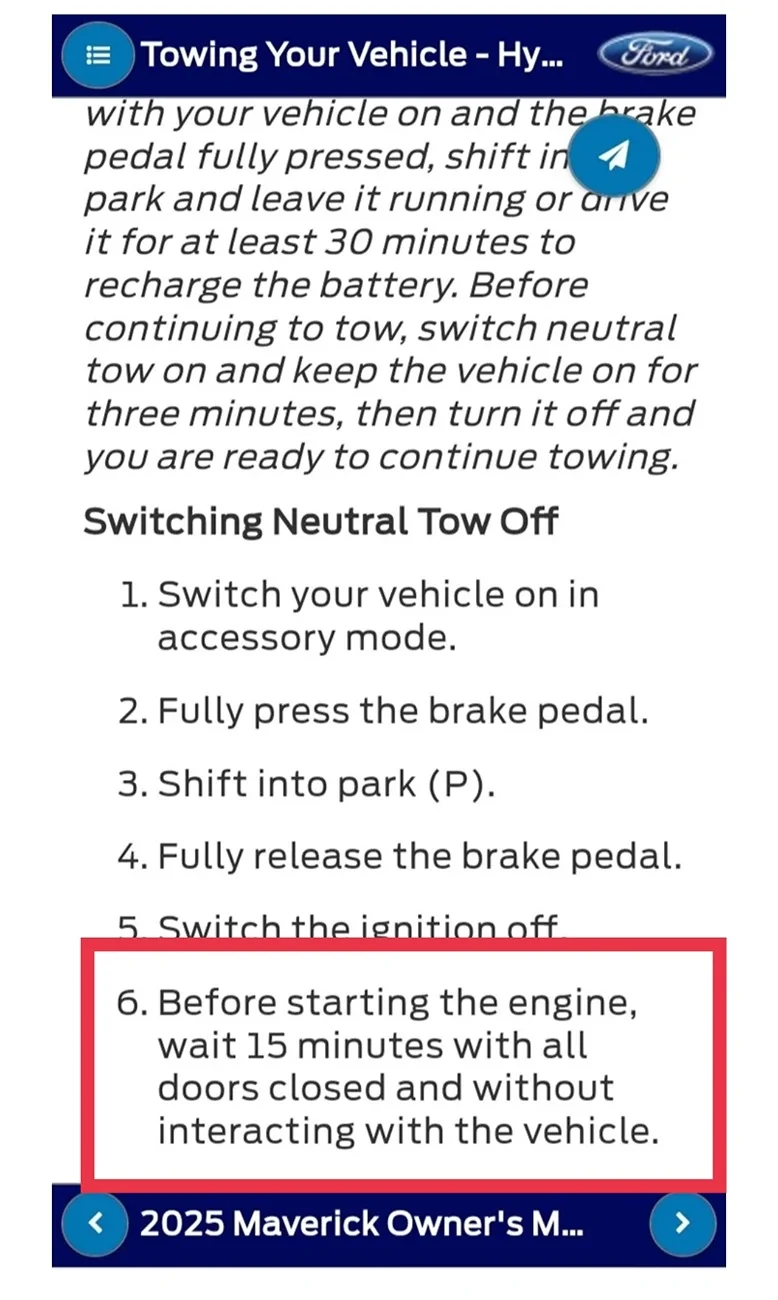

Maybe we can ask @Darryl
If he can can find out, why engineering felt it necessary to put this step 6 in the manual?

Ford does a poor job with their instructions, I would think a major corporation could do a better job. Especially since they are obviously they're trying to sell the Hybrid Maverick to the R.V community. Reminds me of the instructions that come with Chinese products.
I had no luck talking to the dealer or service people. So I called the Ford helpline and talked to a young woman. I asked "If I have a charge line connect to my Maverick battery do I need to stop every 6 hours to charge, what is a fully charged battery"? I asked her if the 6 hour stop was only to charge the battery or is it for other purposes, like lube the transmission? She said charge the battery only.
On my 1st tow I did stopped every 3 to 4 hours and used a multimeter to confirm the Maverick battery was topped off and that the charger line was actually charging. Probably need to have a lawyer read Fords instructions to confirm that's what they are really saying.
The 15 minute wait after after coming out of tow mode could use an explanation too.
I think the wait has something to do with all the computers syncing, but that's just my thought. I was concerned if I started before allowing the computers time to do whatever I may create a problem. I don't know and Ford ain't saying!
My procedure is open the drivers door, and put the window down, then close the door. I can then reach in and using the test button on my RVI Brake go thur ending the tow mode procedure. While waiting for the 15 minutes to end I disconnected the tow bar and wait for the wife to return from checking in. If she gets back before the time is up she waits and I continue to the lot. Rarely does she get back before the time is up.
