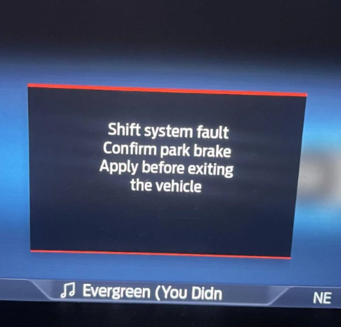

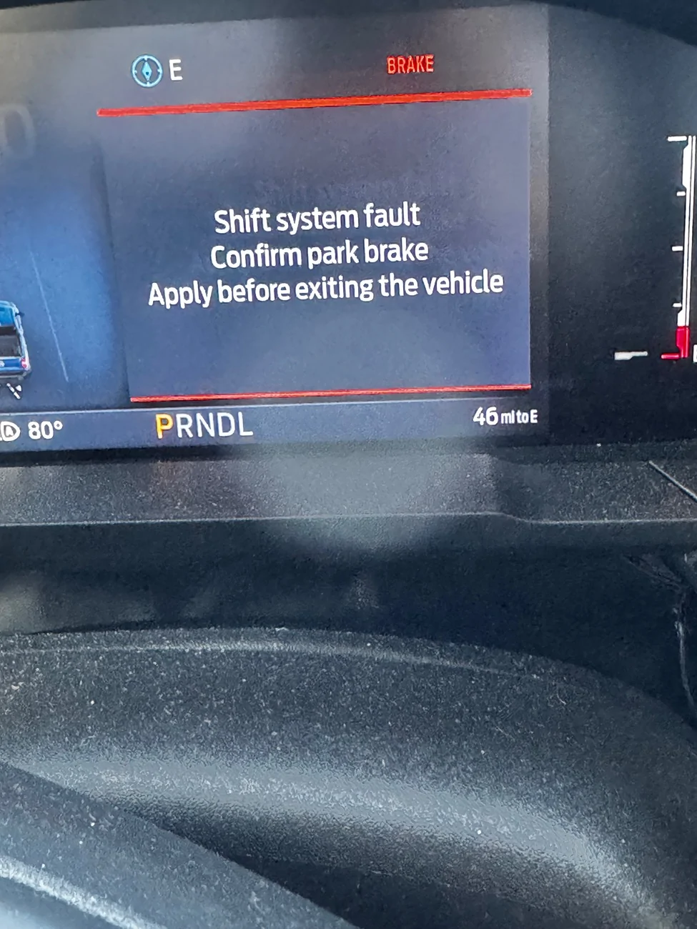

I just got this error on my 2025 Hybrid lariat pulled into gas station and stopped put it in part (did not use e-brake) and got this error. I have 4450 miles

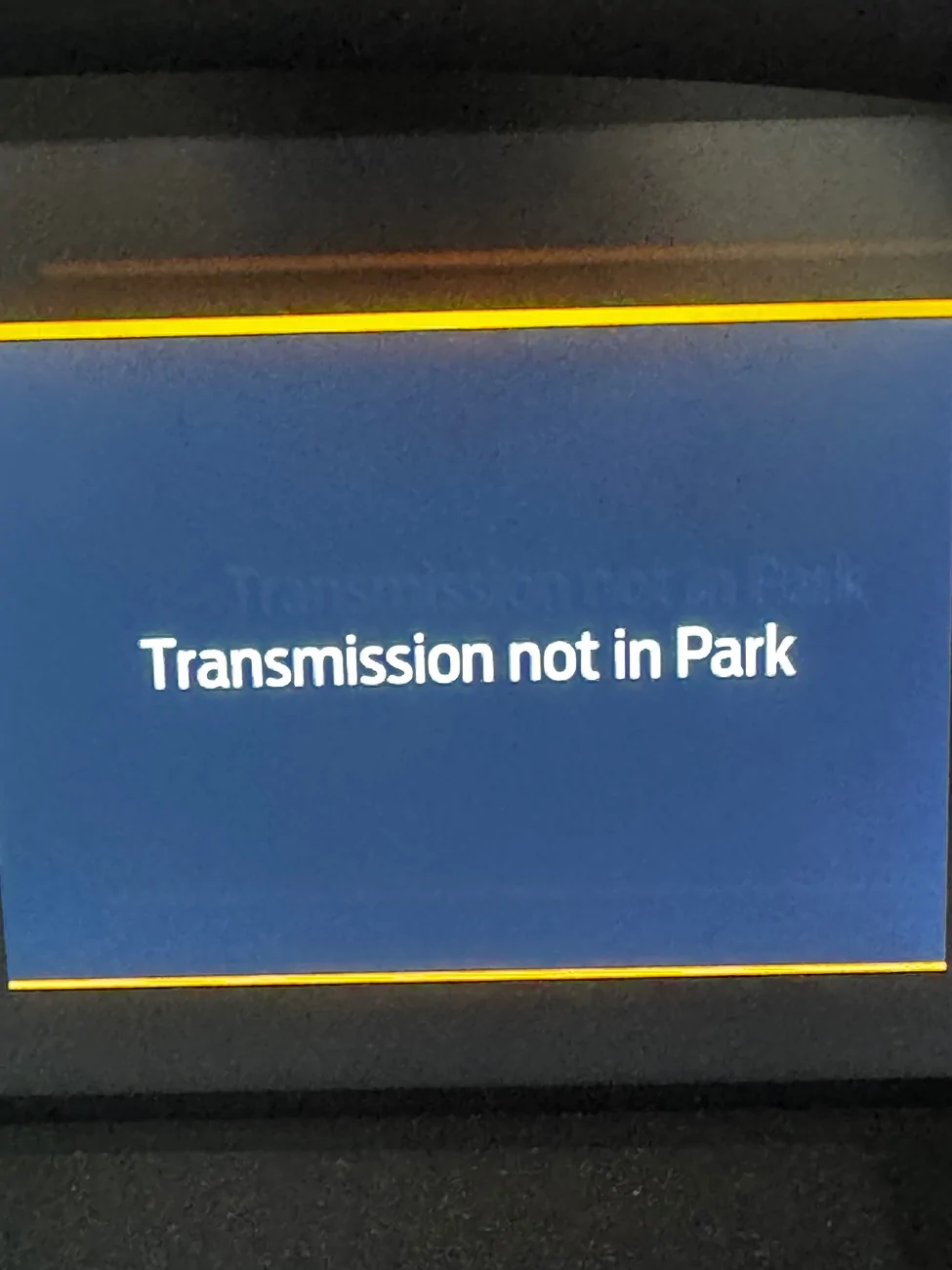

When I put it into drive to go home it allowed me to drive home but when I got home put it into park and turn off the car alarm went off with the following message saying the transmission is not in park I got the alarm and mission to go away by Appling the brake (not the e-brake) something is not aligning up.
Sounds like a sensor issue of system not thinking it's in Park.
Though there is a parking pawl that with ebrake engaged first could in theory not be pushed where it needs to be due to no movement.
But defeats the whole purpose of providing strain relief to the pawl if you can't do e-brake 1st.
I'm guessing that sensor is in the transmission.
Strange that just a normal brake pedal push would clear it though.
