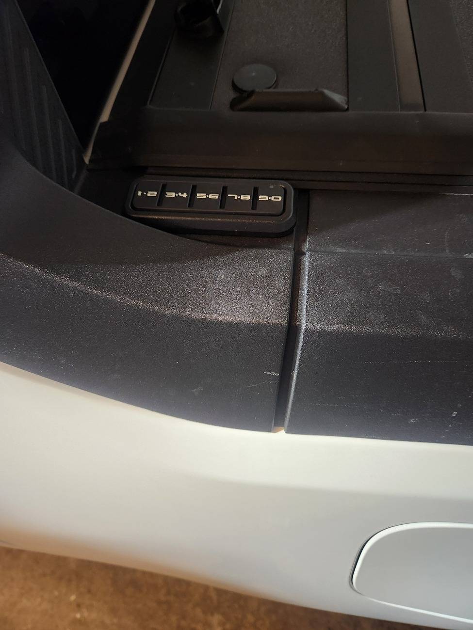

Hey all, i just bought a 2025 maverick awd hybrid lariat with keypad installed. It's different than the previous years. The dealer I bought it from is 4hr away and delivered it to me. On delivery, i discovered they didn't deliver the keycard that has admin code. they took accountability and said they'd cover the cost to have it reprogrammed or replaced at my local dealer. Does anyone have experience with these new keypads to see how to find the code? My local dealer seemed clueless on how to retrieve it or reprogam. They seem to think they need to order a new one and start over. But then they realized they also couldnt order a new one because they couldnt find the new part in the ford catalog. Any help is appreciated. They left the install guide but no card. here is what the new keypad looks like...

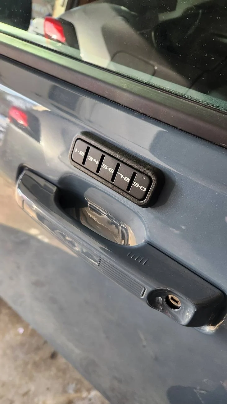

Do we think the new keypad will fit inside the fuel door?
ThirdCoastBoomer
Reid
Jan 2, 2025
60
185
SE Michigan
2025 Maverick Lariat
🤷‍♂️ Depending on your model, it may not be possible. My Lariat Hybrid has an electric door latch, therefore prohibiting this location.
Ford Maverick 2025 securicode keypad issue 1000007723
Mine is here for now. Anywhere on the door looks fugly, imho.
