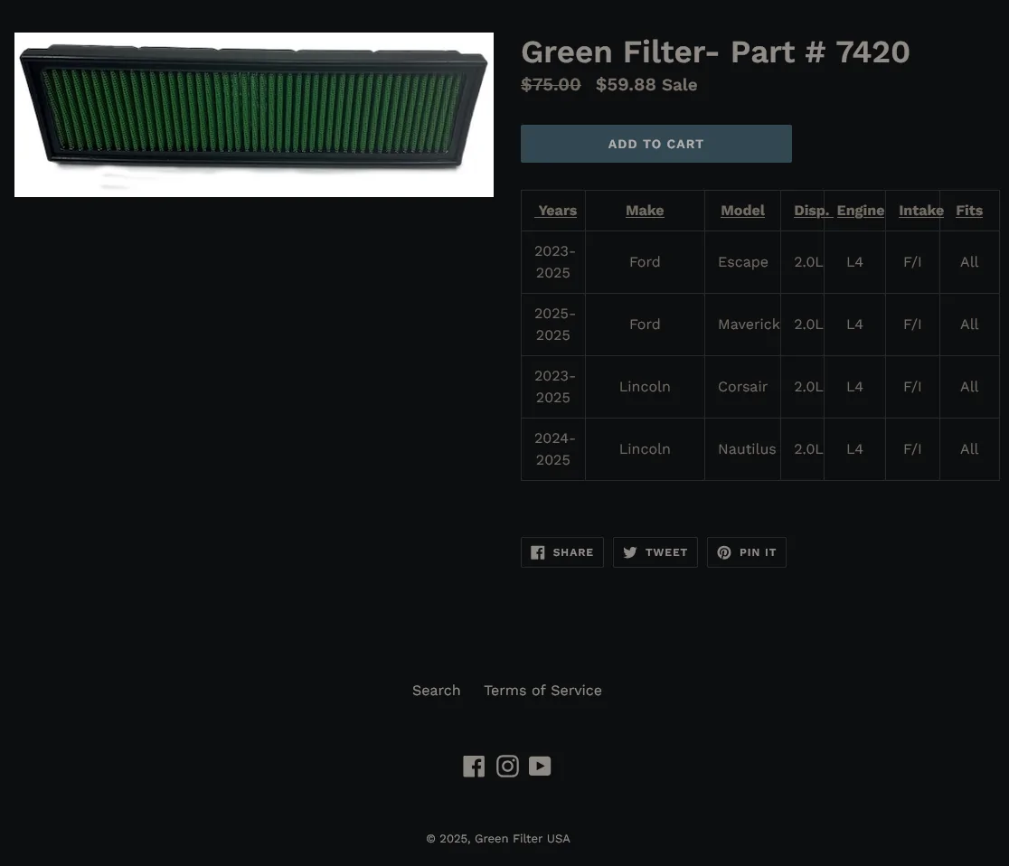

Do you know anything about this?
Any experience/use?
Higher flow rate/less restrictive?
I ran a 'pod style' GreenFilter on my Focus ST to help reduce intake restriction a bit, but i know that the 2025 2.0L is completely different, so I'm not too familiar with the flat filters.
I have been running one for about 2 months now. Not sure flow rate over factory, would have to go off what the green website says.
Any additional intake noise that you can hear or spot?
What was your reason to change the air filter?
Website doesn't tell me a whole lot. :)
I'll do some more diggin though.
Don't really hear any extra noise, switched cause it supposed to flow better. Main reason is i can just clean it.
Thanks, I'll def keep this in mind for my replacement.
I didn't think it'd really make more sound, due to the airbox design and that this filter is living inside the airbox.
Less restrictive intake wouldn't hurt, esp with a less restrictive muffler at the other end. (I know, the cats are causing the most congestion before the muffler anyway..)

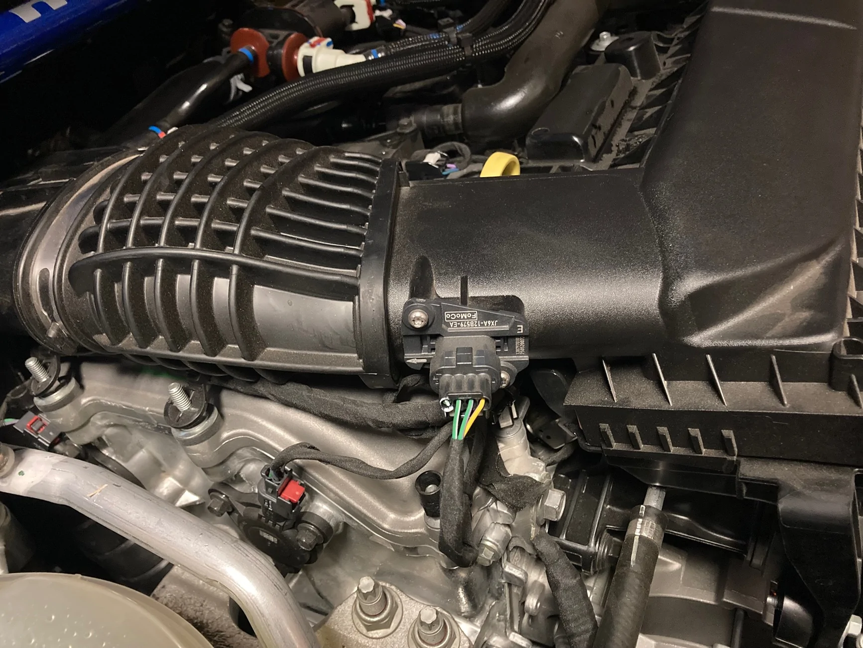

Not sure why AI thinks there is not a MAF in a Maverick? I’m looking at mine now (25 Lobo). Printed Manual recommends removing it when replacing air filter. I’ll clean mine either MAF cleaner when appropriate…
