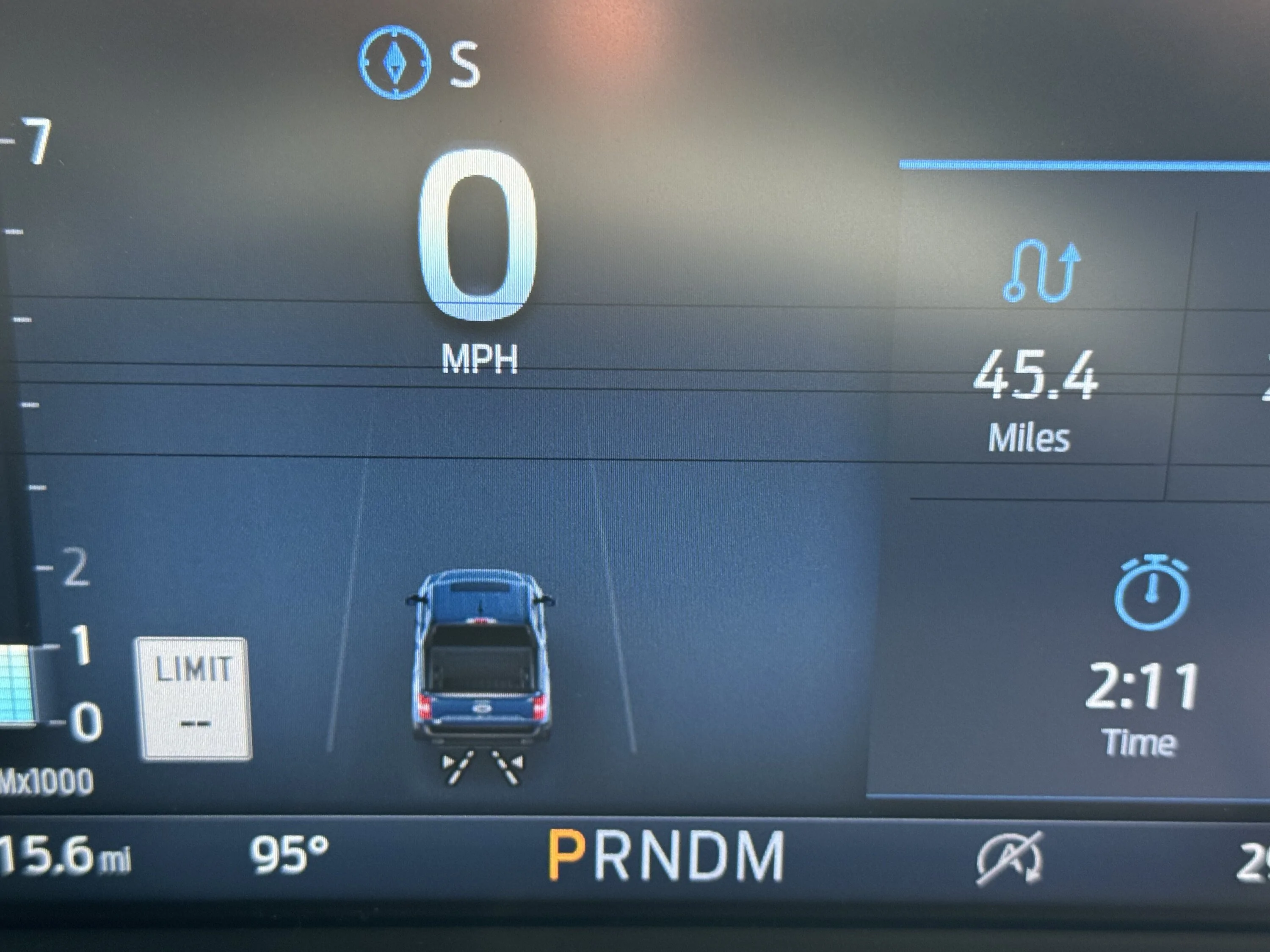

Did a quick Google search and not much turned up.
Just bought it on Friday and went out today to start it and saw this.
Did a KOKO to no avail. May try a battery pull later, but my suspicions are this is a hardware issue.
Anyone else run into this?

certainly doesn't look right, if disconnecting the battery doesn't resolve it I would assume a visit to your dealer is in order for a replacement :crying:.

Yeap. Have an appt first thing in the AM. Probably going to need to order an LCD or controller or something.
Sucks. But poop happens and it's under warranty.

Are you talking about the lines on the Left and Right of the Maverick? If so those are lane keep assist IIRC. If You drive it and get close to the center or edge lines do You feel like a little vibration in the steering wheel? If so that's what it is push the button at the end of turn signal stalk to turn it off. I turned mine off i hated it.

No. The black lines going horizontally through the screen.

The ones running horizontal from side-to-side do look like a screen trace is out. However, the short vertical, and short horizontal, on the right side don’t seem to be a trace. At least I haven’t seen a LCD trace that was partial. But one would also think that today’s software wouldn’t leave a ghost image either. So most likely the LCD is bad.
