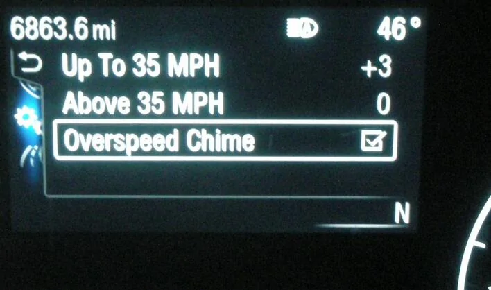

Made me think of the traffic sign recognition post where Chimes Menu could be enabled.
Feb 7, 2022
#41 https://www.mavericktruckclub.com/f...orscan-mod-confirmed-working.9399/post-202095
Audible warning enabled when you go over the posted speed or set threshold.
Main post will be updated accordingly.
In the OP'S first post.
They stated, that the chime was happening before they enabled the sign recognition and after they disable it.
Yep, I checked that. I did not have TSR enabled at the time however DID enable it, then made sure that box was not checked.
I'm resetting my Forscan data using As Built stuff now and will see if it does it then.
